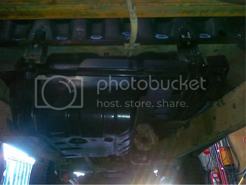

Would a 75-79 series tank not fit ?
Not sure how a 79 or 75 series tank would fit in my 80 series frame. And I bet the cost of a new one, used are not common in the US, would probably be more than a custom built tank built to fit the rear of the truck. Man-A-Fre sells a 24 gallon tank for $1700.00 dollars, but again, I bet I can have a custom aluminium tank built cheaper than that. And the custom tank would use the OEM 80's sender, pump, vent, etc... And I could have the filler neck on the tank put anywhere I need it to match up to the rear passenger's side gas filler on the bed.
Clint..that link is broken or it doesn't go to the right page...I would like to see how the made this work b/c on my 80 frame its too tight.
I can tell you that the 75 won't work on the 80 frame and 79 cab. Its close but no cigar. I think it will work with a body lift but it won't fit between the cab an frame rail. The dove tail in the frame doesn't help either. I'm not sure if I will end up using mine or not. It gonna take a good bit of work to get it to fit.
Bfk the owner said the tank corners needed some love to fit between the rails
The back cab mounts have been used just Redrilled so the cab should be the same height as yours
If I have to buy a tank, say a 75/79 series tank, then I would prefer to buy a custom made tank for the rear of the truck. I would bet finding a 75/79 series tank here in the US wouldn't be all that easy nor cheap, especially if we are talking possibly ordering a new tank. The custom tank would be aluminium and brand new. Just my opinion, but "making" something fit sometimes isn't worth it to save a few dollars if it isn't 100% correct. I'd rather spend the money and do it right.
If your going custom , i would still be getting it made under the cab and I guess to get maximum fuel cap you would go with a very similar style to the factory tank.
I would leave the rear end of the chassis for the spare tyre
The spare will go in the bed up against the headache rack where I believe the stock 79 series spare is located. The tank in the back will be much easier to design and will be much like the aux tanks sold for the 80 series. I am not looking for 60 plus gallons of fuel capacity as this will not be an overland expedition type of truck. I will be happy if the tank holds 25 to 30 gallons.
