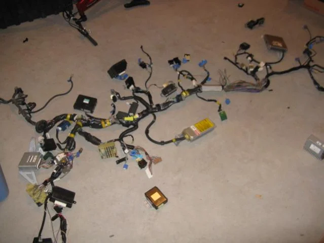

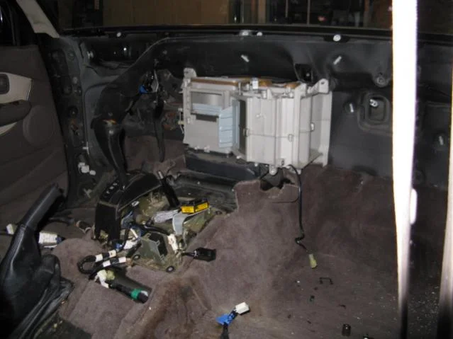

Well, I took the plunge today and started stripping the donor 80. I got the entire front clip off, and the dash and wiring harness removed. Worked for about 8 hours on it. The main harness under the dash is a project and a half. I also spent some time ridding the harness of some of the electronics I won't need on the 79
Feel free to stop in if your in the area.
Ok, so the 1996 actually has a cruiser control ECU, it was near the steering column behind the dash. Basically as long as you take the whole harness and all of the relays, boxes and ECM's you should be fine with the cruiser control working. The Transmission EMC is part of the Engine ECM, but the cruise control has its own ecm that links into the Engine EMC it gets info from the EMC like speed sensor, RPM's, Transmission information as well. If you run into any trouble I have a wiring manual for a 1996 so I can look stuff up for you if you need.

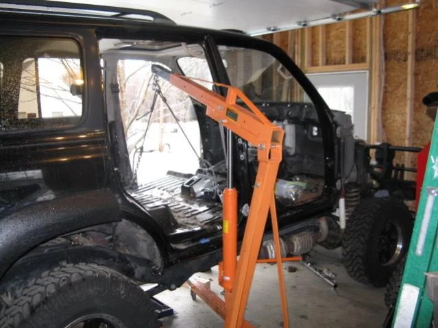

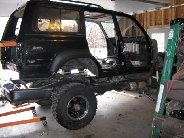

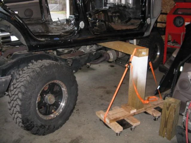

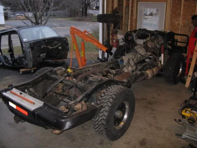

Spent the day today removing the 80's body from the frame. Let it be known that ONE person working alone can remove an 80's body with nothing more than a 1 Ton engine hoist, some cribbing and lots of time, Though having access to a forklift would have made it much easier..

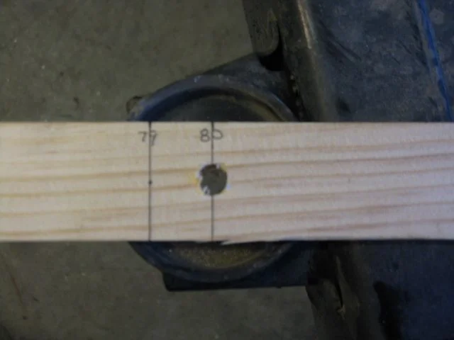

Picture of the frame without the body and one showing a template I made with the width of the 80's cab mount and the 79 series cab mount.

I'm glad you are going to try a short bed on the stock frame. That is exactly what I have in mind. I'm going to lose the 79 frame and axles and just dump the cab on an FZJ80 for now. (diesel swap later) I'm going to build a custom dump bed and I'm hoping it will be at least 5'6" without having too poor of a departure angle.
Thanks for pioneering this. There are a bunch of us watching.:hhmm:

I'm looking forward to getting the front body mounted so I can mock up some body mounts. I may even go with a 1" body lift depending on how the 79 cab sits on the 80's frame.
The cab won't be mounted permanently as while I have the body off and lots of room around the engine I'm going to change the head gasket and all the seals, front and rear main included, gaskets, belts and hoses, including the PHH that haunts us 80's guys.

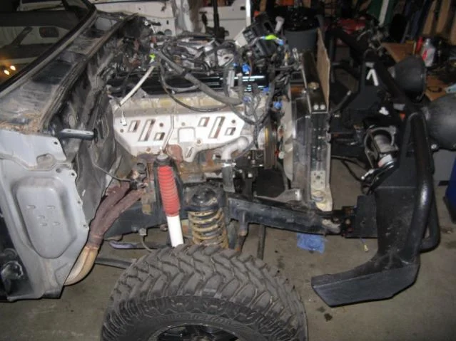

just a heads up...your gonna have to cut the inner fenders to clear the shock towers. Its not hard but it requires some time if you want it to look good.
you've got the easy part done...now the fun begins
Thanks for the inner fender advice. Sounds like I'll be buying an air saw. Any pictures of the modification?
Yeah, taking the body off alone with just and engine hoist was a lesson in patience. It is now sitting in my driveway waiting to go off to the scrap yard.

no pics of the shock towers on my computer...i'll try to get some next time I'm near the truck. You will have to cut a notch out for the steering box also. I used a jig saw with a metal blade and it work good for me. I would have used the plasma cutter if the truck was a beater.
the lift sure does make it easy...the backhoe is more fun though. if you guys aren't saving the bodies why not just hook a strap to it an pull it off with another truck?
