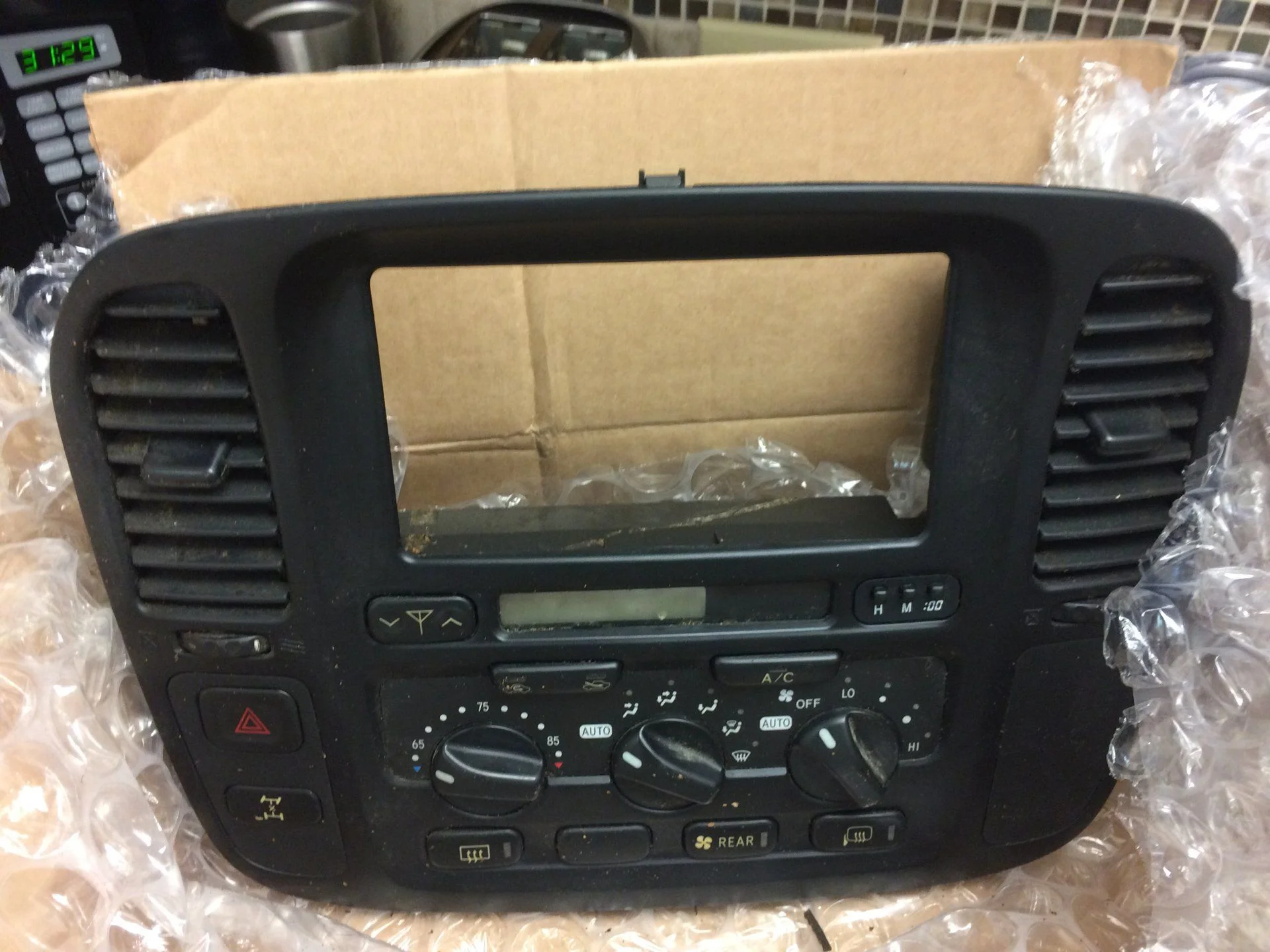

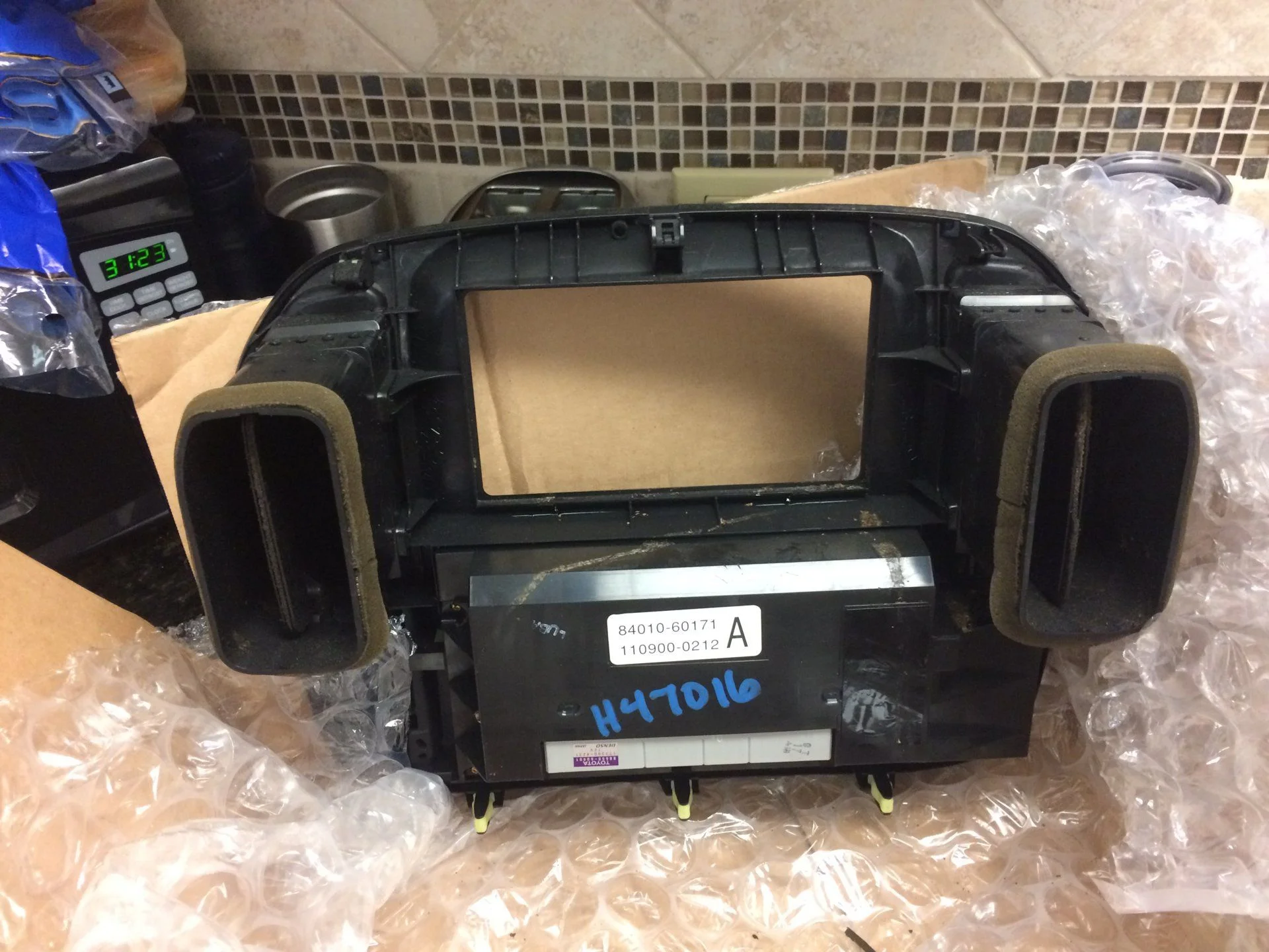

If you decide to swap to a 3 dial here is what I purchased. You can see the part number on the rear. The problem I found was Toyota only sells the individual pieces such as the amplifier, knobs and buttons instead of them complete piece you see here.
