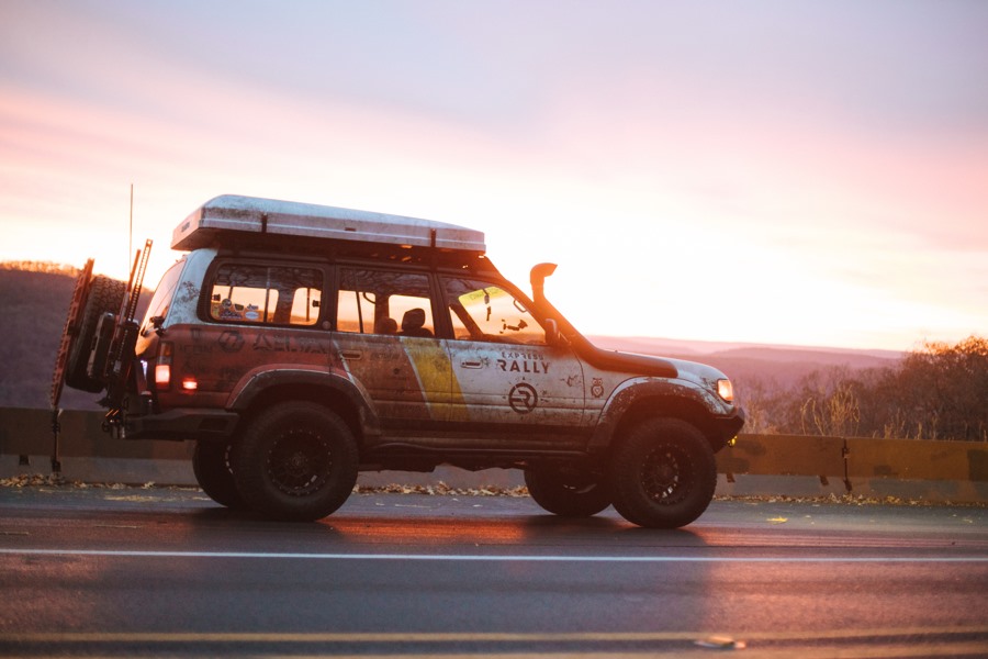

A few photos from just after I purchased the 80 in 2017 and completed some very basic maintenance and upgraded the suspension to Icon Vehicle Dynamics. At this point the 80 was running, but not running well and was used sporadically as it was not a top priority.
In January of 2019 we did a brief photoshoot showing the Icon Vehicle Dynamics suspension - little did I know this was just two days before our twin daughters would be born! At this point some of the more serious mechanical issues were becoming known and I knew the 80 would need a significant amount of work.

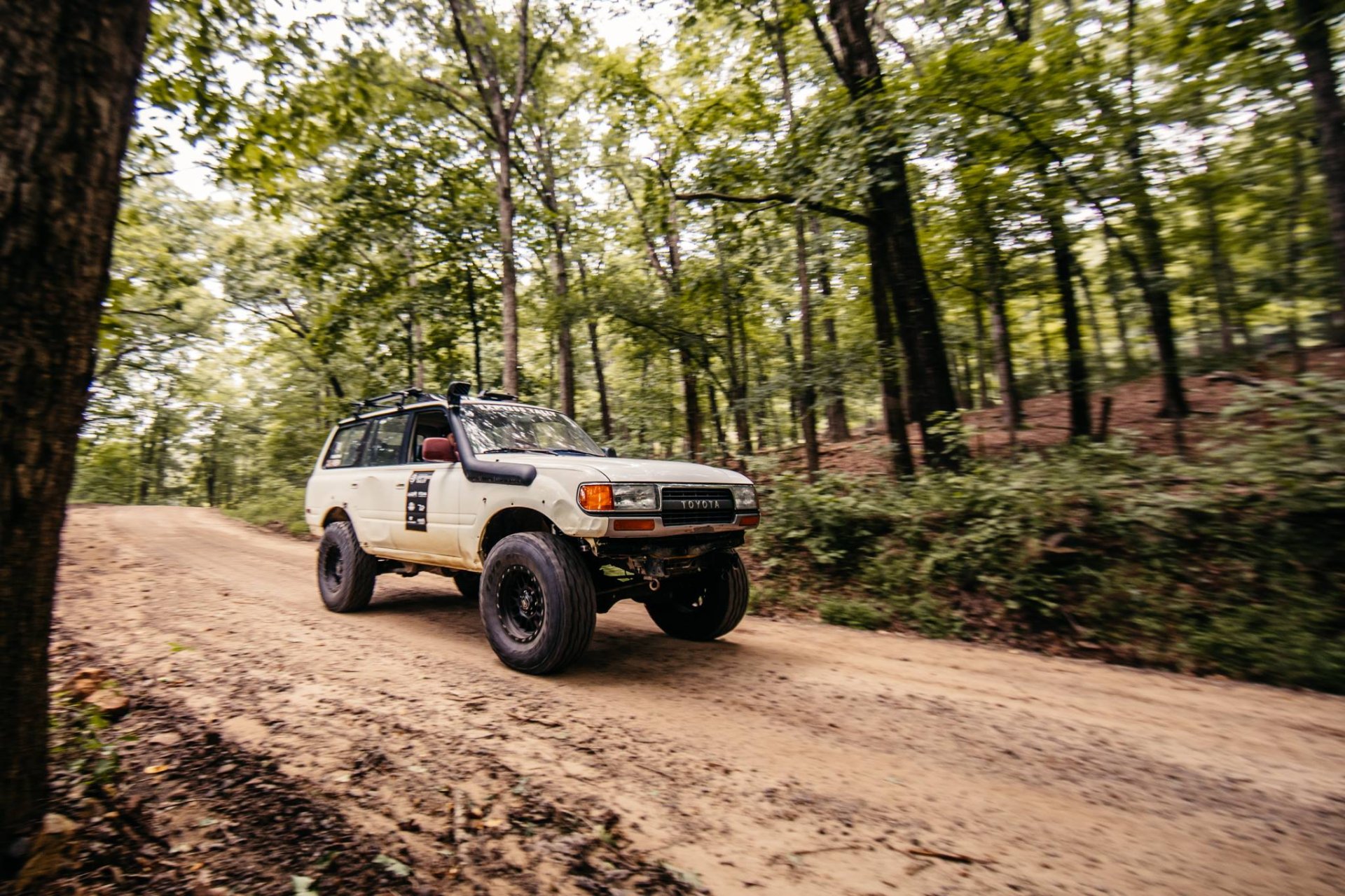

After a summer spent getting the 3FE running better and beginning the build, I was able to actually use the 80 for the first time on the promotional shoot for our Express Rally Overland events in the Ozarks. The 80 made it through the trip in October but as a result I knew the original motors days were numbered. After this event I decided to touch base with Jason Harris at Ozark Overland Outfitters and come up with a game plan for the build. I will continue the build story below - some of the comments are a bit out of chronological order as I have been editing posts to make things flow a bit better.
