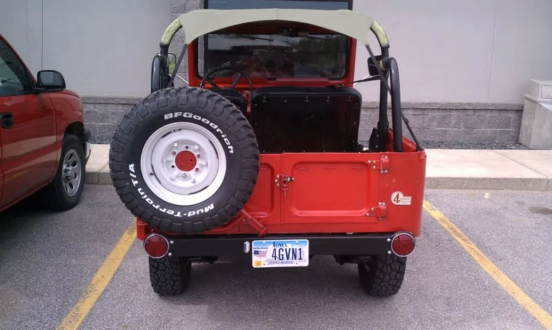

Only thing I would suggest is to swap the taillights from left to right etc... "flipping them" in the process.
That way they flow with the natural body lines...

Are those OEM tail lights? For some reason, they don't look exactly right to me. Maybe it's the smooth custom bumper, or missing bumperettes? Also, where is your back-up lamp?

Hey Greek and Arc I mock up everything before I actually run a bolt through it or add a weld to it. I looked at the OEM Toyota rear lamps both ways and I prefer the look this way.

I think the tail light brackets are upside down, or on the wrong side. They should hang below the bumper, not above.
They should? Everything I have done to the build on this truck is intentional. Many hours mocking things up to see if it looks right to me. I like the look of the bottom of the lamps up. My preference only. If this were a factory $30-40k correct frame off restoration build then I would stand corrected. However I am building it my way. Like many members on here we research for many hours before we touch a wrench. I do the same thing. When its time to actually drill a hole or weld something up there is great care with everything done to this truck. So if something seems out of place or non-factory it was intentionally set that way.
When I eventually get around to selling this rig the things that I prefer can be easily changed back to factory. I made a couple comments earlier in this build thread that state I will build it the way I want. Many guys comment on the bezel and black tires out. I like the bezel correct but I like to show off my tires too. So with the tail lights. I like them that way.
Anyway cheers and no worries. If I didn't have hundreds of hours and thousands of dollars in hard earned cash in this truck then you wouldn't get the little rant.

Looks great, and doing it the way you want it is what makes each cruiser unique, (which is saying a lot from a purist :hillbilly:) that said, the biggest issue I see is your rear plate...that thing will eventually get hooked up, and bent badly where you have it now, so this is the only thing I would encourage you to change...the rest is up to you.

It all looks awesome. I hadnt read thru entire thread yet, but was just wondering why it looked a bit "different" to me. When I saw Greek's post, I was like, "yup, that's it.." Still looks great, but I thought it was just the smooth custom bumper that was throwing my eye off..
Believe me, mine is no purist rig and highly customized!!
I've been looking at those early year tail lights at SOR and CCOT. I'm going to revert back to a more 1971 stock look for the rear, and get rid of the Jeep truck lights and the custom bumper. I like what you did with yours!! Thx
You can get those stock rear tail lights from Toyota still for $35/piece. Just saying. Uh hem, nice but heep tail lights...your build...lol. Cruiser looks good.
Yeah, i inherited the Heep lights along with the "does-this-bumper-make-my-ass-look-fat" custom bumper (which is hella heavy-duty BTW..)
I've seen people say.. "you can get XYZ still from Toyota..".. but exactly how? Just go to any dealership Parts counter? I know.. dumb question, right?
Actually, I have a friend who is a service dept exec with Toyota HQ in Torrance... maybe he could hook me up. I also am considering going back to OEM bumperettes, but add a custom narrow bumper-spare tire carrier (2"x2" square tubing). Ok.. thanks for the tip.. I'm going to look into it. -J

Yes absolutely you can go right in. I'll save the parts counter guy some time for ya!!! Oh and you don't need a hook up they are fairly priced and usually I can get them in 3-4 business days. :cheers: n :beer:'s.
Lamp Assy, Rear Combination RH Red 81550-60130
I ordered the same lamp in a qty of two. I can't remember if they are 'handed' or not. I don't think they are.
oh man.. you guys are SO awesome. Thanks for the part number!
I'm going to check that out. But riddle me this...
My rig is a 1971, but the frame, I believe.. is a 1966. As you probably know, the 1966 uses a smaller tail light.. so should I presume that the BRACKET and tail light would have to be 1966? Not a huge deal, but I'd like to go with the slightly larger 1971-correct tail light. I could also probably fab up a bracket.. perhaps.
