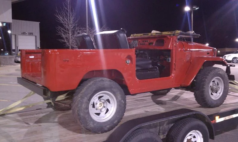

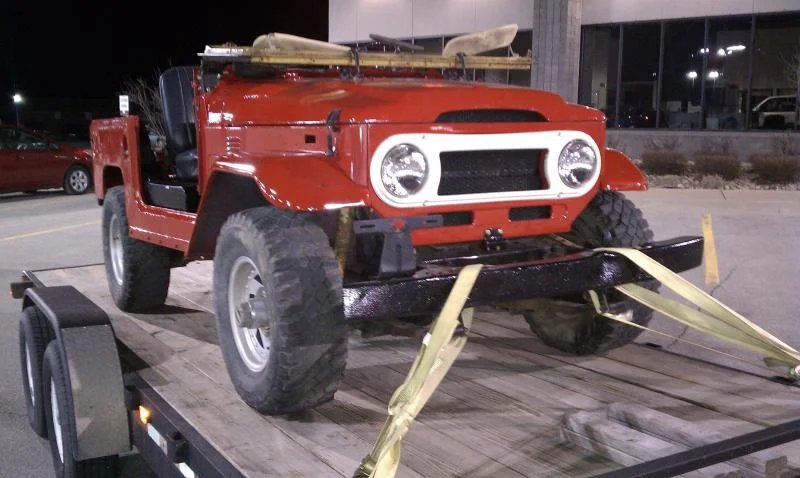

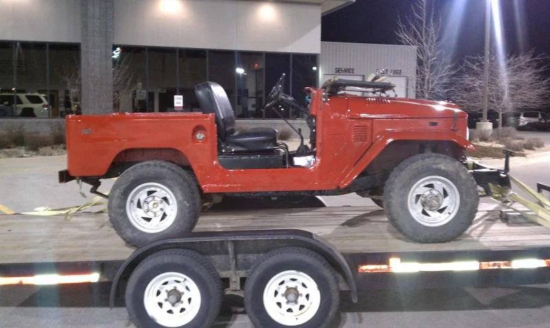

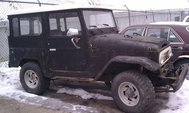

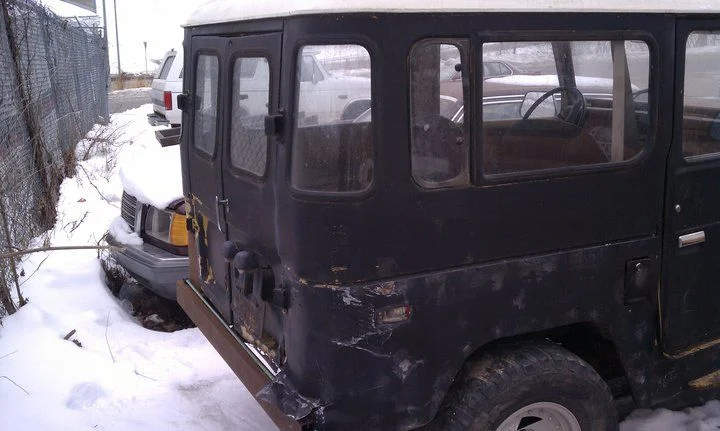

Jan 15, 2011 I picked up this 78 FJ40 complete with hard top, extra 72 tub in good condition and it ran really well. The PO bought it from his friend who owned the truck for 20 plus years and used it around his shop for errands and what not. He also used it to shovel his shop out and stored bags of salt (not a good idea in a 40, but welcome to Iowa) and it literally rotted the rear floor out.
A couple of pics of when I bought it and then it sitting safely in the barn.

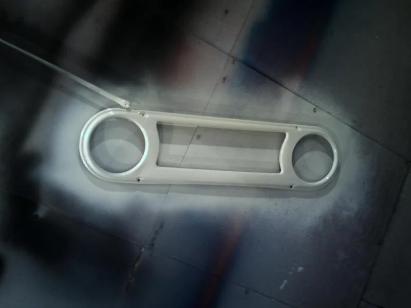

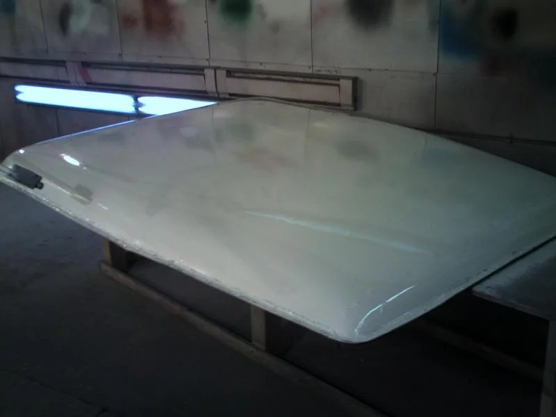

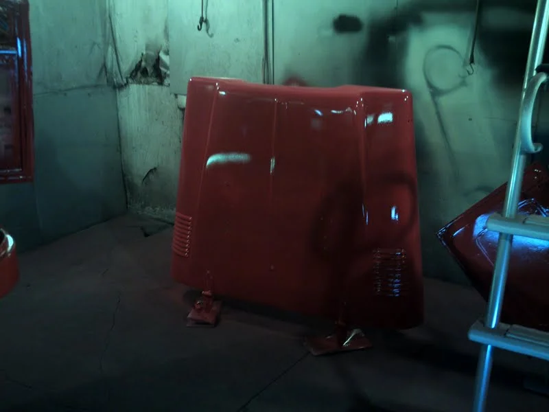

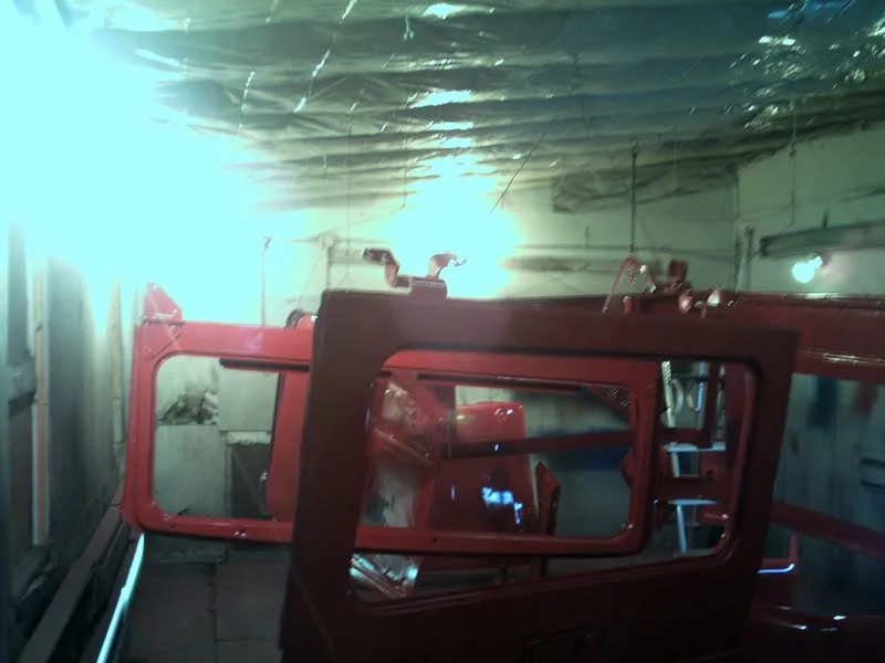

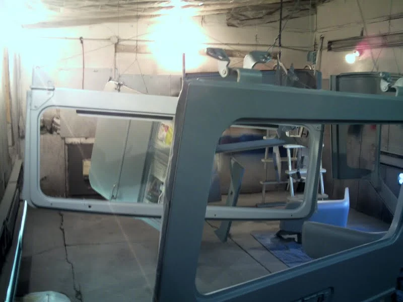

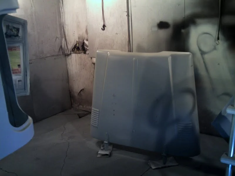

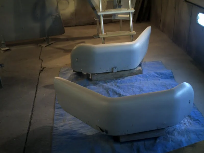

Gary (body man) sent me some pics of the pieces that are primed and getting painted today. The fenders were pretty chewed up and he has smoothed them out and everything is coming together beautifully.
I am picking up the hardtop, hardtop sides, rear swing out doors, rear flip up door, front doors, hood, bib, and headlight surround on Saturday. The truck and tub will be picked up in two more weeks.
Here are some pics of the primed pieces and hopefully later today I will have some pics of the painted pieces.
Monday, I will drop these parts off at the glass company so I can have all the glass put back in and this will be ready for assembly.

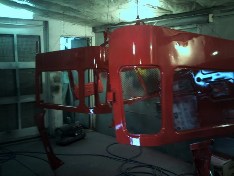

Here are the painted body parts

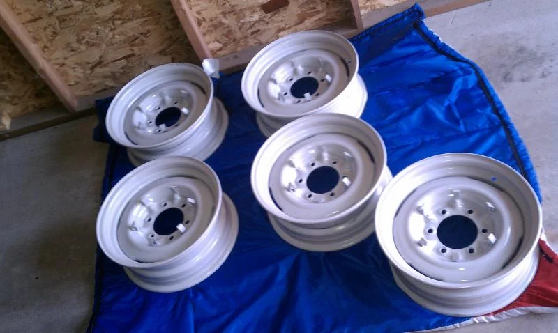

Bought 5 Factory Steelies from a MUD member in FL and dropped those off to be sand blasted and powdercoated.

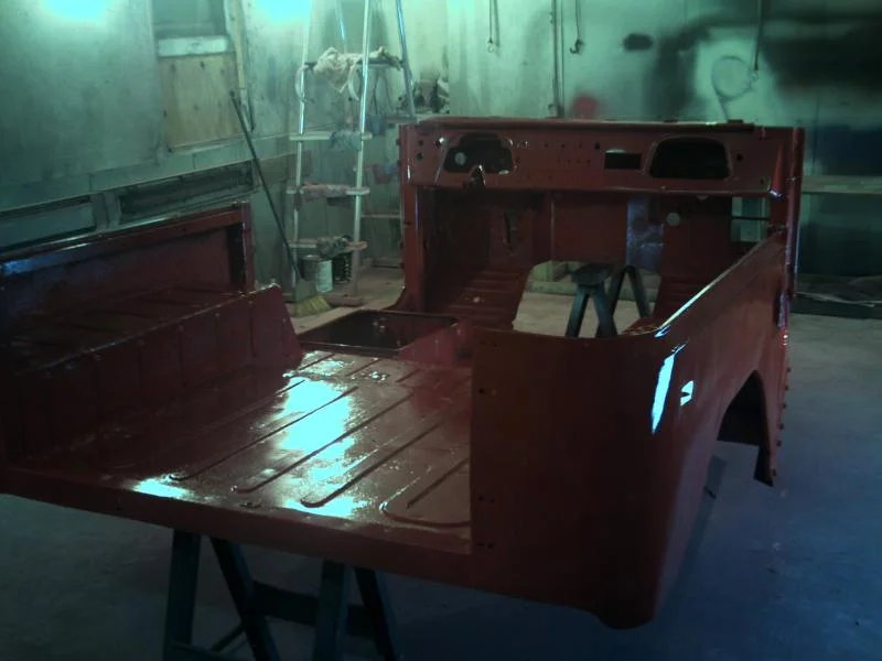

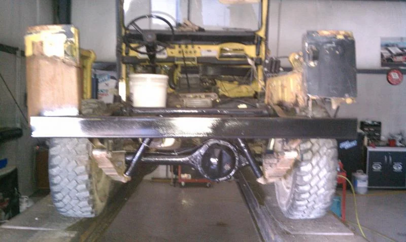

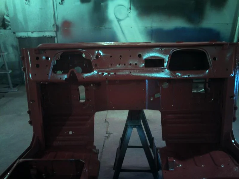

Tubs coming along. hope to get the bottom sprayed today. after it's all primed. and sealed. lots of work!! put the bottom angle iron on last night. the metal was actually stretched on the left so it wouldn't pull straight would have had to cut it and re-weld. Since the holes were all equidstant I bolted the iron on both sides and tacked it in places and used seam sealer. It looks great and should make your truck look tough. it also bolstered and strengthened the sides like you wouldn't believe. It flexed before. Not now!!! ...He went on to say that he'll have the underneath painted tonight and should have the tub ready to spray the interior tomorrow.
Pick up truck on Friday...more pics to come!!!

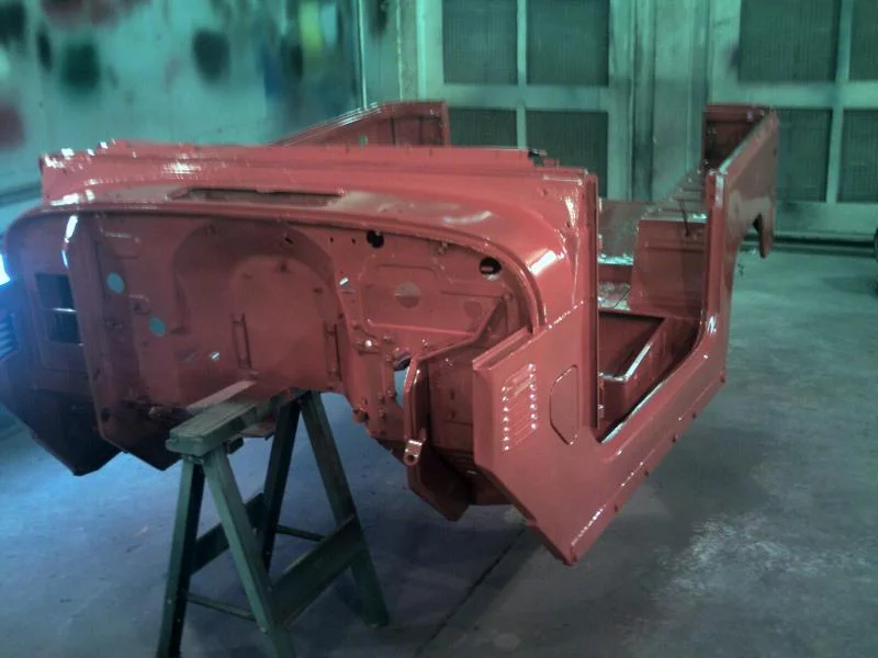

3-18-11:
Final Painted Tub pictures. Going to pick it up Saturday. Looking forward to seeing the color in the daylight. Will have more pics of tub on frame and build up pics coming soon after as well.

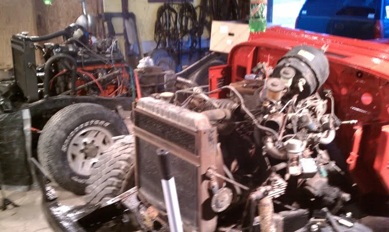

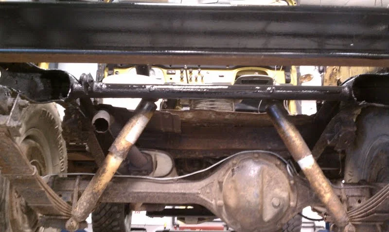

This past weekend I have been grinding and painting the frame with POR15.
Everyone says this stuff is nasty when you get it on your hands. They are right I'll be wearing this stuff for a while. However the fit and finish of this product are awesome.
I have a Brand New OEM gas tank from Toyota that I will paint with POR 15 so that it will last for many years after I have sold it and the next guy will be very happy that someone took the time to properly coat the tank.

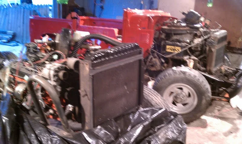

Talked to my buddy Mike who is a wiring expert/fabricator and he is helping me wire up the 40. The rolling chassis you see in his garage is another MUD members build.
4-3-11 :

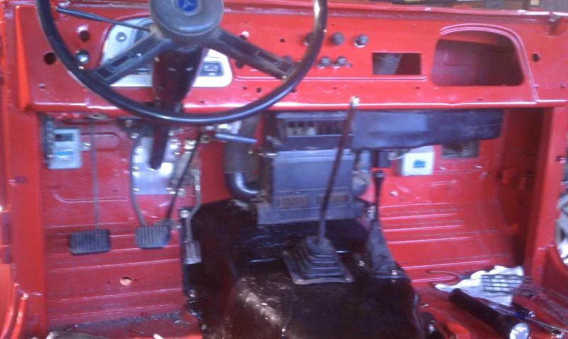

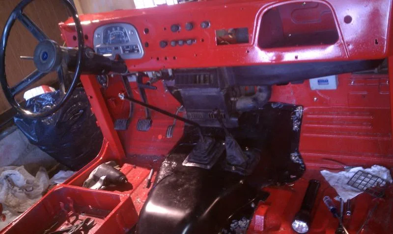

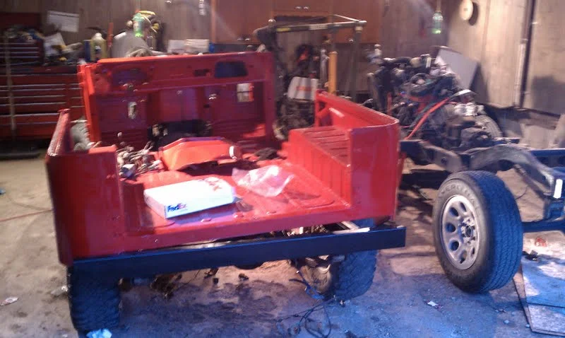

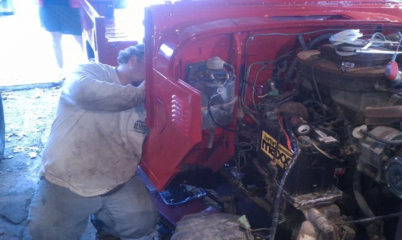

This weekend alot of progress has happened and the wiring is coming together beautifully.

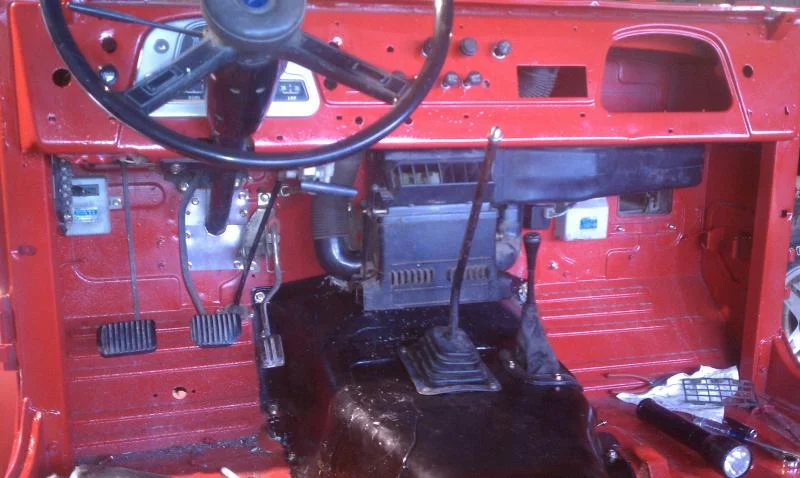

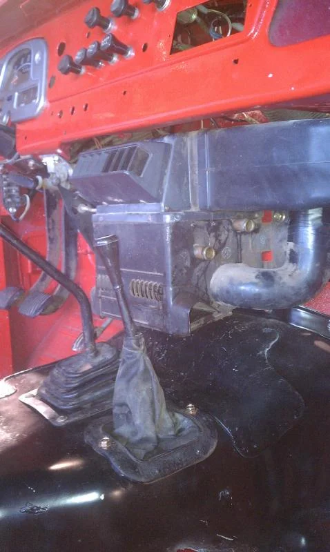

1) Firewall getting wired up and all parts reattached.
2) Had to cut the tranny hump to size since its a 72 tub on a 78 frame.
3) Gas Pedal brackets were entirely different so had to custom fabricate the gas pedal, the emergency brake bracket and the bracket that holds the steering wheel. All in all it looks great and works great as well.
I am using new JIS bolts to install most things back on the body and on the inside of the truck. The zinc bolts look great with the red and give everything that new truck look.

Powdercoater called me and he dropped of the freshly blasted and coated Steelies.
A few more pics.

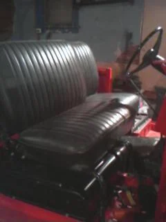

I pulled the factory seats out and put in my Green Bay Packers bench seat. The seats were in great shape and I got the seats from Smitty in Green Bay, WI (thanks Smitty).
The drivers seat has been moved back and is a great fit for me. Enjoy the pictures.

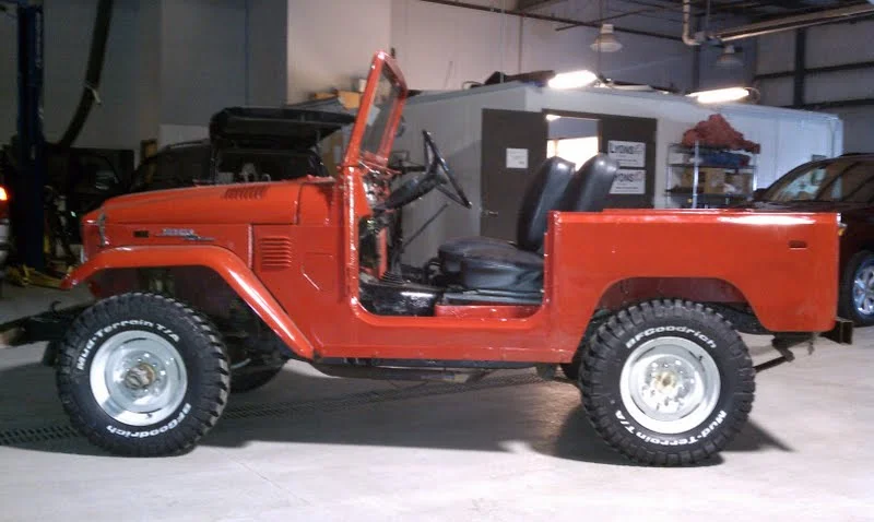

I picked up the 40 at Mike's place and the attention to detail in the wiring and fabricating is amazing. New zinc bolts sticking out all over the place. I need to apply weather stripping and bolt everything back together but I took her out for the first time tonight with my mechanic and it was pure joy.
I am going to be working hard at getting the front and rear turn signals all hooked up so I can drive this baby all around town. She's not perfect (rear quarters and a couple other issues) but we're on the downward slope at this point and I can still take her out and enjoy her this year.
Enjoy the pics they will keep coming as I get her assembled.
Some poser pics but what the heck still a cool shot
Another poser shot but doesn't she look awesome. Still excited about driving her around the block tonight. Whohoo!!!!

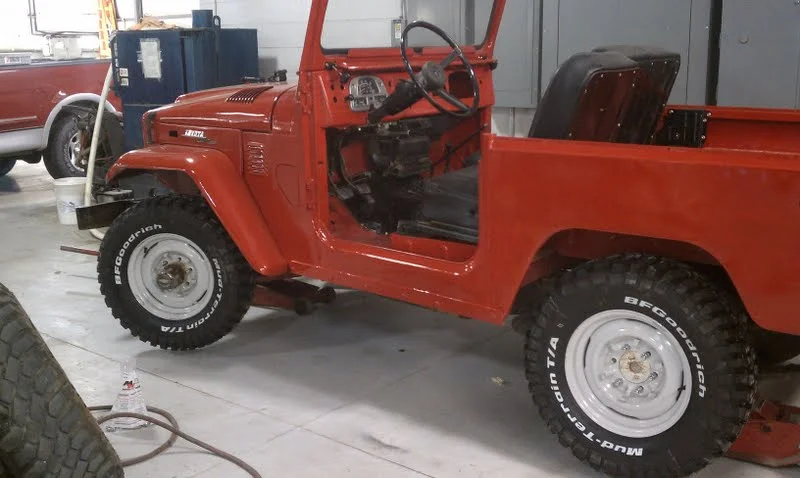

Tire Time...with much research and much yacking with other MUD members have finally decided on the right tires for this build.
With alot of research and price comparisons I went with the 235-75-15 Tall/Skinny BFG Mud Terrains
Got the wrong size nuts but will fix that Saturday.
Before you even say it I like white letter out. Some purist and bezel police disagree but then again this is my build.
