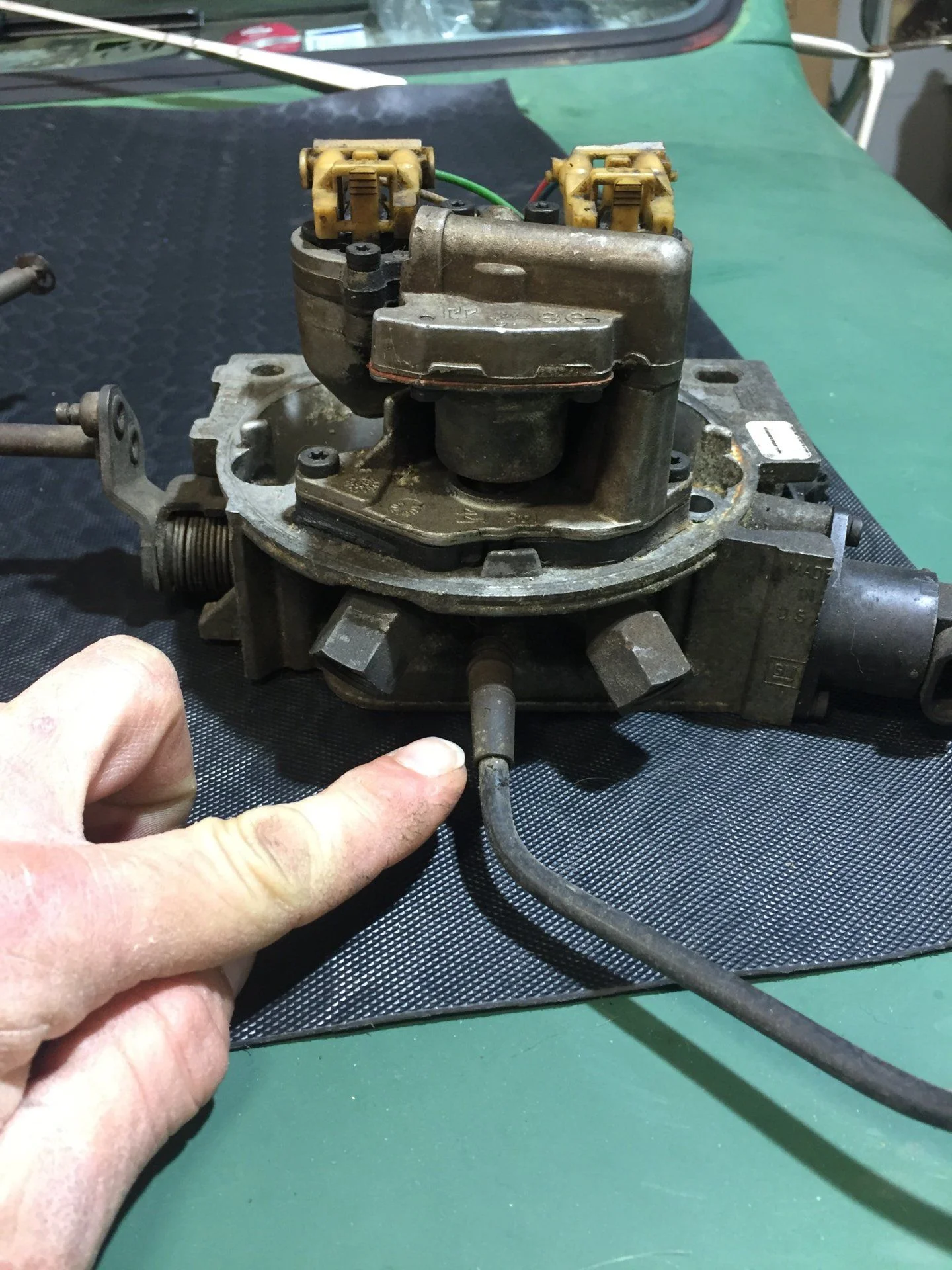

Where is the vacuum line to your map sensor connected? It goes on the back of the tbi between the inlet and return fuel fittings.
Pcv goes to the front.

Map goes here
Depending on the parts you receive you may have to have a few different hose sizes to go from the nipple on the map sensor to the port on the throttle body. I have seen the map sensor run to the pcv port on the front of the tbi many times, just because the hose fit the best there. It will not run right in that location.

I tried the MAP sensor first. Turns out it was ran exactly like you suspected. I disconnected and ran to the throttle body port and even with a loose connection, it fixed most of the issues I was having. I’ll reduce to a smaller size, see how it runs and then test the TPS wires. If we ever meet, I’ll owe you lunch. Thanks for the pointers.
