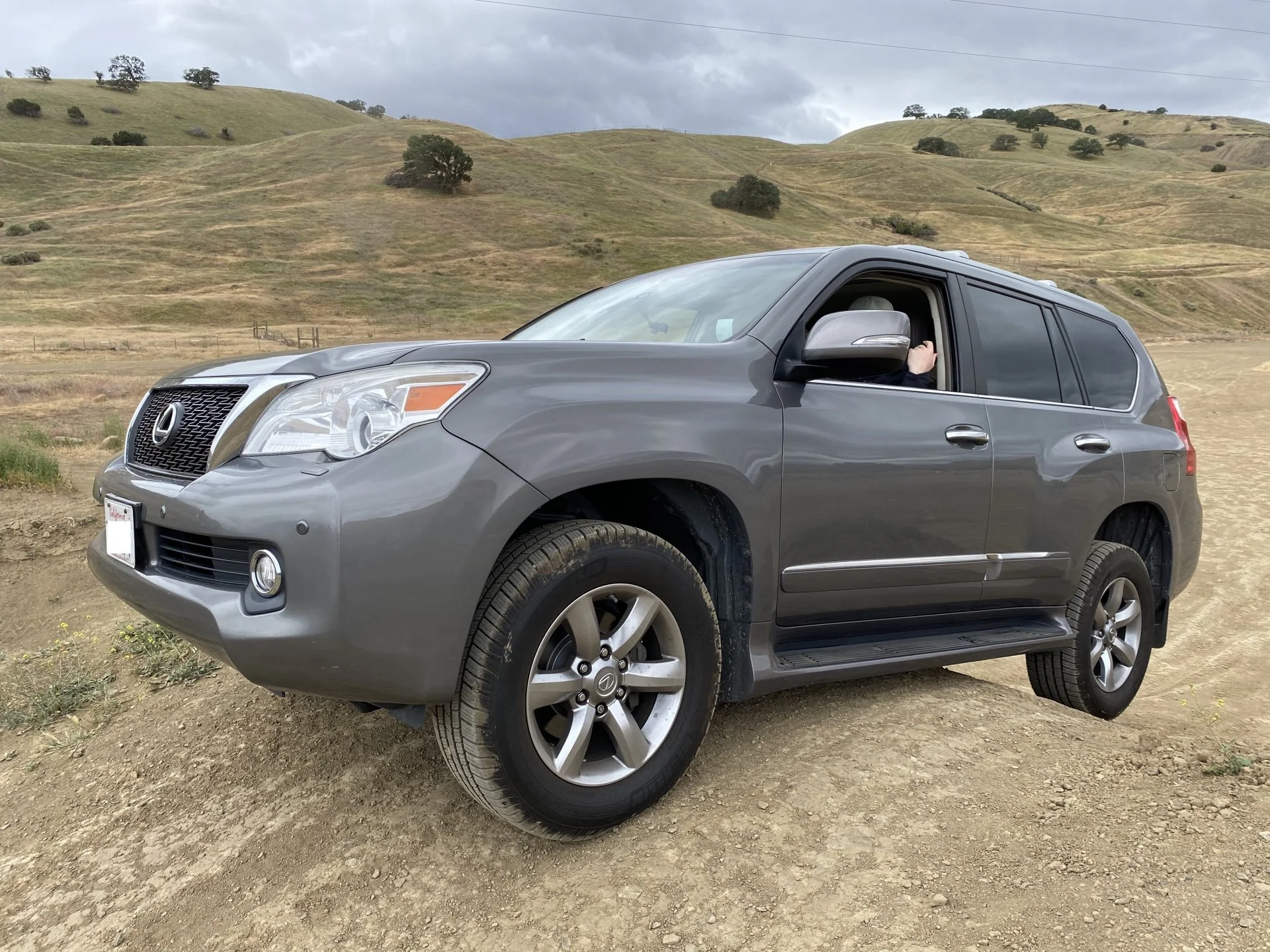

Howdy folks! Just picked up a '13 in Knight's Armor Pearl
Apr 26, 2021
1
2
San Francisco, CA
Glad to join the forums and have a few questions around my specific use case after lurking for quite some time.
Background:
Live in San Francisco (street parking) and previously drove a 2011 BMW X5. Loved the amenities of that car (heated steering wheel for Tahoe trips) and the general "get up and go" compared to other similarly sized SUVs, but got fed up with the xDrive after getting stuck on some ice during the freak snow storm up in Portland, OR this winter. Oh how I wish I could lock my diff!
As an Eagle Scout I'm keen to hike most places, but with a new 11-month old pup in our lives, the traditional National Parks are less appealing now. Additionally, my fiancé and I drove the X5 around the country this past fall (8 weeks to avoid the smoke season) and loved the ability to bring our dog (and his food) with us everywhere. She wasn't a fan of road trips previously, but the freedom of adventure in a vehicle is hard to pass up now.
Long story short, a friend with a TRD Pro recommended I look into getting a GX. Found an OK deal on a garage-kept and well maintained 2013 and bit the bullet a few weeks ago. Love the truck already and am looking forward to modifying it for future overlanding adventures. Another friend with a Rubicon is constantly badgering me about putting 35s on the GX... but I'm more of an overland/desert explorer type.
Given our proclivity to pack light (at least for the time being) and drive far, I have a few questions for y'all:
- What suspension/tire setup would you recommend for our use case? Leaning towards BP-51s and 33s...
- Extra fuel capacity? Prado 150s have an optional reservoir but a tire rack on the back could equally hold some canisters (may affect suspension question with a modified bumper)
- What else am I not considering?
Oh and I've attached a picture of the new ride and first modification: the F sport grille.
tl;dr - Almost bought a Bison, but the large community around the GX convinced me otherwise. Now stuck with information overload and wondering what I'm missing...
