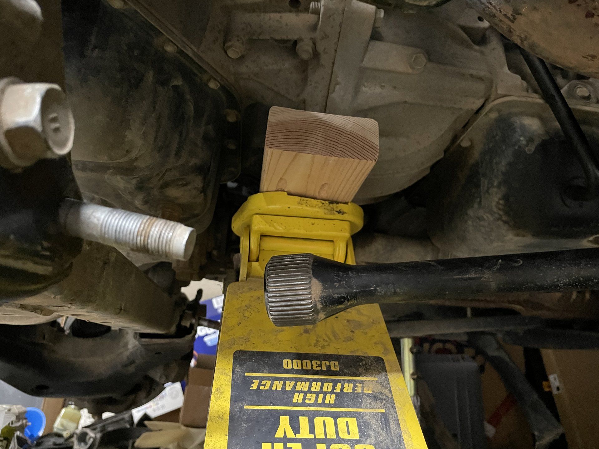

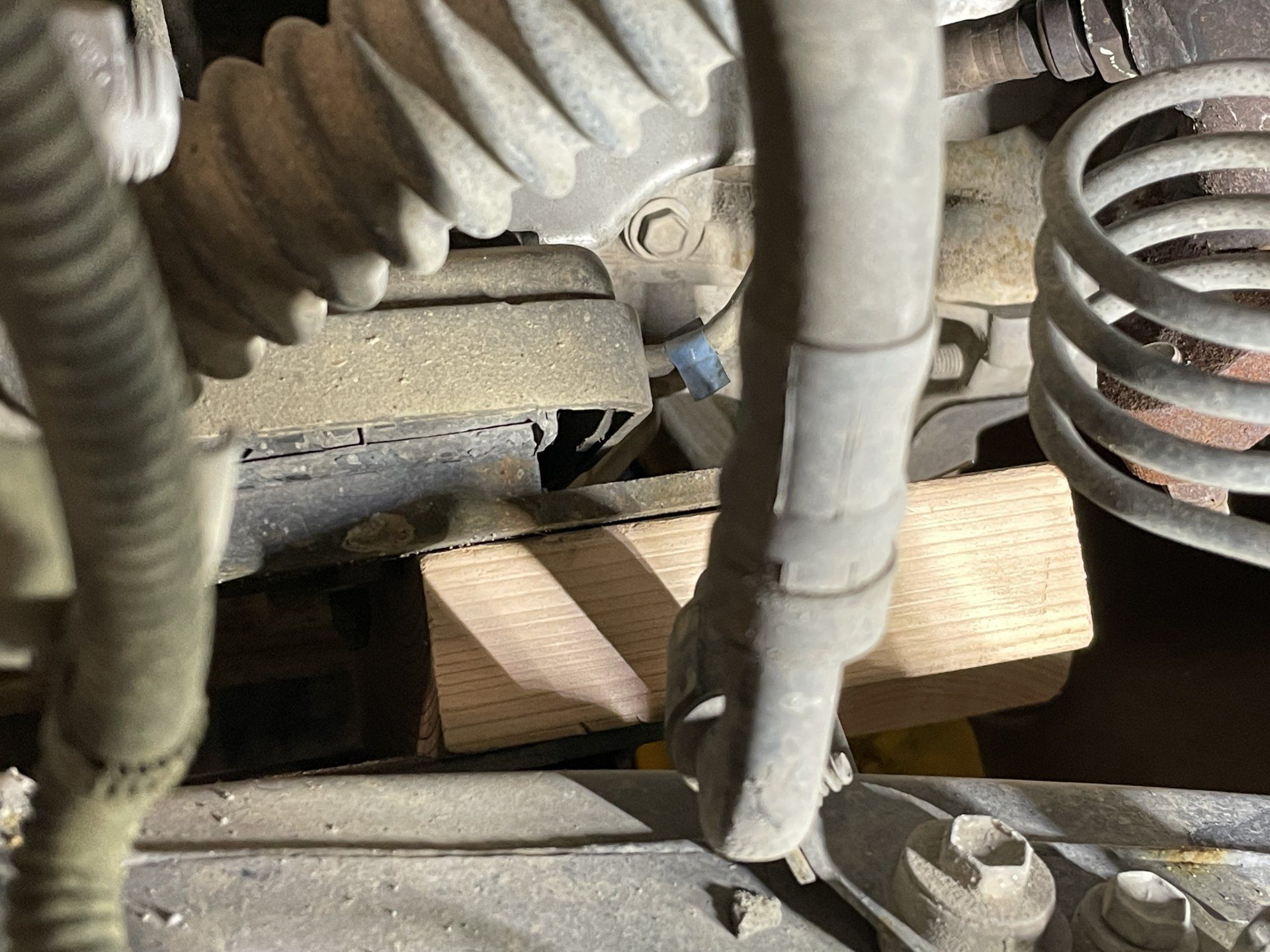

For lifting the engine, I centered my floor jack, with a piece of wood, on the bell housing to lift. Since the passenger side it still bolted down, the engine tilts as it lifts. First time I had plenty of fun and concerning creaking sounds which I ultimately attributed to the exhaust system flexing and pinging. No damage was done.
Below, jack lifting engine
Below, small 2x4 wedged into driver side engine mount as seen through front driver's wheel well
One other comment about having the engine in this position. It gives significantly more access to the oil dip stick access point into the pan. I replace the o-ring before I lifted the engine but wish I had waited until it was up, would have saved me 20 minutes of fiddling.

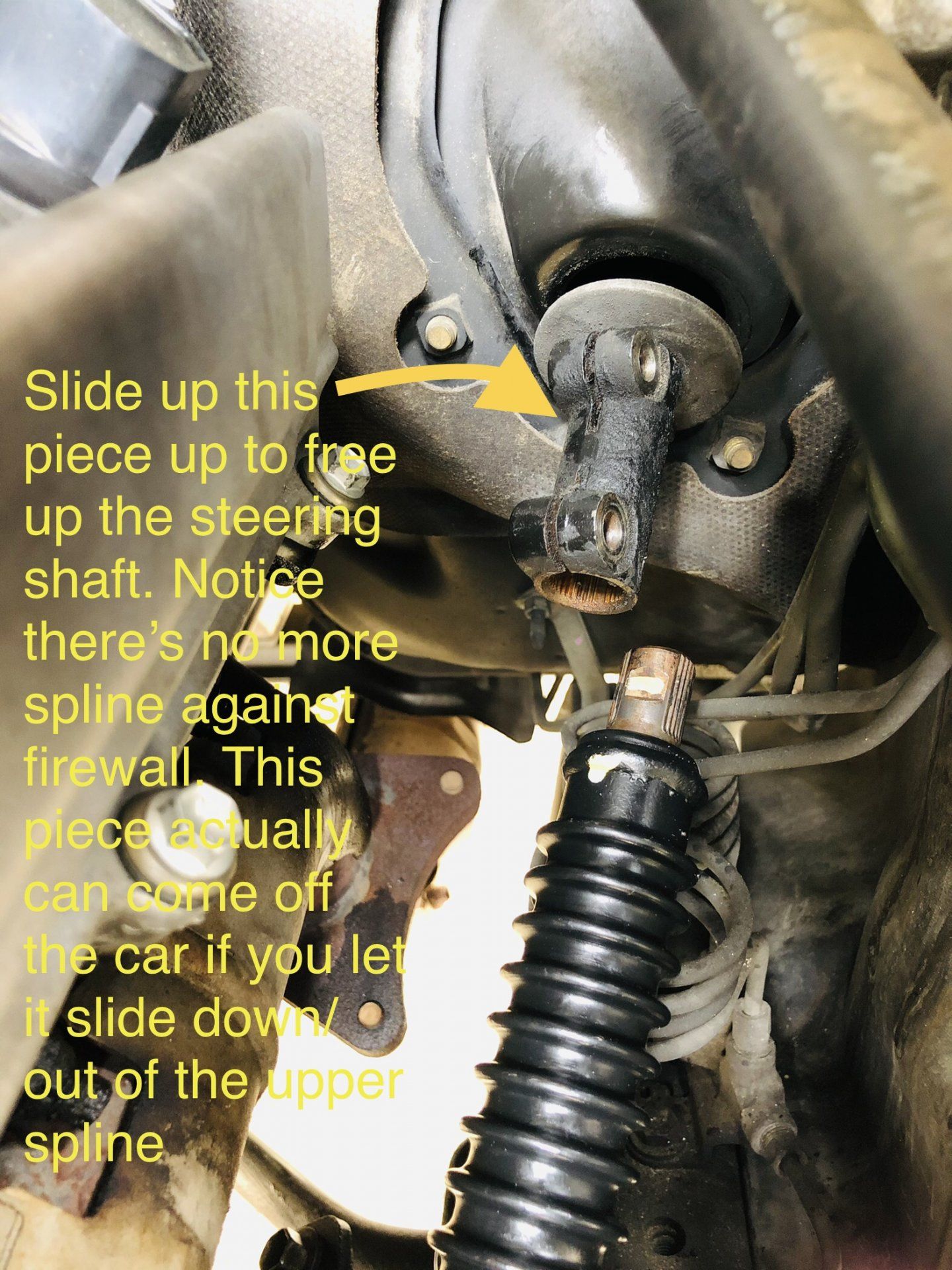

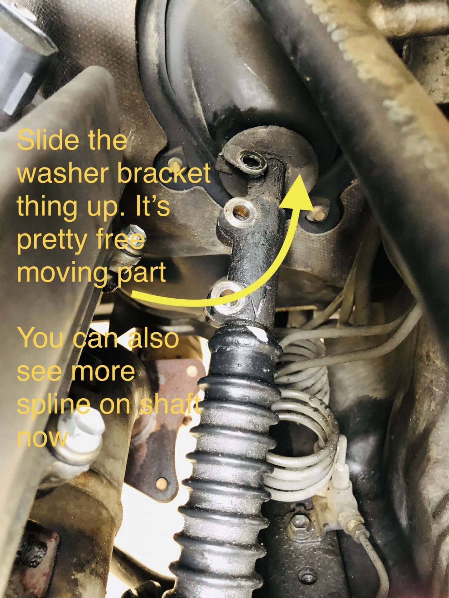

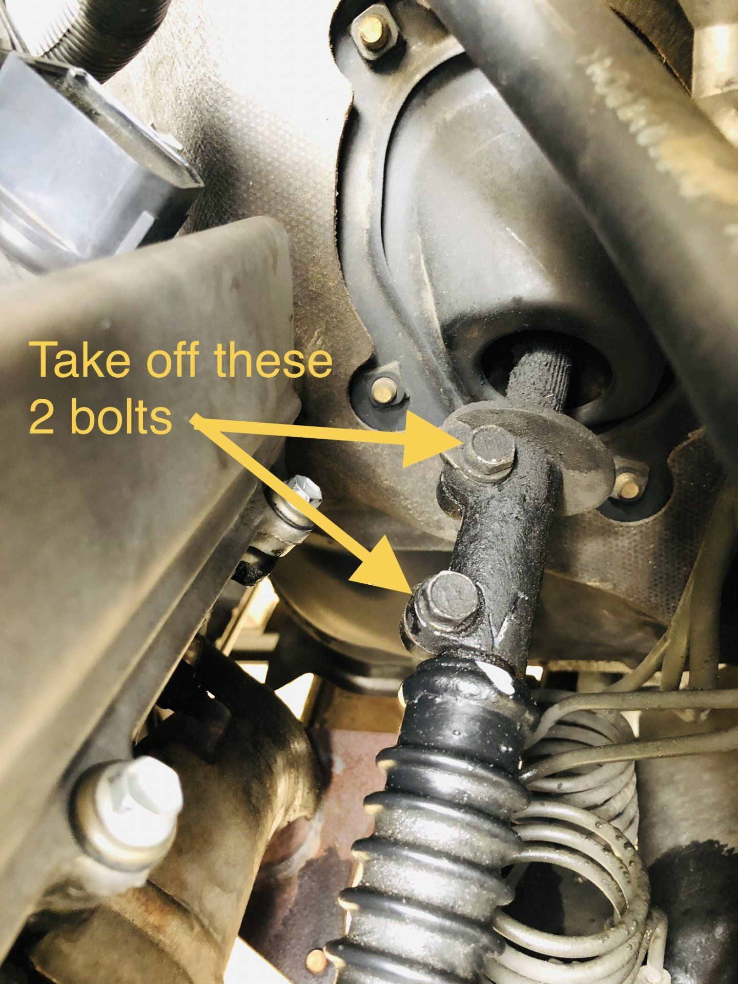

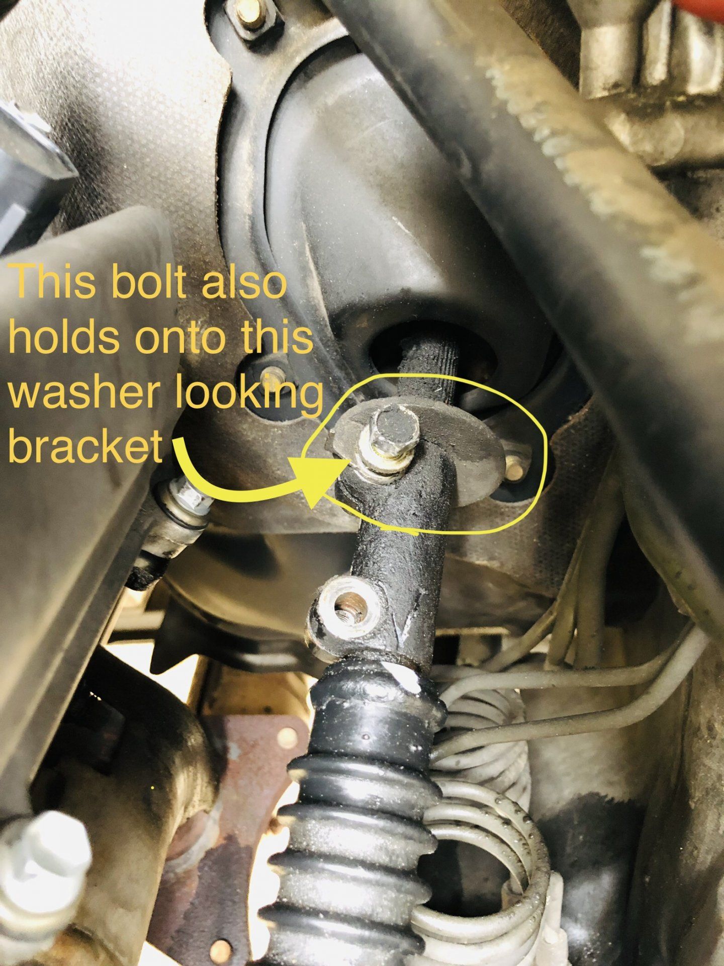

In regards to steering wheel not being centered. I did this too. I thought I had it centered when installing but after tightening up everything and went for a test drive, my steering wheel was at 10am stance when straight and with equal amount of turns to each way. Couldn’t live with this before heading over to a alignment shop. So, took the advice of loosing the two bolts on upper shaft near fire wall and this worked great for me. Maybe 1 hour of work to make adjustments and this is me taking it slow. I’m sure others are faster. Didn’t really understand this before getting into it so I took some pics.
Before I started, I jacked up the front wheels so I can move the steering wheel easier to turn and access the bolts. After accessing, I lowered the car and ensure the steering wheel was true straight (equal amount of turns).
1) take off bolt from steering rack and lower shaft (no pics cause you get this part)
2a) take off these two bolts
2b) notice this washer bracket thing (not sure what the name is but this becomes loose and slides up and down the spline)View attachment 2631142
3) Push up the washer bracket
4) Push up this piece up the spline. This will free up the steering shaft to pull out of the steering rack.
couple things to mention. My LC is a southern car so no rust and my splines and joints had grease already in it. So, sliding these parts were easy. I didn’t have to loosen the rack or anything else. I just unscrewed 3 bolts from the shaft, pulled it out of the steering rack, repositioned it to make it true center. Just had to repositioned it couple times. I was dreading this and it was easier than I thought.
Now I think of it, I would have done this part from the beginning when replacing the rack because I couldn’t get the shaft off the original rack due to no spacing to pull it and had to muster it a lot.
hope this helps as this thread has helped me tremendously.

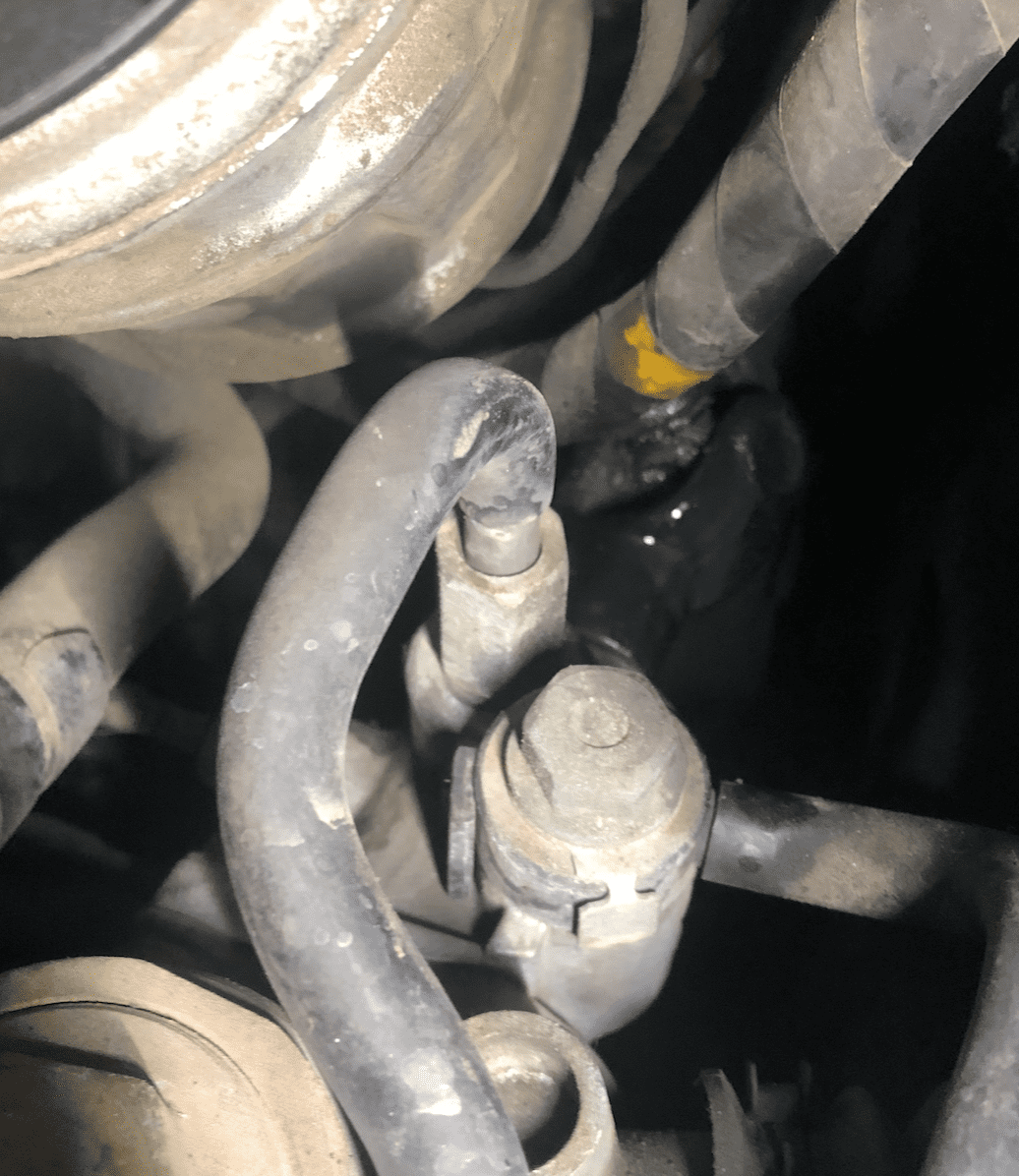

does these bolts need torque? or just make sure it hand tight enough when install back?

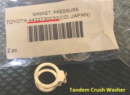

Is there any O ring in these two connectors?
No, but one has a double 'crush washer' that should be replaced (don't reuse the old one).

Did you reuse the return line when you replace your rack? So basically, if it comes off easily then I don't need to replace the return line, right? Mine is a California car, should come off very easily...

Yes Sir.
I was able to reuse mine. I didn't have any leaks in either of the lines. I had a replacement on hand just in case I buggered it up, but had no need to use it. My vehicle is a Texas truck for all its life....so rust free and removing fasteners or dealing with connections is not a problem. Yours should be similar.
