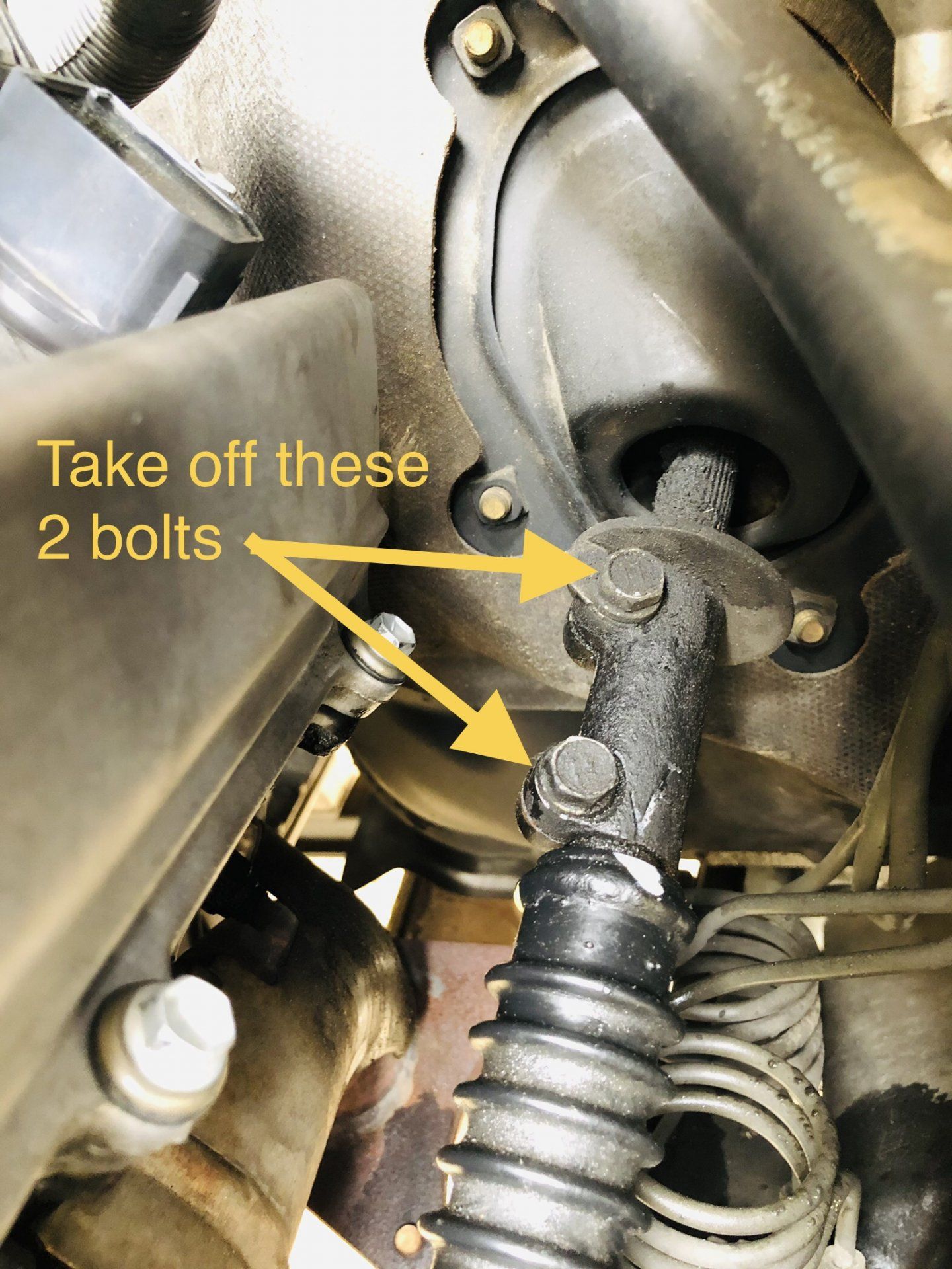

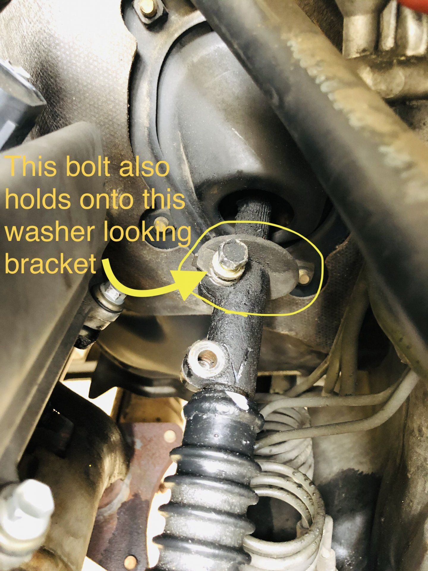

1) take off bolt from steering rack and lower shaft (no pics cause you get this part)
2a) take off these two bolts
2b) notice this washer bracket thing (not sure what the name is but this becomes loose and slides up and down the spline)
3) Push up the washer bracket
4) Push up this piece up the spline. This will free up the steering shaft to pull out of the steering rack.
2b) notice this washer bracket thing (not sure what the name is but this becomes loose and slides up and down the spline)View attachment 2631142
couple things to mention. My LC is a southern car so no rust and my splines and joints had grease already in it. So, sliding these parts were easy. I didn’t have to loosen the rack or anything else. I just unscrewed 3 bolts from the shaft, pulled it out of the steering rack, repositioned it to make it true center. Just had to repositioned it couple times. I was dreading this and it was easier than I thought.
Now I think of it, I would have done this part from the beginning when replacing the rack because I couldn’t get the shaft off the original rack due to no spacing to pull it and had to muster it a lot.
hope this helps as this thread has helped me tremendously.
