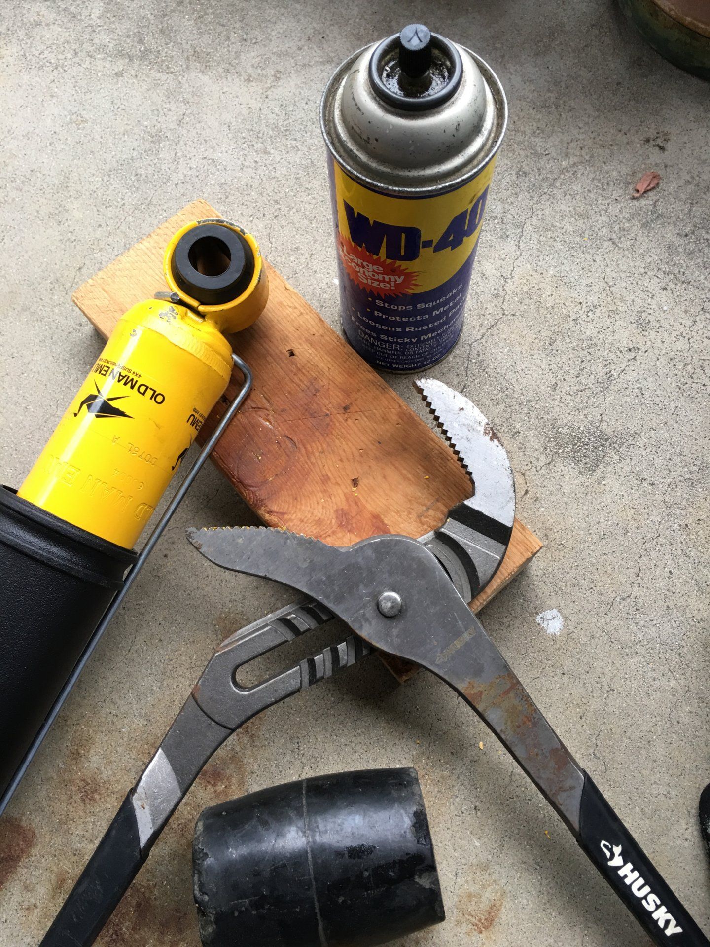

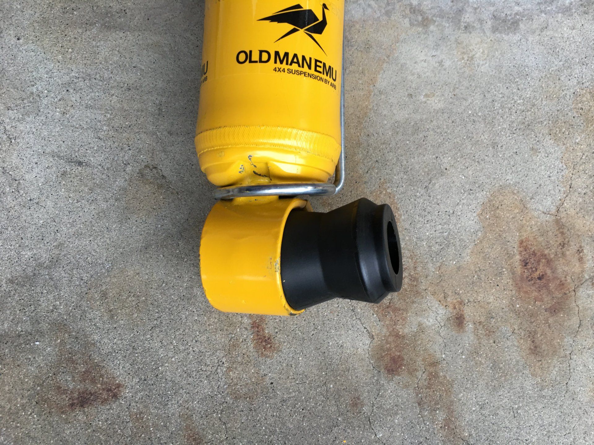

Ah, thanks. I already bought the 3-ton jack with stands and the truck is up on them. Wheel off, shock off, everything was going well until I cannot press the new bushing into my OME 60004 shocks.
What's the best way to press that sucker in? wd-40 and pliers or hammer? It's now sprinkling in so cal...arghhh. Any real time help would be good.
It looks like big pliers, a soft mallet, and wd40 were my friends.

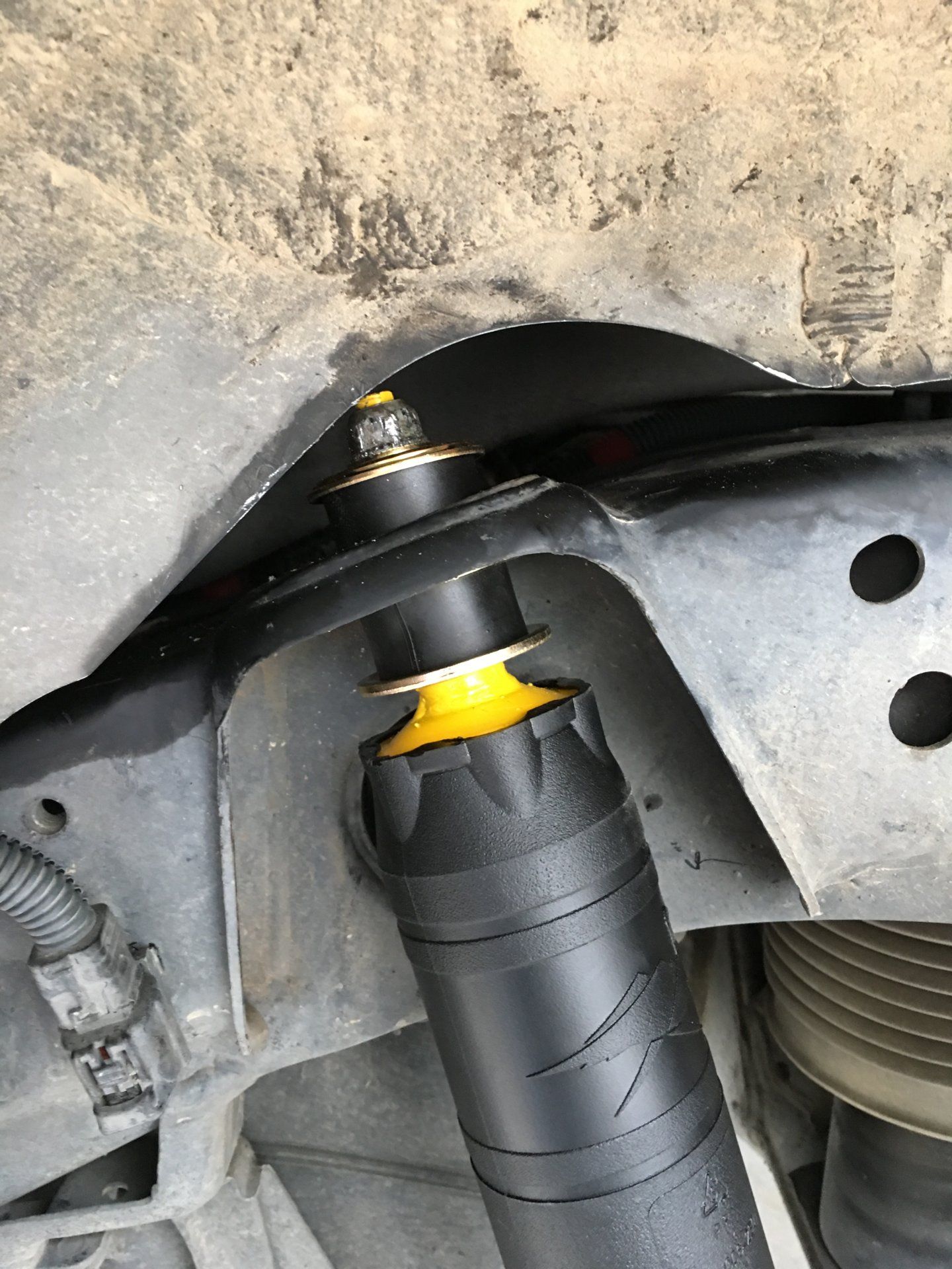

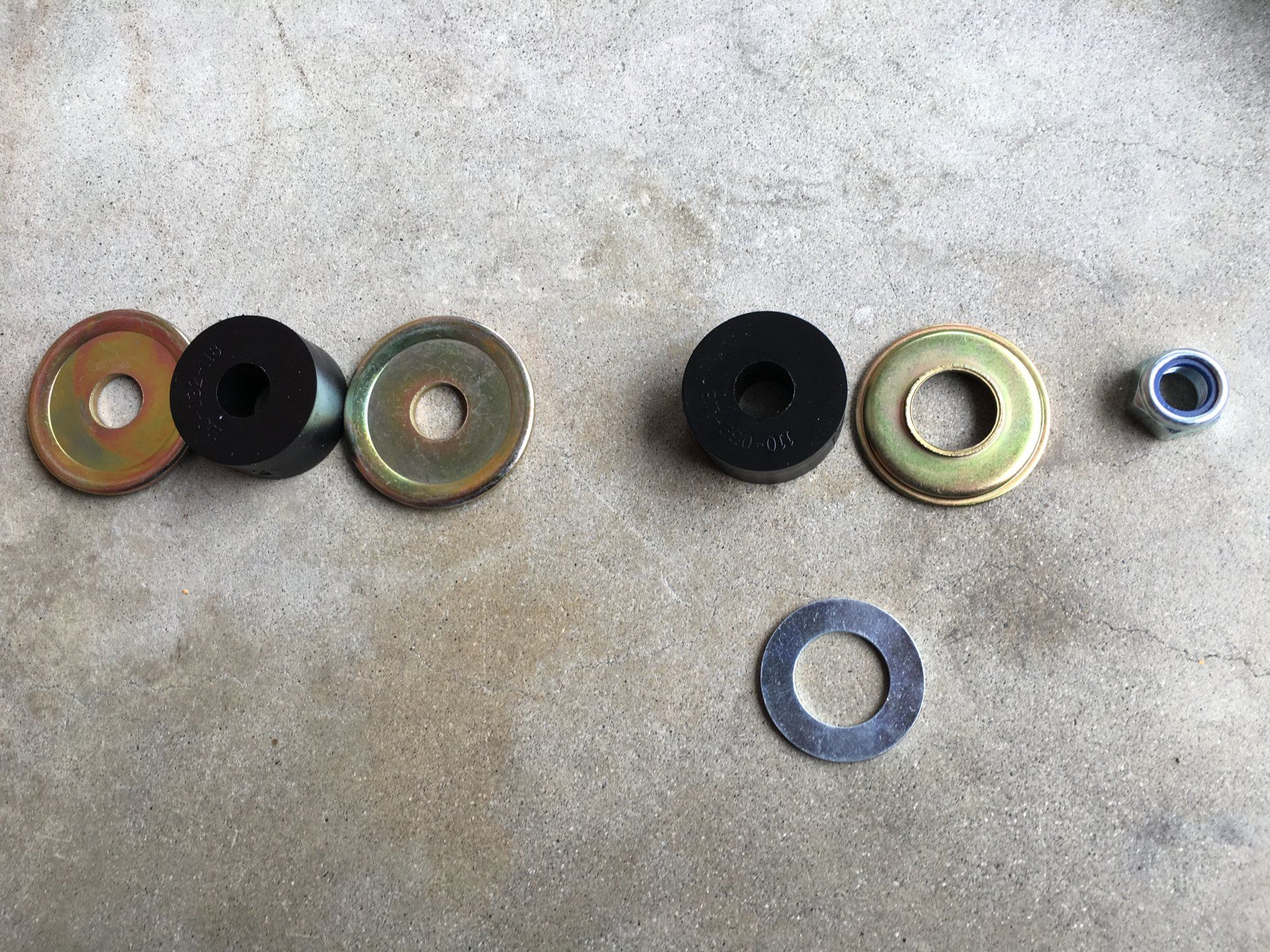

I'm done, but I have two concerns. First, I don't know what the flat metal washers were for on my OME 60004 shocks. One flat washer per shock, but it's bugging me that I got an extra washer per shock. Anyone know where this flat silver washer was supposed to go?
Second, I'm a little concerned that I didn't tighten the top nut very well. It was super tight in there, so it was very difficult to tighten that nut. Also, I didn't add any type of lock-tight to the nut. So, any tips on how I can tighten that top nut any better?
It’s easiest to get a ratcheting 17mm wrench in there. They do look too lose, you need about 2x’s the bushing deflection to be tight.

Re: I'm done, but I have two concerns. First, I don't know what the flat metal washers were for on my OME 60004 shocks. One flat washer per shock, but it's bugging me that I got an extra washer per shock. Anyone know where this flat silver washer was supposed to go?
Anyone have any idea on the flat silver washer in my previous post? It's still bothering me that I have an extra washer.

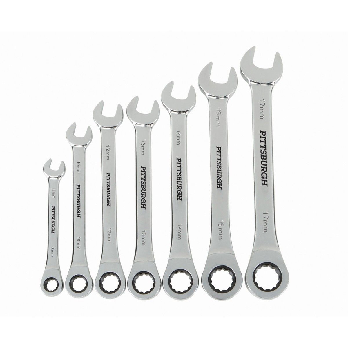

Also, I got a set of ratchet wrenches to tighten my shocks. $19.20 plus tax at HF with a 20% coupon. So, I've spent $130 in tools to do this myself, but I got a 3-ton jack, 3-ton stands which seem a little small, and the ratchet wrenches. But most importantly, the satisfaction of doing this myself.
I wouldn't sweat the 3- vs 6-ton stands. I've been using 3-ton since about 1998 and never an issue - not on an 80, Discovery, 94 XCab, my 40 or GX. Too late now, but flex-head ratcheting wrenches are the bomb, super useful. No idea what that extra washer is, in fact I cannot think of any use for it considering the larger washers capture the bushings....

The only use that I can see for the extra washers is the lower shock mount.
Re: Extra flat silver washer for rear OME 60004 shocks
You guys are making me feel better. At least it's not an obvious washer that I missed. I bought the entire spring conversion kit including the rear shocks from MT, so I guess I could call them. However, as long as it's not a washer for the upper portion of the shock, then I think I'm good. My instinct also tells me it was for the lower shock mount, but the existing washer for the lower bolt was in great shape and it looked like it was better made all around.

I was going to get the flex-head ones, but I couldn't find a set that included the 17mm one. They only went up to 15mm for the flex-heads at HF. Good to know that you really liked the flex-head ones.

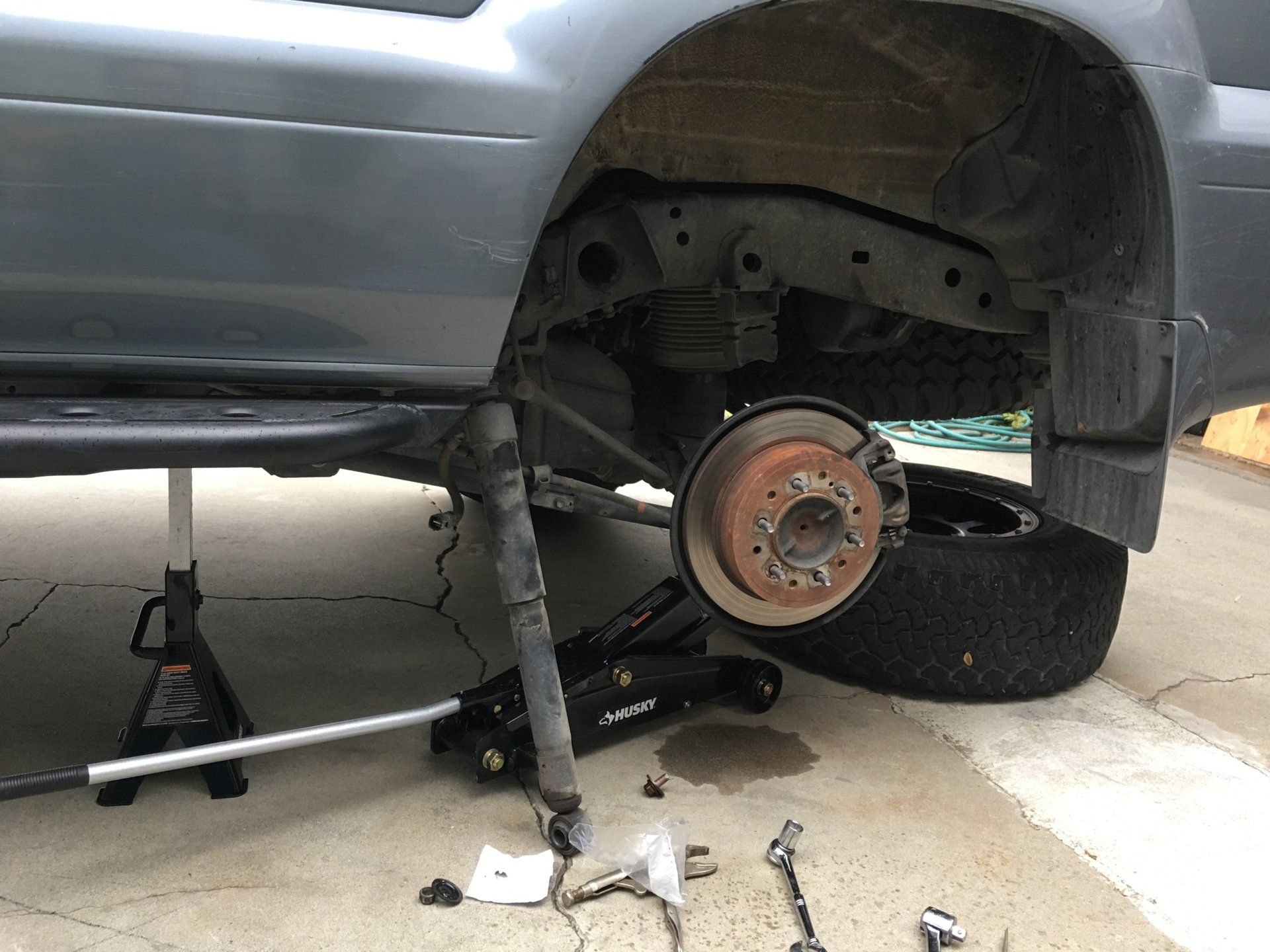

The 3-ton stands just look small, but I'm with you regarding weight. My calculations say that 3-ton stands should be plenty. I'm only lifting one side at a time and I thought the GX470s were under 3-ton for the whole vehicle, so I should be good.
Since I only lifted one tire at a time, I used the second jack stand under the rock slider as a safety measure. The primary jack stand was under the frame. I then used the jack to hold the axle in place and then threw the tire under the spare.
Anyways, my floor jack lifts up 21" max and it's barely enough to lift the tire off the ground. Also, the jack stands are near their top setting when holding the GX470. It's being at the top height limits on the floor jack and stands that makes me a little nervous.
You don't need to add thread-locker on that fastener. 1) It's a nylon lock-nut that has a piece of nylon embedded in the nut to keep it from rotating and 2) it's holding 2 big rubber bushings that work to isolate vibration and will by themselves prevent backing-out. Removing those buggered up nuts in a year or two will probably suck so you may want to replace them now that you have the proper wrench.

My new ratchet combo wrenches only went up to 17mm which is the exact same size as the original Toyota oem nuts for the original rear shocks.

I was able to squish the top bushing about 30% or so with the new 17mm ratchet combo wrench on both shocks.
I think I’m good for now, but I’ll keep an eye on those top nuts when off-roading.
