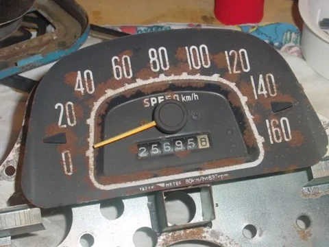

Hi Guys, I need your help.
I need to remove the needle from my spare speedometer to remove/replace the faceplate. The question is HOW?
I tried to pull it off and applied equal forces under the needle but it wont move.

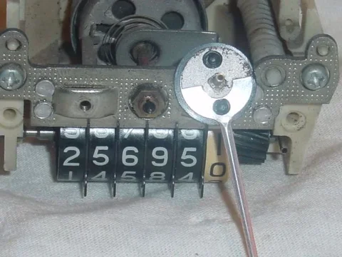

Got the needle off !!!
Finally I got the needle of without any damage.
Here is how I did it. I brought the needle in the 12 o'clock position.
Held the shaft with a flat nose plier in a steady position and turned the needle left - right while pulling. At a certain point I thought that somebody glued the two together but fortunately it was not.

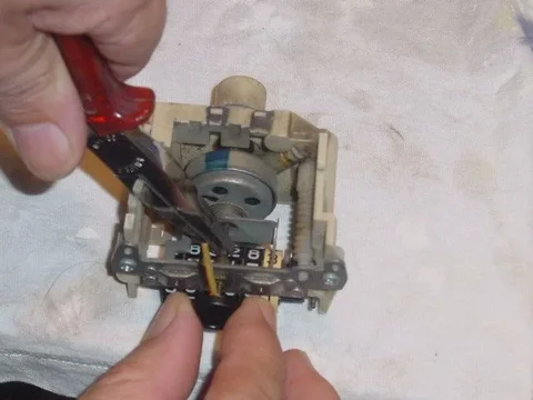

I (correction: the :princess:) took a picture of how I did it when the face plate was still on.

The removal is just twist and pull. Hold the shaft with a plier and turn the needle clock and counter clockwise while pulling. Mine was pretty stuck too and just when I thought it's not gonna work it popped of.
Put it back: put it back a bit above 0 position with light pressure.
Move it to the 0 position and push a bit harder. Ready!
