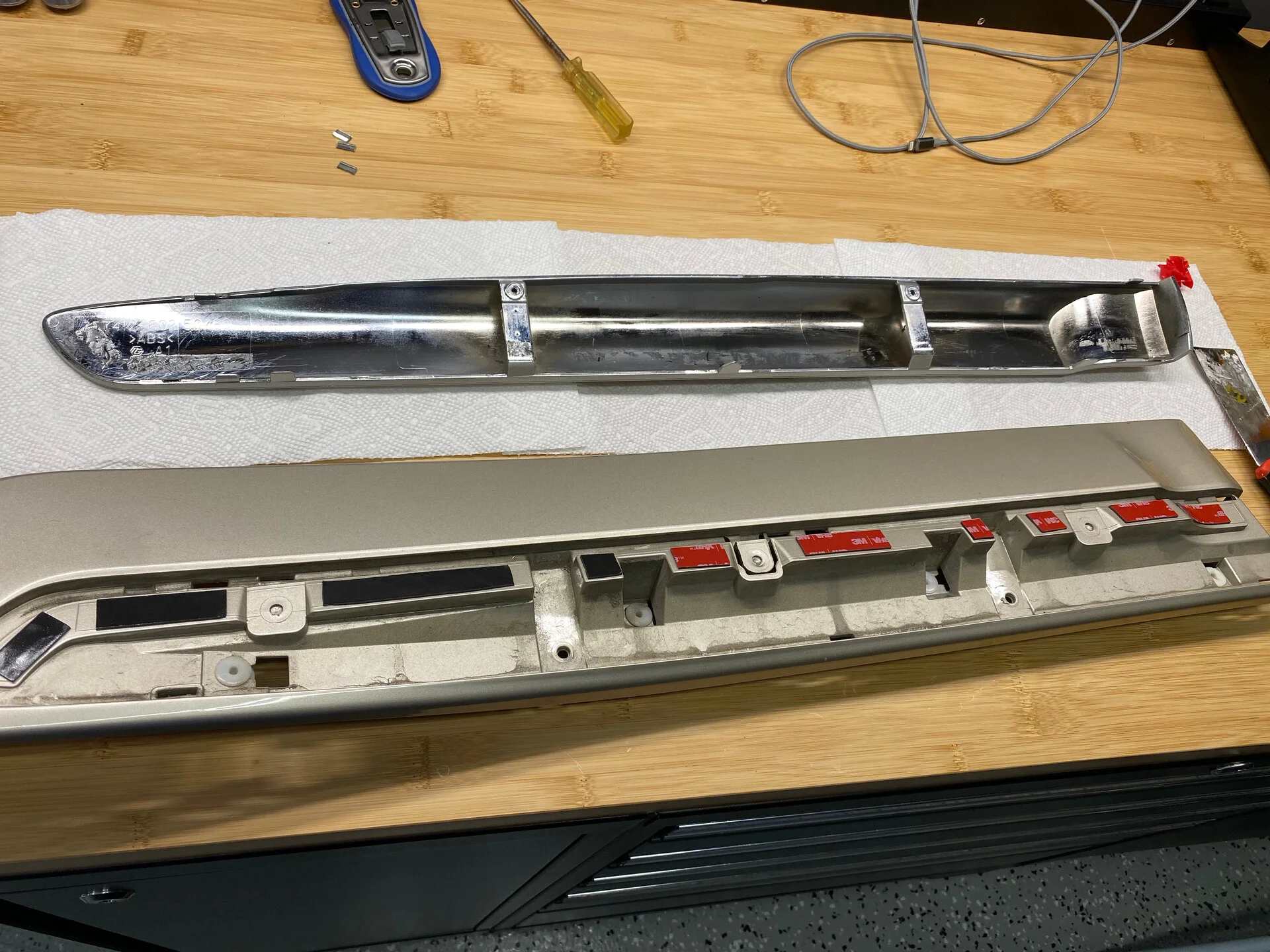

If I recall correctly ('13 LX), the chrome piece is attached to the larger molding piece with adhesive tape and 2 or 3 screws. The larger molding piece is attached to the vehicle with clips; you can gently pry them off the vehicle as a unit. Then you can remove the chrome piece from the molding and do whatever painting, wrapping, etc. you prefer.

That is the case. You can pry off the whole piece and the chrome strip has screws holding it into the larger piece.

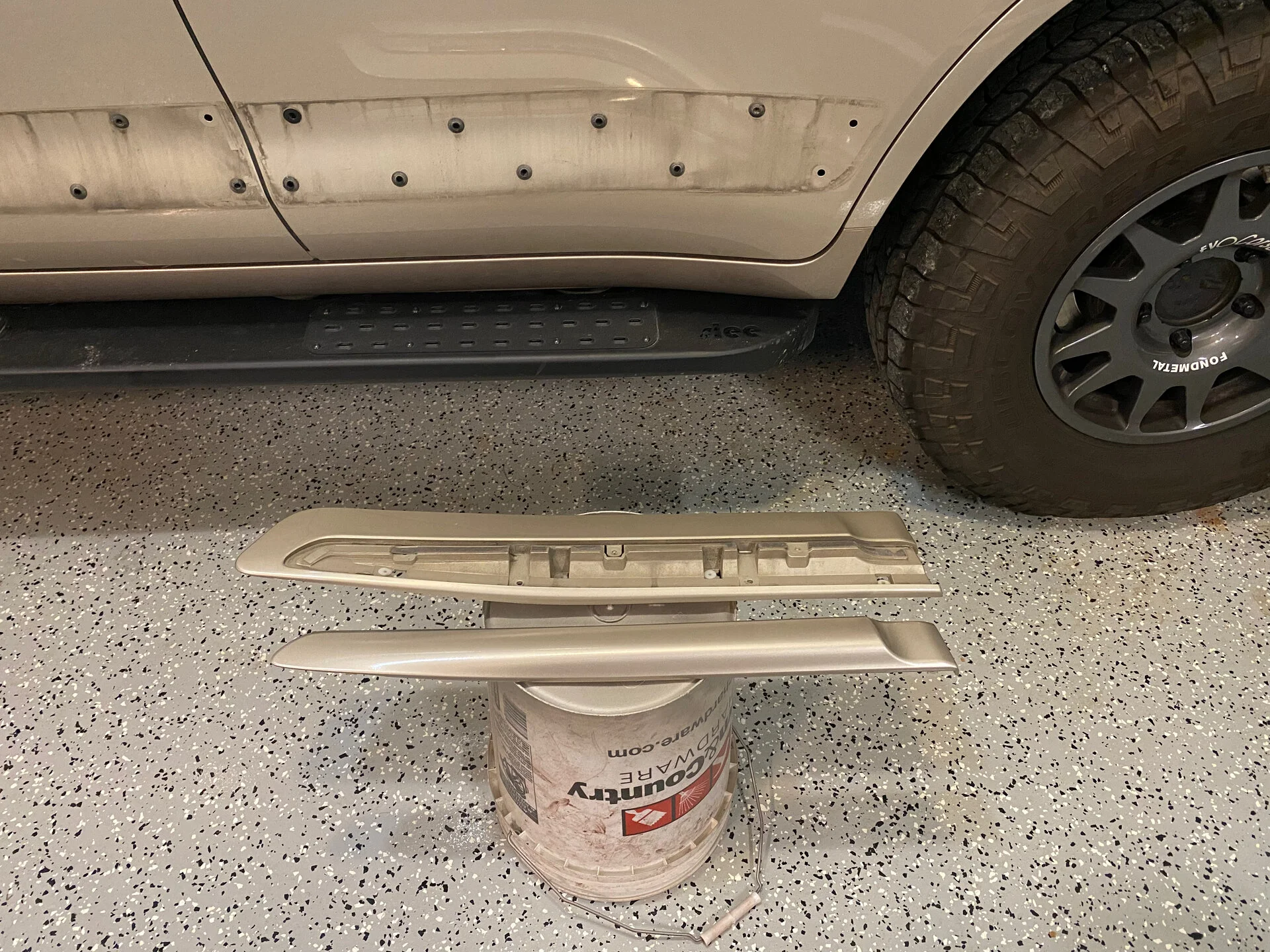

I really wish there were not the holes in the door panel. I like the look w/o the moldings and with sliders, I don't really need the moldings for door ding protection. I imagine getting them filled and the doors painted wouldn't be cheap professionally done.

I pulled mine this summer and had them painted. It took time and patience to get the two sided tape residue off the back of the molding for reapplication but I was happy with the end result. Good luck!
