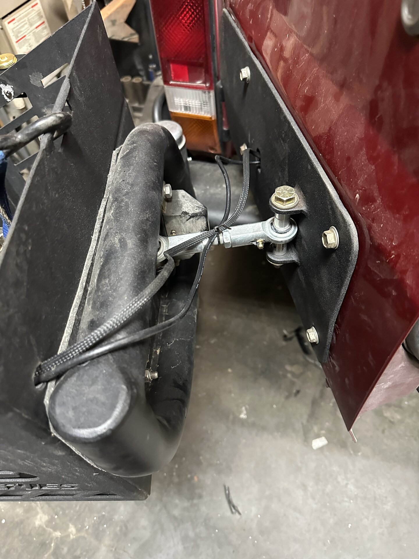

Question to the masses… I’ve built swing outs that work in tandem with the ambulance doors on my 73 series. Even though the spindles are carrying all the weight of the door—- if I park facing downhill — gravity is pushing the door to close with this additional weight. Basically, the limiters don’t have enough force to hold the door open. Has anyone figured out a way to keep the doors open? Specifically wondering about making something to go over the door limiter to keep it open? Or has someone found a better option?

Yes, blend of Cruiser Outfitters (made by expedition one) and the OZ version. Does Cruiser Outfitters give you a solution to the door staying open?

Also, I am curious if a new/less worn limiter wouldn’t fix it. It doesn’t appear you have added much more additional weight and mine (standard tire carrier) holds really well with a 33” tire and steel wheel.

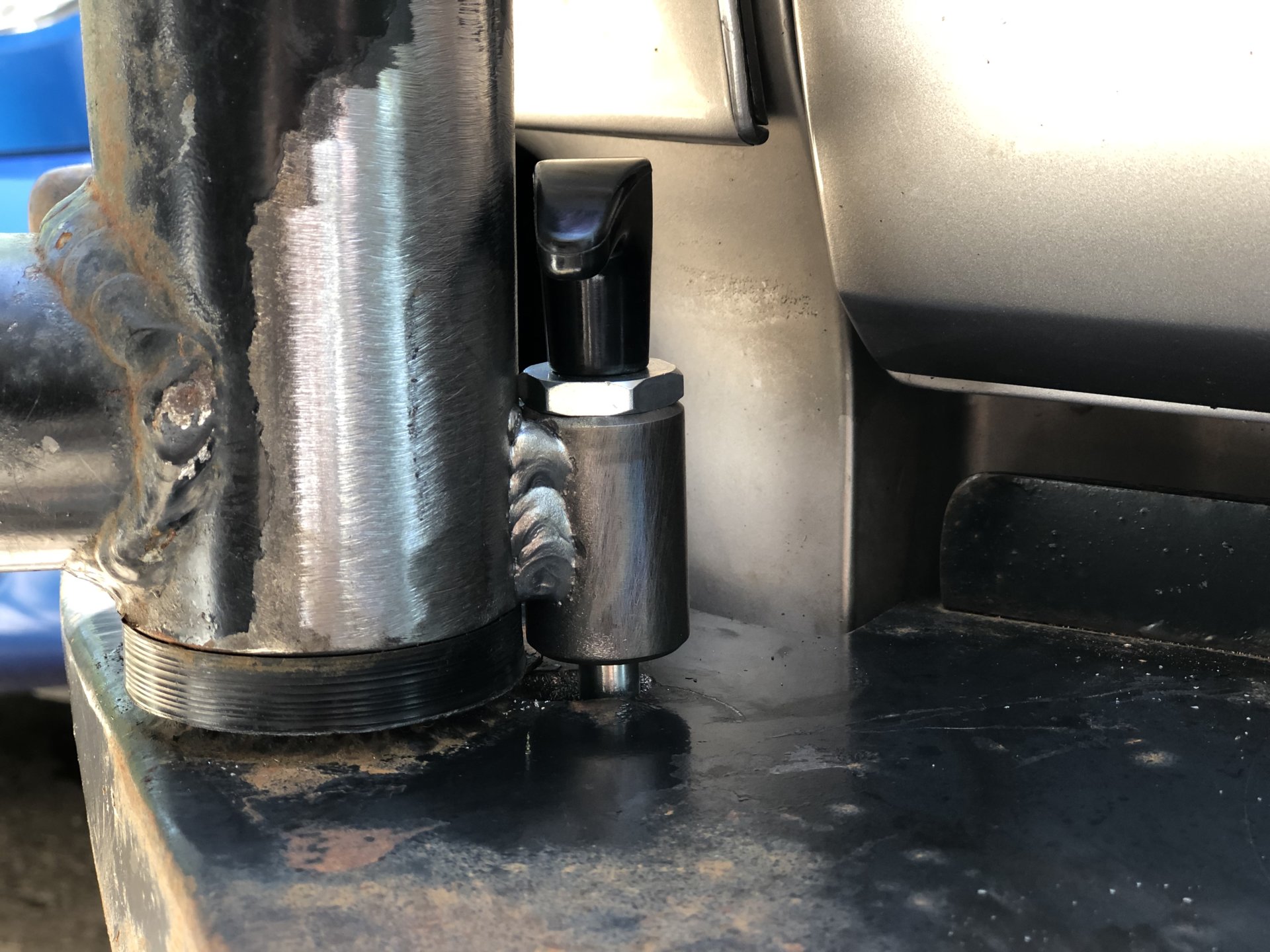

Can you add pull pins to the swing outs that would sink into the bumper?

Since it's your own design, the pull pins as described above might be the simplest and strongest solution.
Can you add pull pins to the swing outs that would sink into the bumper? View attachment 3463488
Good idea; however, I really don't want an additional step 100% of the time, if I only need a solution for 5% of the time.
I think I will order new door limiters and see if that helps. If not, something that goes over the limiter ( a pipe) or 3d printed wedge might fit the bill.

the pull pin doesnt have to be 100% of the time, they make some with detents that will stay open with a twist
of course you could also just add a support strut to the swingout and that would keep it open but not be a "lock" to need to manupulate at all.
