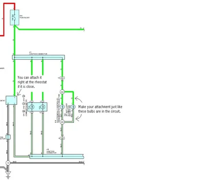

Now you have the two wires that are there for the light. I really want to get the light to work with the dash lights. So I am assuming that just one wire to ground and the other tied into the dash light switch should suffice. Anyone else have a better idea?
Okay, even though you bought that 60 out from underneath me, I'll help you out.:D
Don't wire it the way you talked about above. Here's an excert from the EWD:
It should be fairly straightforward. You can use Scotchlocks or strip, solder, & heat shrink, that's been discussed elsewhere.:bounce::bounce2:
Haha sorry about that. As soon as 450DUDE put the listing up I had already emailed and spoke to Zach. Its going to a good home, I promise! :beer::beer:
You must have got to him first and seemed a sure thing, 'cause he never replied to me. I'll keep looking for another deal like that.
So I am just connecting the T and L pins on the rheostat? Looks easy enough. And yes, it's literally right next to it.
All other lights in that circuit are wired that way, with power from the "tail" fuse and ground controlled by the rheostat.

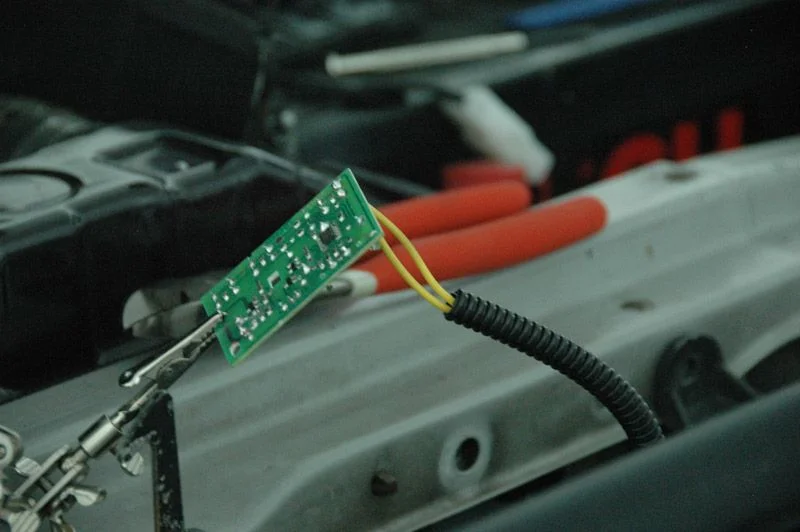

Sooo, I started messing around with this thing some more because I was really unhappy with the decreased range AND it was intermittently cutting out and only giving a 10ft range. Basically meaning I had to be next to the door before it would open.
Because as it takes literally 3 minutes to remove the plastic trim, I decided to take the switch out and perhaps change its location. I thought about moving it above the rearview mirror but I really didn't want to deal with the headliner.
So instead I bought a really cheap project box my local electronics store. I did NOT want to use the opener case it came in because I didn't want it recognized.
So I took the first switch I made and took it back apart. This time running two 18 gauge wires to the front grill of the truck. I used Molex connectors on the switch to make it easily removable. I then soldered the two wires to the board again. It doesn't matter which wire goes where, all you are doing is completing the circuit.
Once it was soldered I used double-sided foam tape to stick the opener to the inside of the project box. I then used an alcohol pad and clean off the side of the driver's side headlight housing (it was flat) and used double stick tape to attack the project box to the headlight housing. I decided to use double-sided tape because I would be replacing a battery only once every year or so. But you can come up with your own attachment solution.
Once that was dine and tested, I then decided that it really didnt matter that there was a house icon on the switch because the truck is always garaged AND the remote is hidden. I will do up a quick HOW TO for relabeling the switches and stick the link here.
Sorry about the crappy photos. :flipoff2:
