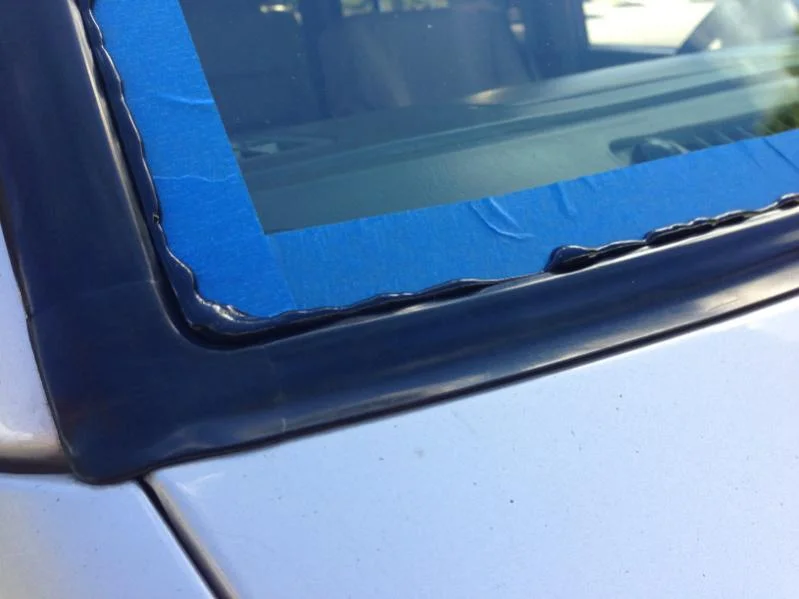

So after two years of dealing with the leaking window, and two years of having the adhesive collecting dust on my shelf, I finally took an hour to do this. It's 78deg today and I'm in shorts and flip flops so I figured today is the day I finally do this. I followed Firetruck's instructions except that after I was done filling in the adhesive I put on a pair of latex gloves and removed all the big wads of adhesive. The adhesive itself flows so no worries about streaks or fingerprints. Looks like it will be easier clean up now. I'm going to let it dry for a few days before I remove the tape. It's supposed to rain tomorrow but not too worried since its garaged.

So, am I guessing correctly that for those of us who did not have any sealant in (as in a bad replacement job) and who are now putting sealant only on the glass side, that the windshield and rubber seal would still (easily?) separate from the body by prying the (sealantless) seal off the metal, regardless of whether the seal is now firmly affixed to the glass?
Oh yeah, I was easily able to pull up the windshield seal. There was zero adhesive I could see at any spot that I pulled it up.

I wouldn't waste my time or money with it. It is doubtful it will adhere to the glass for long. You need a polyurethane adhesive. The one I recommended in the original post was about $10, and available at the big box home improvement stores. It is holding strong 3+ years later.
Finally trimmed the excess away from the windshield. Important note to the next person doing this: make sure the tape is NOT under the seal. After trimming I noticed some of the blue tape is sealed under the new gasket. Oh well. The other thing that bugs me is the polyurethane is glossy and you can see where it runs on the gasket. I'm also hoping that when it fully cures it won't pull lint from paper towels. Another ugh. But windshield is sealed so :meh:
Good points. I had some space (1/4"?) between the seal and the tape line. I did not put any adhesive on the outside of the seal, just underneath, between the seal and the glass. Then once the adhesive was dry, I used a razor to cut a clean line even with the seal, and then used the flat edge of the razor peel up the excess between the seal and where the tape was. There is really no need to have any adhesive on the outside of the seal. Sorry I did not mention that before.
was thinking that one possible drawback of this fix would be if the seal can't be removed from the glass without being damaged. For instance you'd be on the road and lose the windshield. You would normally hope that somebody would have an aftermarket windshield that would fit, but would they have the fancy OEM seal if the existing one were to be destroyed when pulling the old glass out? I imagine that the glass guys normally reuse the old seal, no? Or do they always stock glass and seal together? So, having a fairly mild adhesive -is polyurethane one?- might be best?
