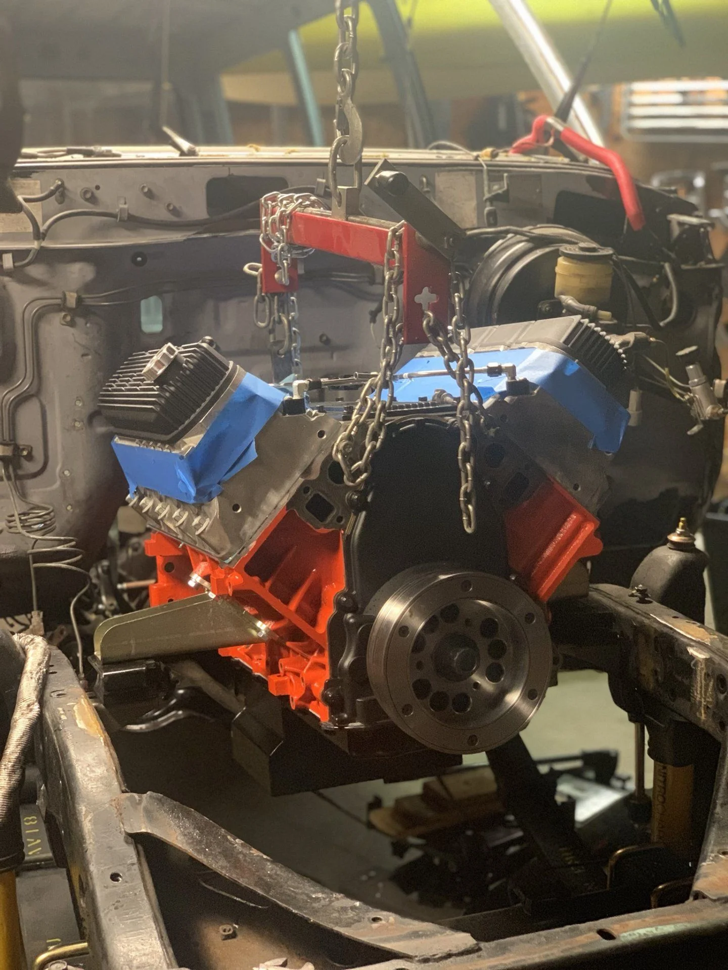

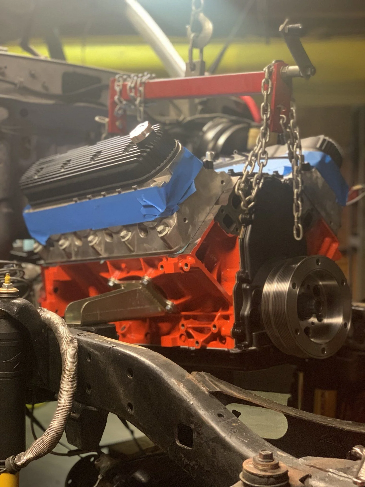

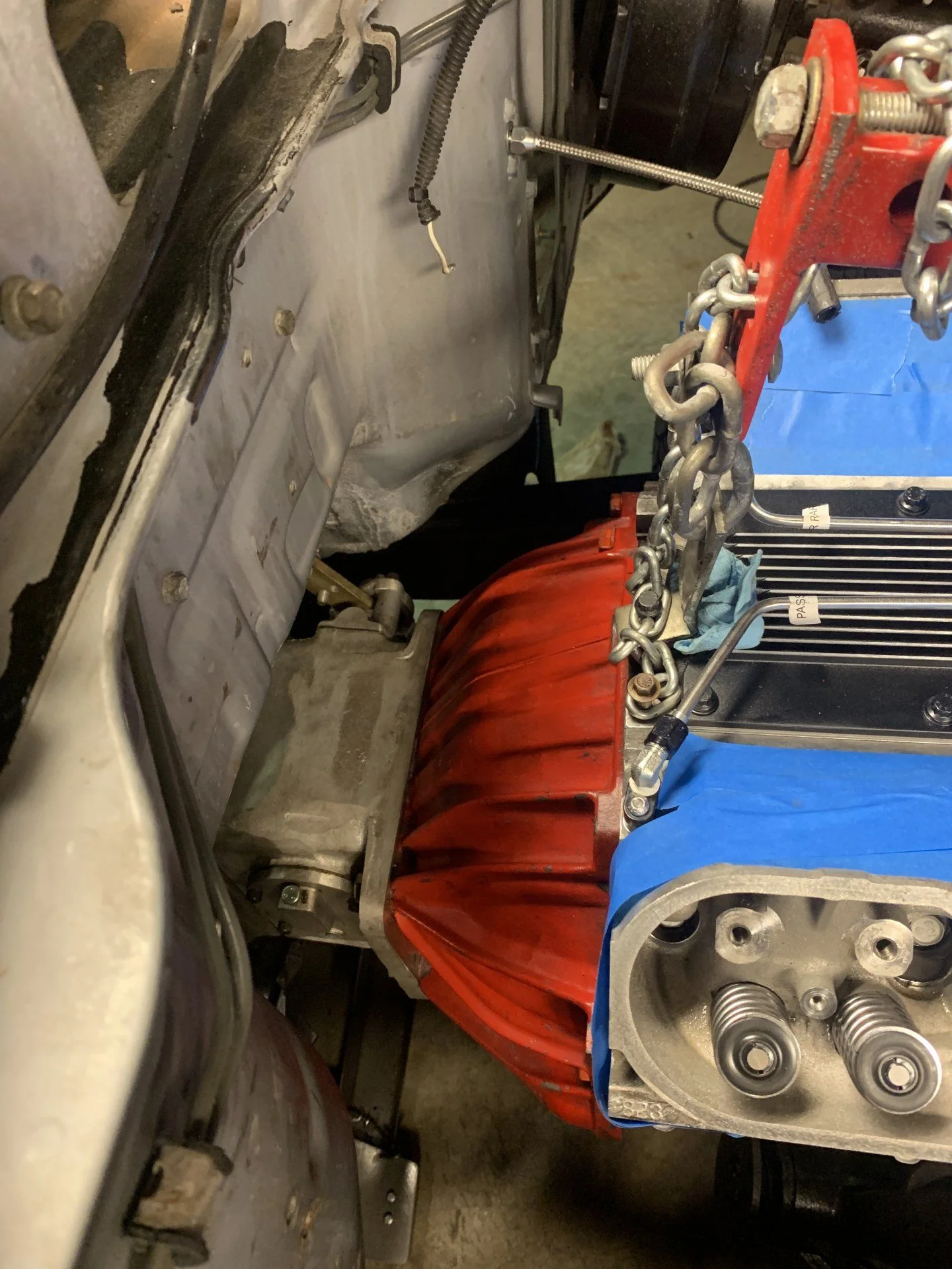

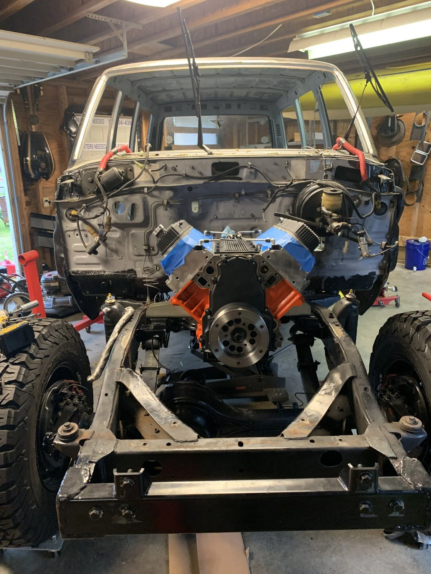

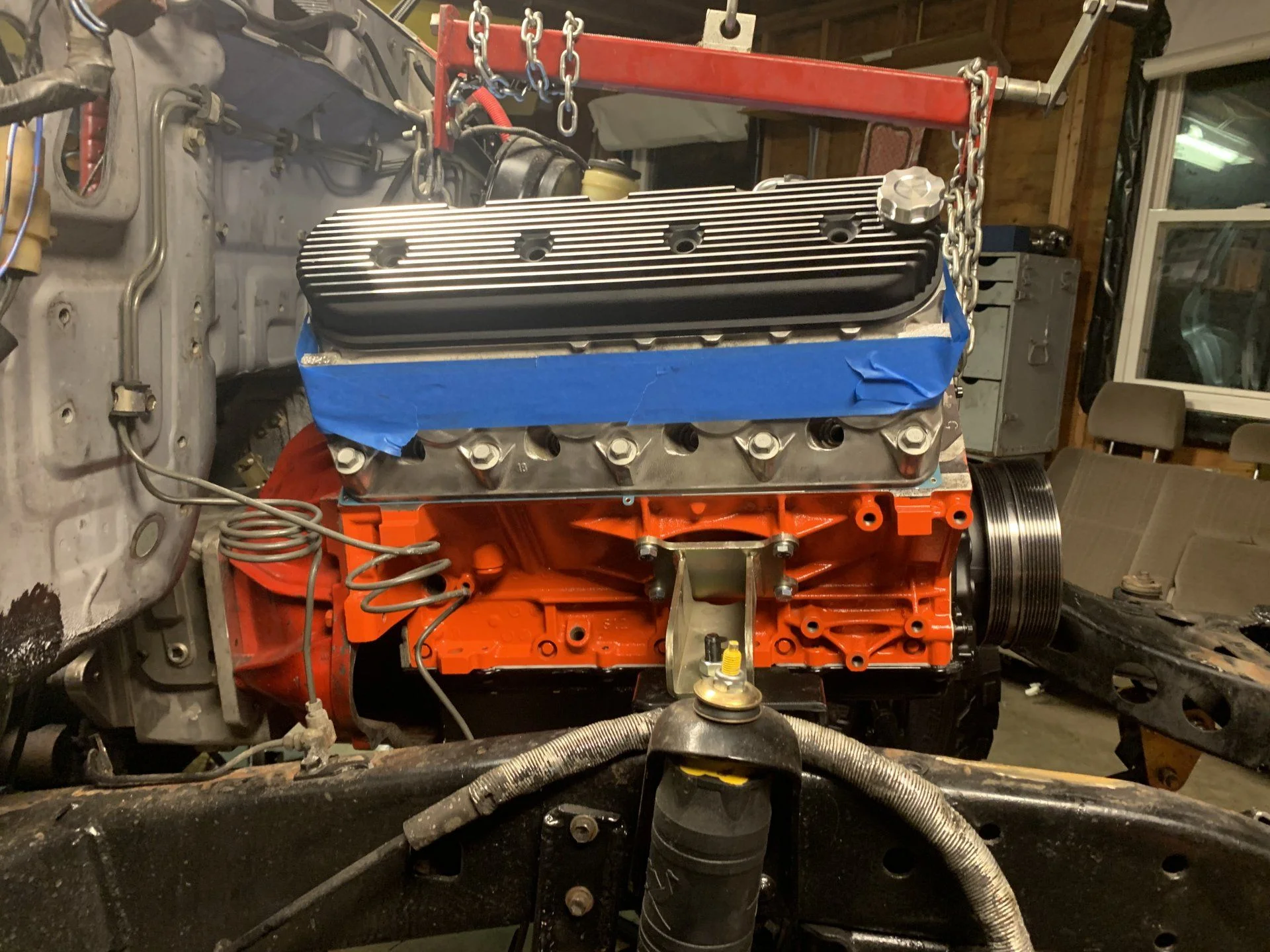

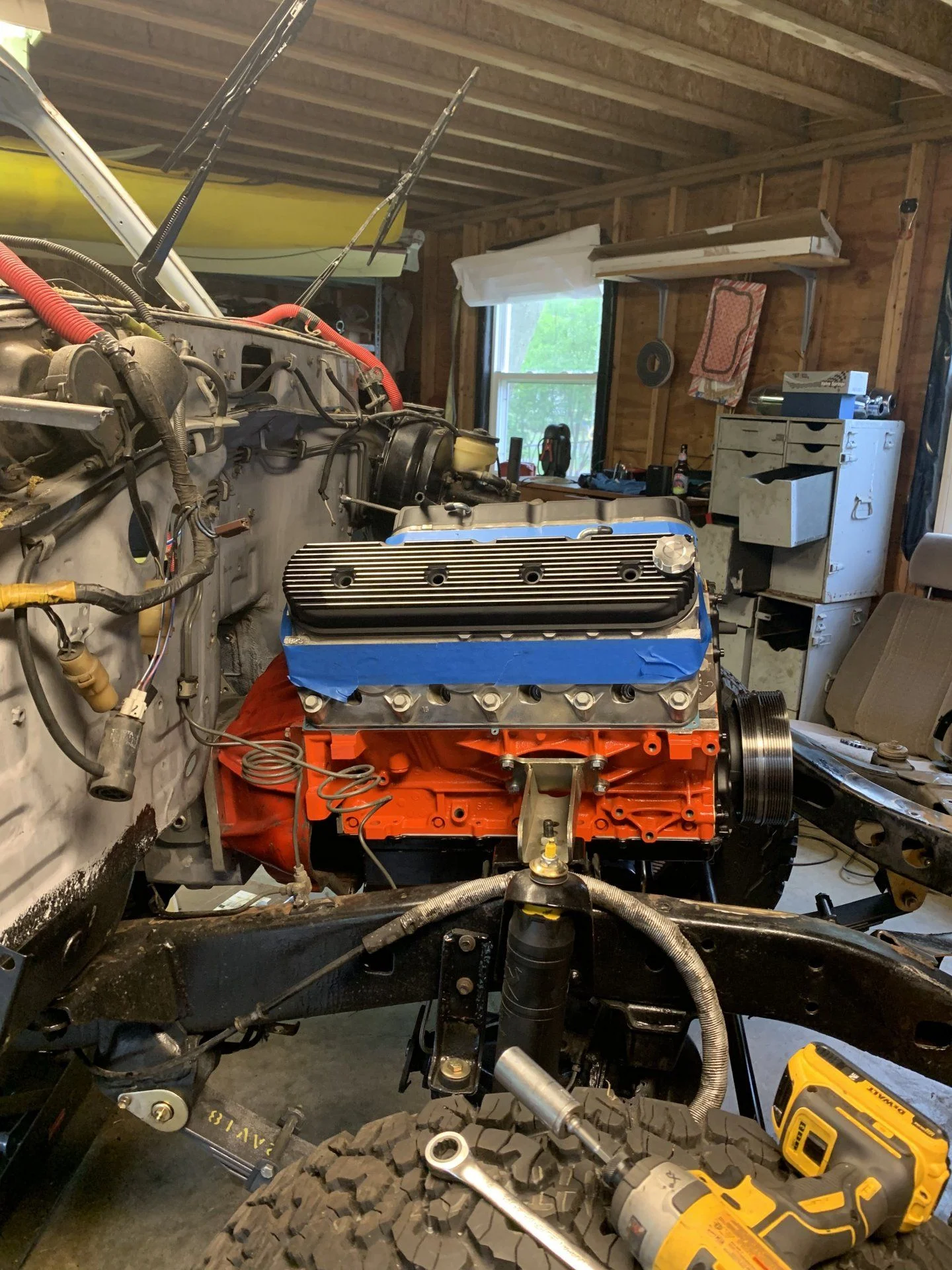

Engine is together, drivetrain was mocked up and and ls mounts are in. It’s going in to get paint this week. I’m going with BMW imola red

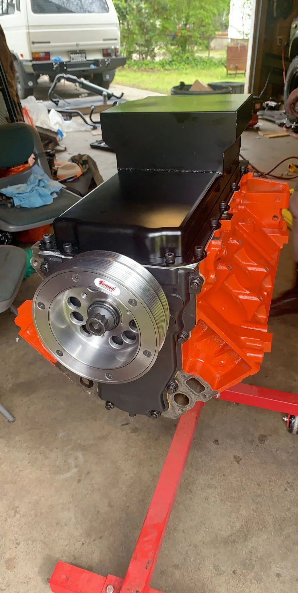

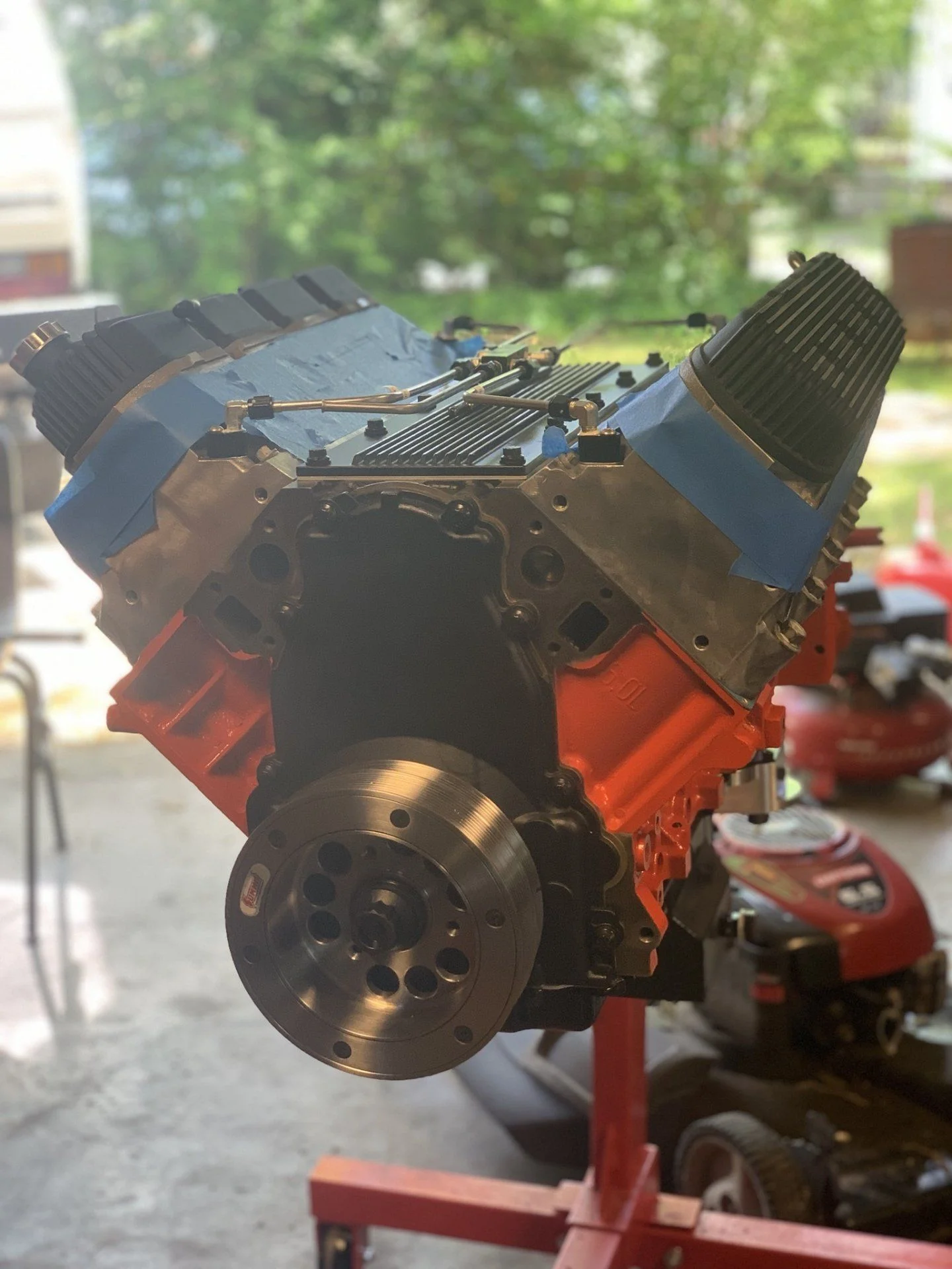

2 cubes larger than the 2nd smallest original old school rat motor. you know you're gonna have to post video when you've got that bad boy breathing

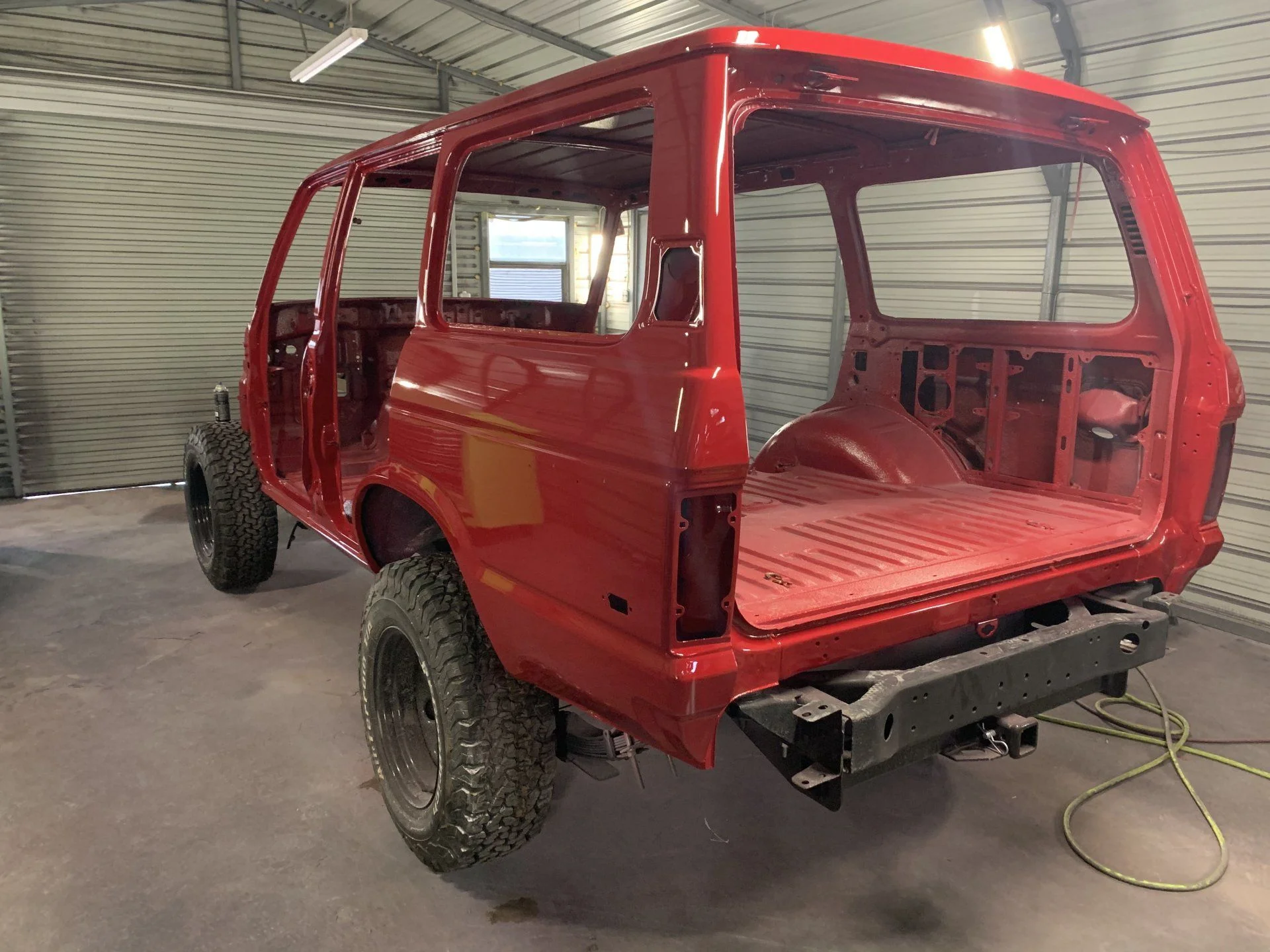

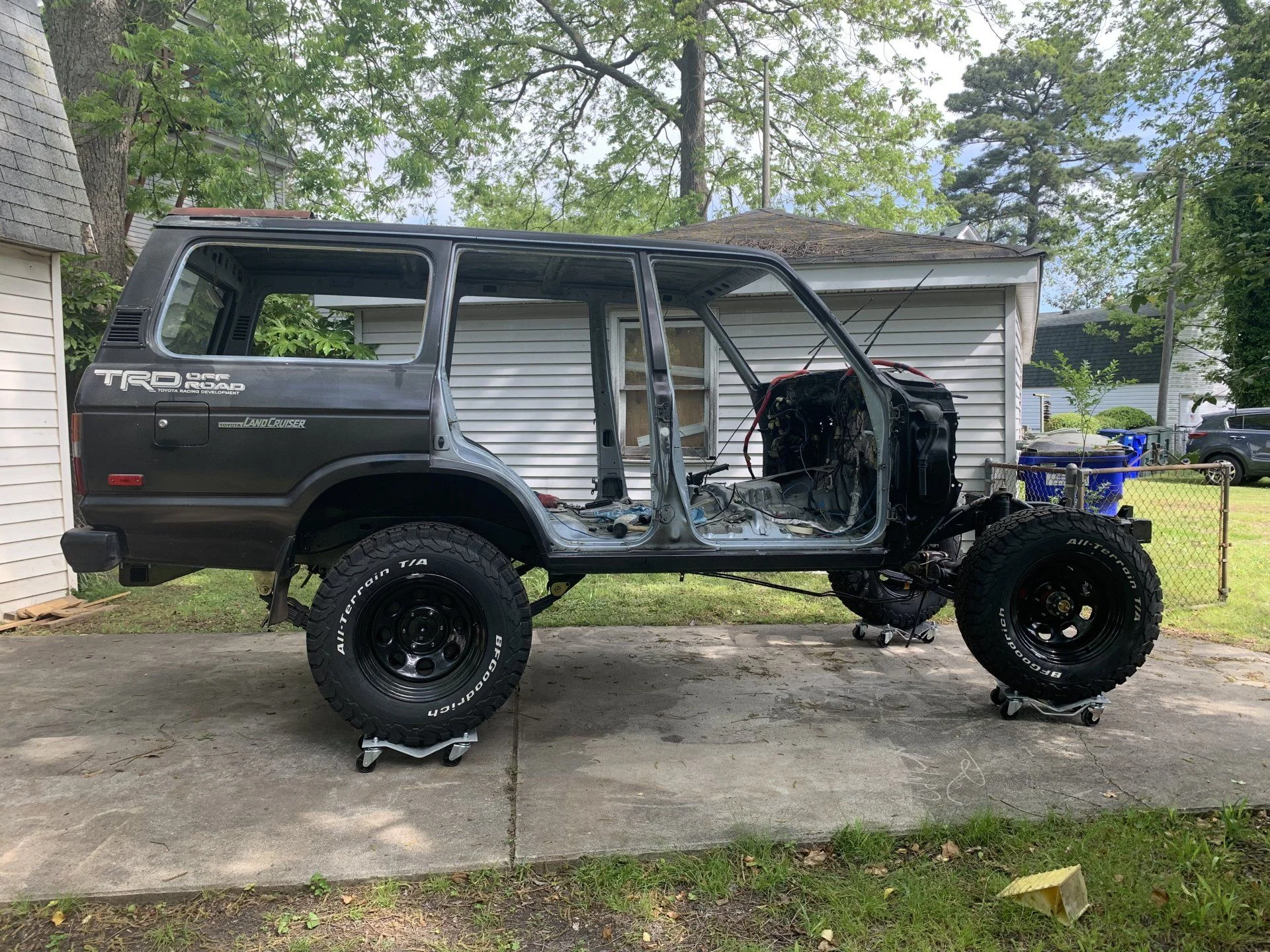

Hi all. Haven’t given up on my high horsepower 60 project and I never will! Might be a while though! Truck got painted in BMW imola red right before I went on deployment. Got a lot of super cool goodies for this project. Aussie smoker windows, custom HVAC panel and speedhut gauges. Still have a couple more months out here but I’m looking forward to putting her back together.
