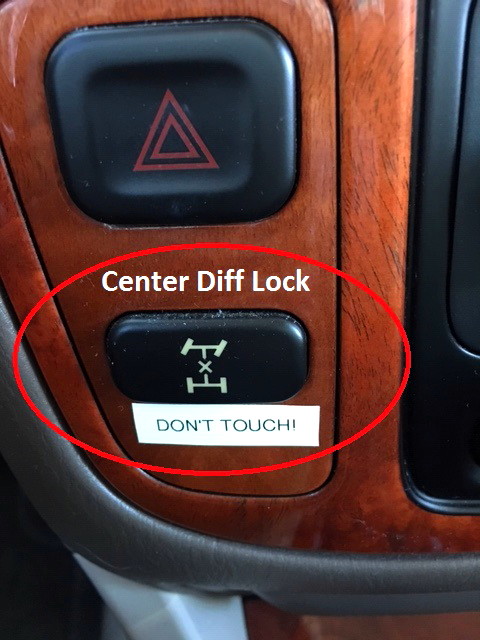

Me pointing to CDL button, quizzing my fiancee: "And what does this button do?"
Fiancee: "We don't touch it!".
Offroad is a different story.

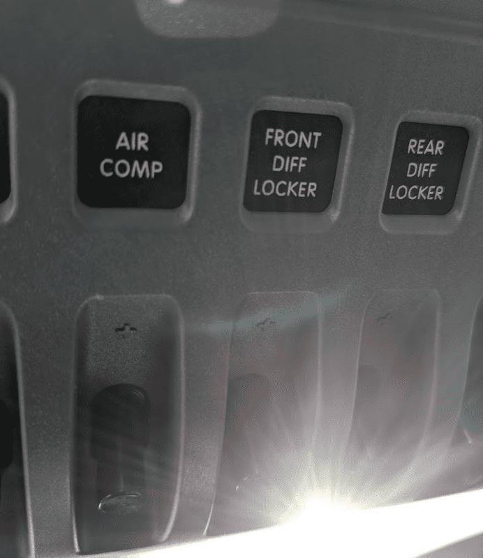

This really made me LOL. So for my front locker, I installed a switch and light overhead. I made sure I picked out a flashing red light when it's on, also the blue sea toggle switches take some pretty pronounced finger power to flip on. This is important because my little girl likes to go in there when I'm not looking and press all the buttons.
Zoom out in that switchplate- looks like a nice set up.
They are all self-explained except the "electronics" that one switch on/off accessories on AUX battery. For example, my driving camera which has a front and rear view camera can be left on indefinitely, or I can switch it off.
Very clean- nice work. Thanks for the pic👍
Looks like an airplane.
Same thing I told my Wife. And also made a sticker to be sure She didn't forget.
