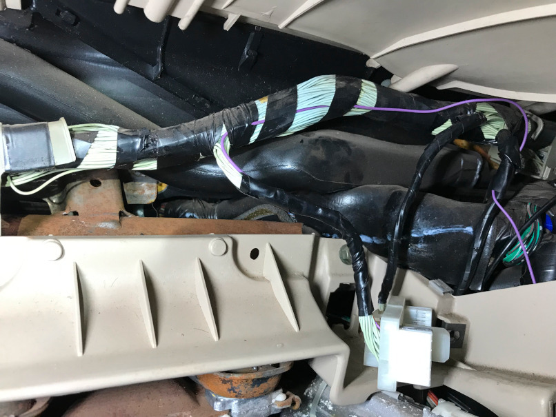

My '99 LC has the Front Diff Lock indicator already in the combination display, even the bulb was mounted. All that was needed to use it is run a wire from connector C, pin 10 from the back of the dashboard, connect it to ground to light up the indicator:View attachment 2761148
I suspect this was designed in and prepped for the 105 but glad my 100 has it as well, using it now for a Harrop e-locker.
Got some questions about the details of how to wire this up so here´s a follow-up:
The Front Diff Lock Indicator light is powered by the combination meter and has one wire leaving the combination meter on Connector C, Pin 10. This is the 3rd connector counting from the left (Identified as C14 in the LC100 '99 Electrical Wiring Diagram), pin 10 is the top left pin on that connector. The connector already has pins, open it up carefully and add a 22 AWG line, then close the connector again to clamp the line in. The result looks as follows, the purple line is the added line:
To turn the Front Diff Lock Indicator on, this purple line needs to be switched to ground. This needs to happen when the Eaton Locker is powered. Add a monitoring wire to the Eaton front diff lock power supply and use this to drive the indicator light. I connected this monitoring wire at a location between the relays that actuates the diff lock and the diff lock itself. That way, if the fuse to the diff lock is blown or the diff lock relays is broken then the indicator light stays off to notify a failure. To invert the signal from the diff lock monitoring line use a small relays or the following circuit:
The "Front Diff Lock Indicator" at the top of the circuit is the line coming from the combination meter. The "Front Diff Lock Actuator Power" is the line coming from the Eaton front diff power supply.
One additional hint for trucks that don´t have AHC: you can use the AHC relays location in the fusebox and the existing AHC wire harness under the hood and behind the dash to control the Eaton front diff. The relays you'd need to get is an ABS(TRC) relay (Toyota partnumber 88263-24040, Blue Relays). Saves pulling a couple new wires through the firewall.
