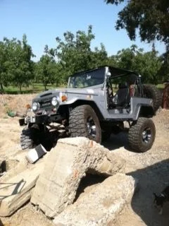

my first build
Yeah, that's mine. I love the springs. Much softer than the Safari and OME
i road in. I cut and turned the knuckles so I could run a 12" travel shock.
It's really quite flexy now. The stock pinion angle up front sucks so if you want a lot of droop you need to do a cut and turn. I also used the long travel slip yoke that Man-a-fre and others sell. It'a a Joint Fuji part that uses the FJ80 front yokes and u-joints. It has 45 degrees of articulation
instead of the stock ~24ish degrees
So in addition to the shackle reversal, The Mojaves require a cut & turn and a driveshaft mod?

They don't require a cut and turn but if you don't you'll have to limit droop with the shocks like every other 4" lift does. You can only droop the front axle until the front ujoints bind. The mohaves will droop 14" if you let them. Way past the point you snap a ujoint or pinion. The one major flaw in the setup toyota has for the fj40 front end is the pinion angle. Anything 4" lift or over should be thoroughly
cycled and check in shop before wheeling. People will run the springs without cut and turn. They will get the good ride but there is a lot more potential
The Fj60 pinion angle is far more forgiving . About 6~8 degree advantage. Mohaves on the 60 can cycle 12" without pinion issues. I guess Toyota learned through the years that lift kits were going to be an everyday reality.
