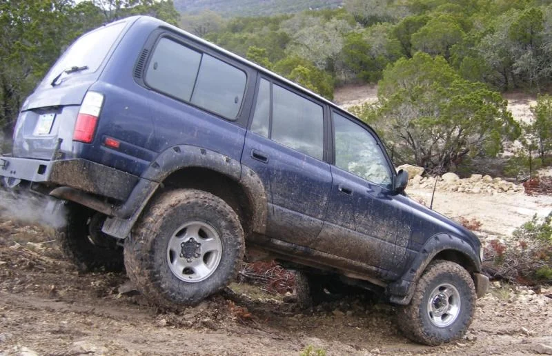

Flares
https://forum.ih8mud.com/attachment.php?attachmentid=620897&stc=1&d=1334332159
Those are nice. Are they cheap cause in sure to rip a few off.
Fat-fingered on my iPhone using IH8MUD
WTF??? I PM'd Baktasht about a month ago and I haven't heard anything now this guy is claiming he is making them???
Why in the world would your buddy post up that EMS is making these flares???
Those flares are a passenger side mock up by Baktasht at EMSPowered. The driver side isn't done yet. They still need some work, but I should have the completed full set soon. No big deal for me since I haven't paid them anything and I have one side that I really like. They are solid and they give way if you push on them.
