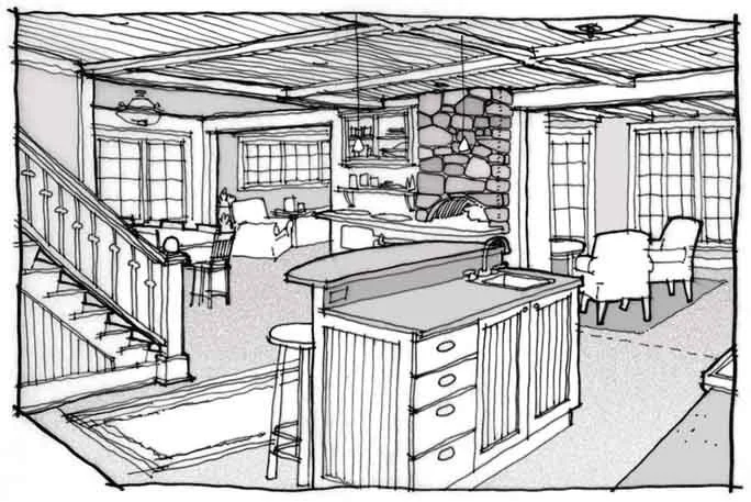

Planning on starting this one in a few months. Going to modify it for a bigger master bdm with a sitting area. Also modifying it for a walk out basement. Any input?
