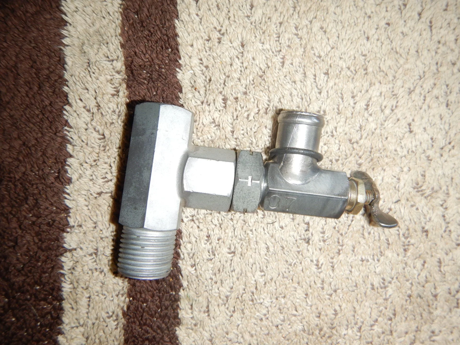

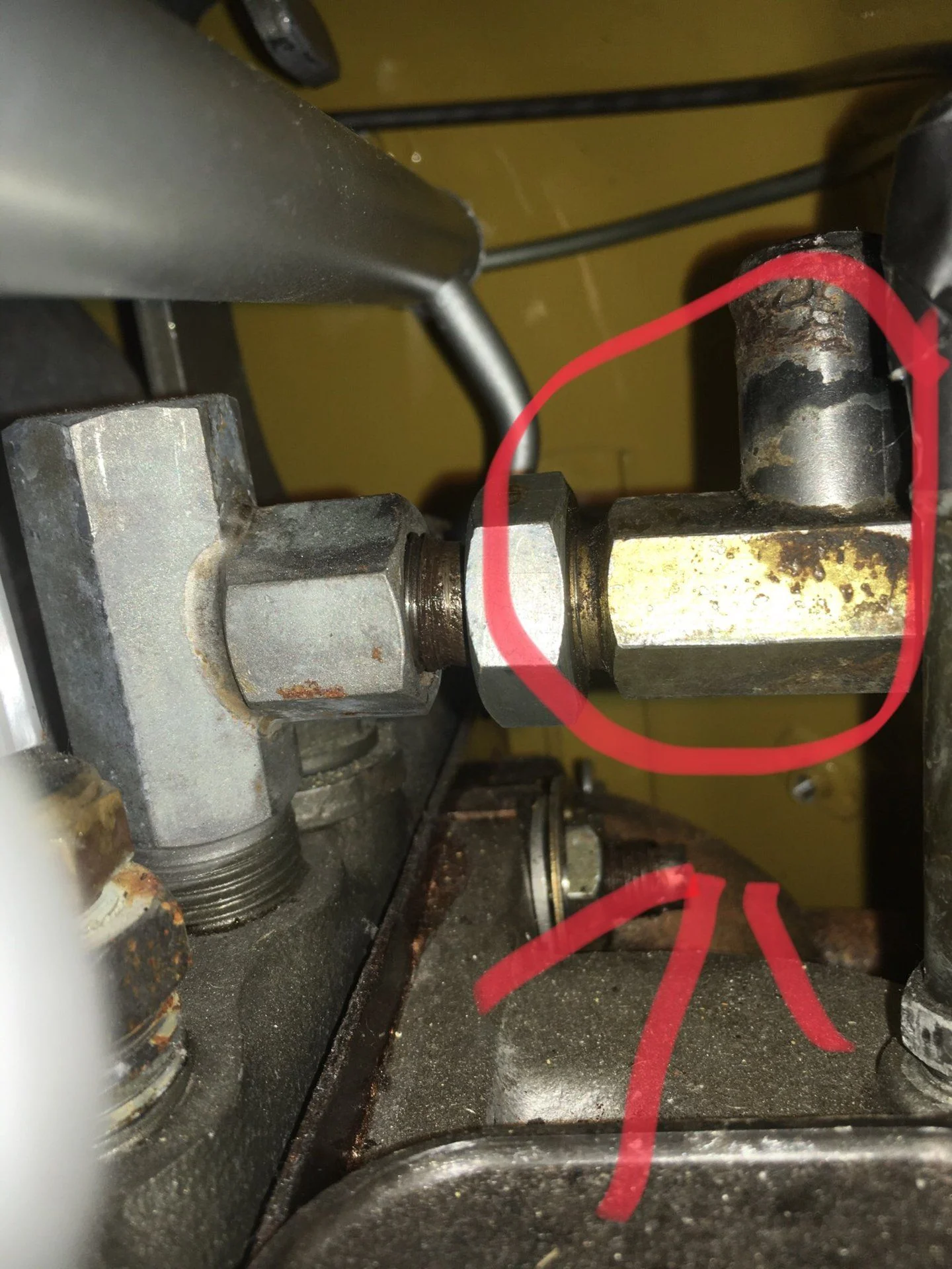

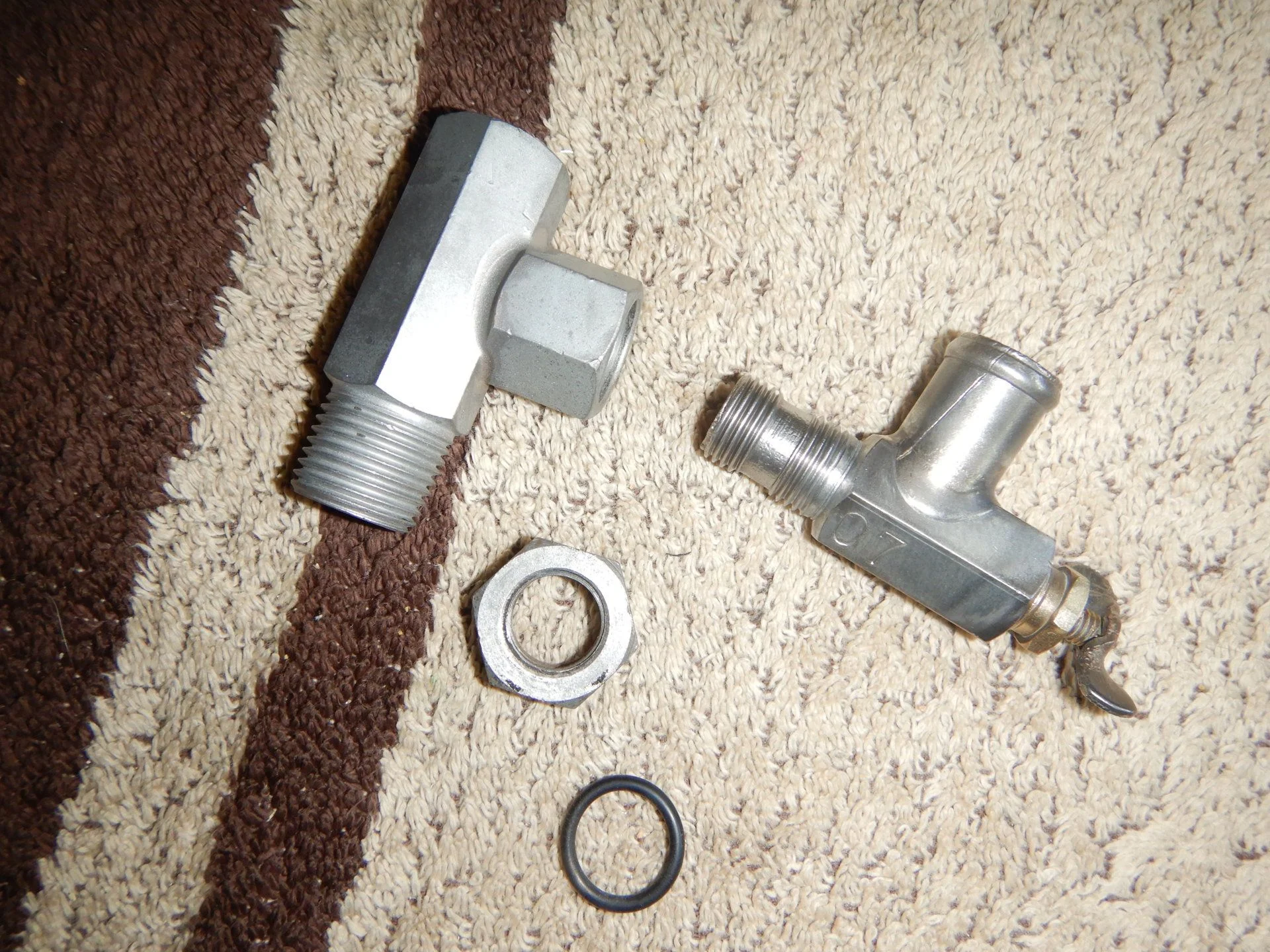

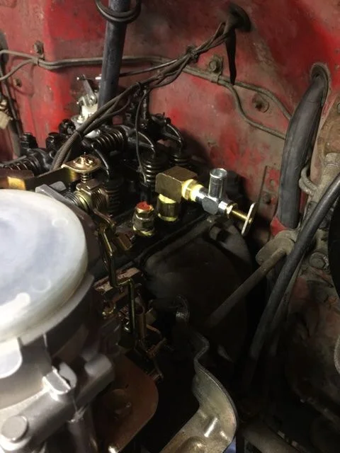

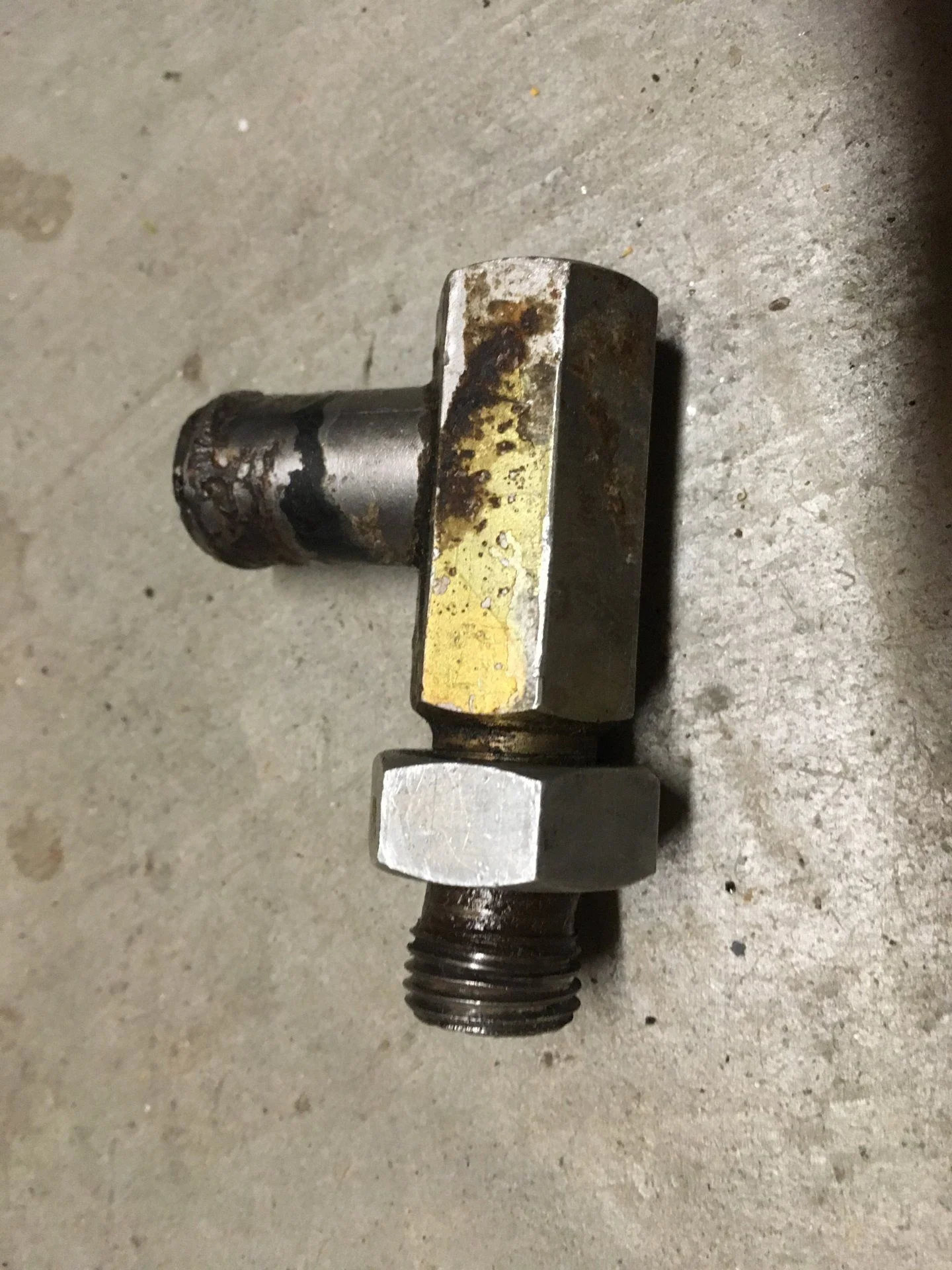

The following heater hose junction coming off the fitting located in head of my 1977 FJ40 seems to be unavailable from Toyota. Has anyone found a substitute or workaround for the hose junction?
Thanks!
Jeff

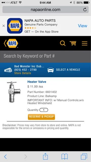

This may work, but I'm not 100% sure. > click here <
I actually have one of the above because I thought I lost the original OEM part. But I found it and reinstalled it.
