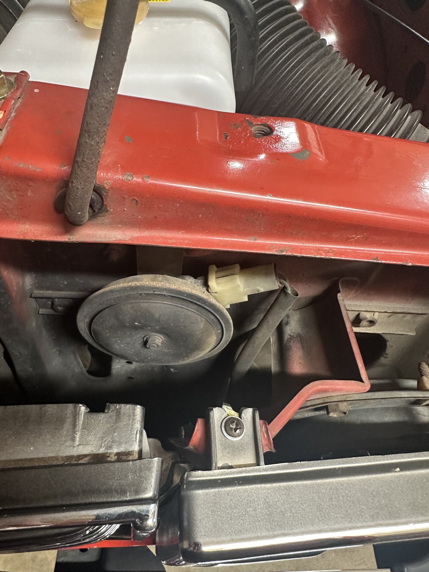

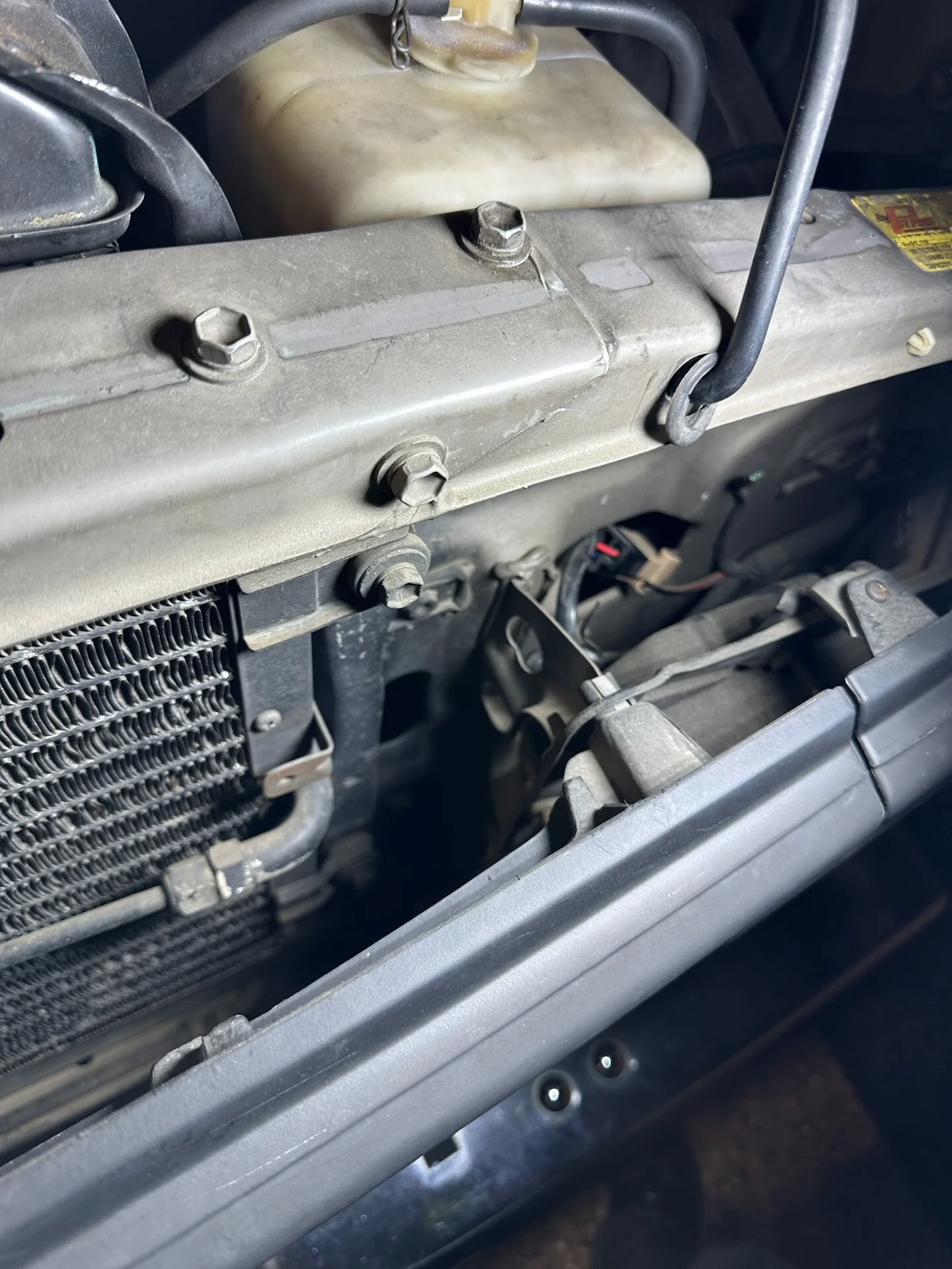

Hi All,
Can anyone tell me where the horn location should be under the hood? Should be a simple find but obviously not so simple for me. I tried the horn fix at the steering wheel with the .22 casing but it did not work. I went to test the fuse and it is fine. Then went to test the horn and can't even find the horn. Any help is appreciated.
Rudy

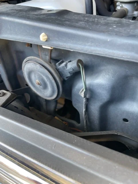

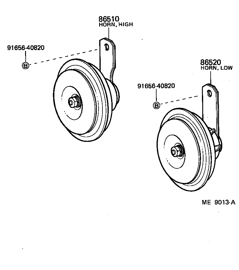

There’s two of them: a Low Tone and a High Tone. They’re black. Bolted next to the headlights on outside of radiator support.
I am assuming it used to be in this location. Does anyone have a picture to confirm where it used to be? More importantly, I am looking for the horn wire from the steering wheel to connect to a replacement horn.
Thanks.
Thanks.
Just kicking this up. If anyone can help me find the location of the factory horn. My horn is gone and I am looking to install an aftermarket horn but need to find the factor horn wire or horn relay. Pictures appreciated. Thanks!

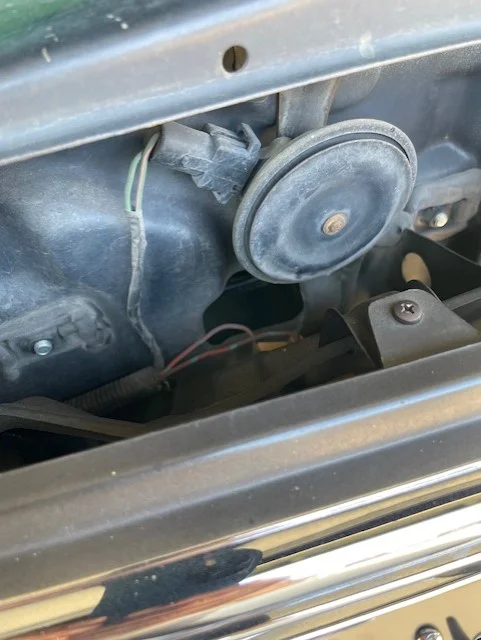

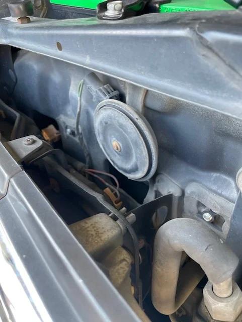

OEM Stock Driver and Passenger Sides; on an 89 FJ62

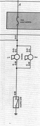

horns are negatively switched. The Green/orange wire is the hot wire coming from the fuse and the other green wire at the horns sends ground signal to the steering column once the horn switch closes the circuit. Interestingly mine would only work with BOTH horns connected. The hot wire coming off the circuit before the horns goes to the hazard switch. If your hazard switch isn't working you may want to start by checking the hazard/horn fuse first.
