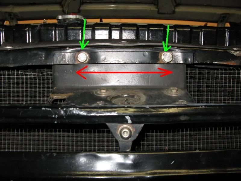

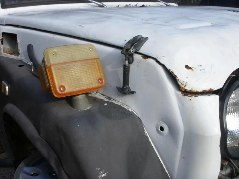

It is easy enough to figure if your hood is misaligned by leaving the hood inn the open but down position. Just look and see how the hood pinn lines up with the latch. as you can see from teh picture the hood latch pin is shifted back and to the right.

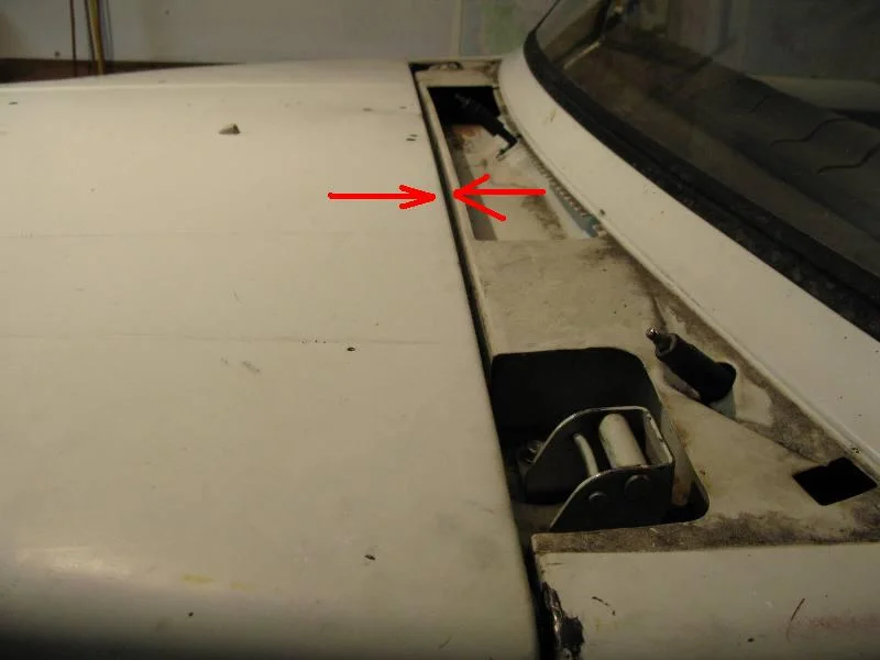

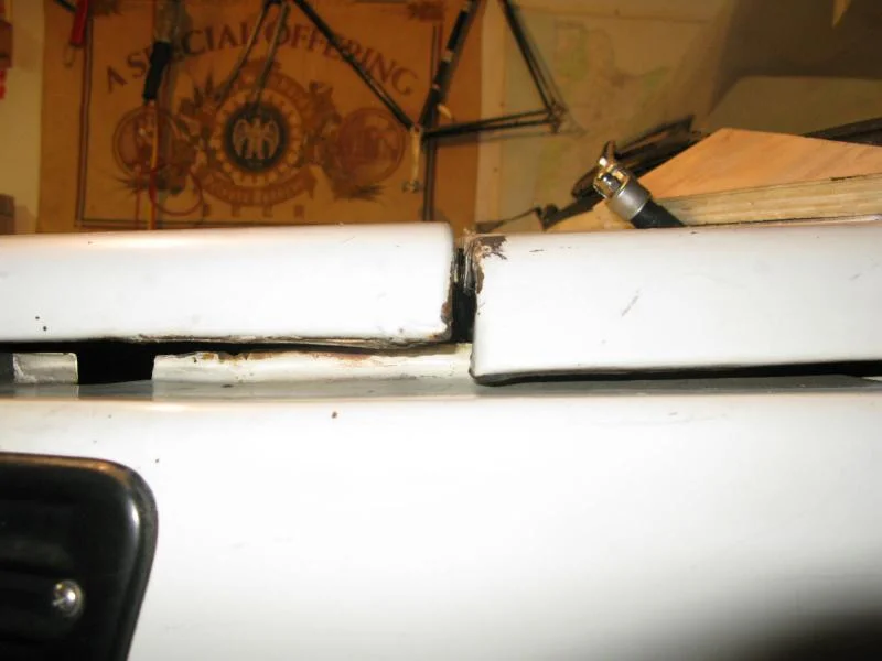

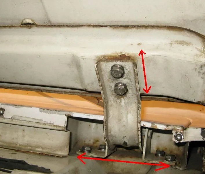

The cowl
Now, if you have just minor alignment issues you might be able to get away with just using the adjustments already shown. But, if you have really gone and doneit like I did :crybaby: You will have to remove the cowl first. Trust me, in the end it will be worth it. Good time to state what a HASSLE all this is. You will need to also pay attention to the gap indicated.

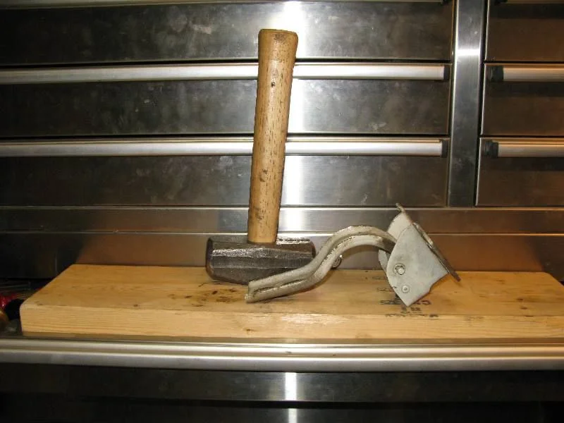

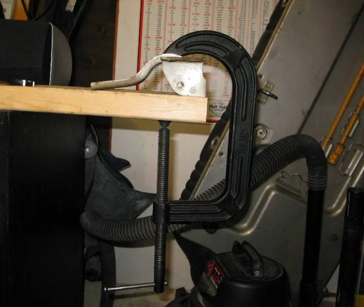

Bending the hinge
I used the biggest C-clamp I had on hand. A bigger stronger clamp would have been nice. For that matter a 10 ton press would have been nicer yet. Bend, install, repeat until the hood lines up with the cowl. After you have retored the hinge to its original arc you will have to go back and use a similiar method to align the flat piece in relation to the rest of the hinge so that it lines up with the hood. Install the hinge in place and repeat for the other hinge.

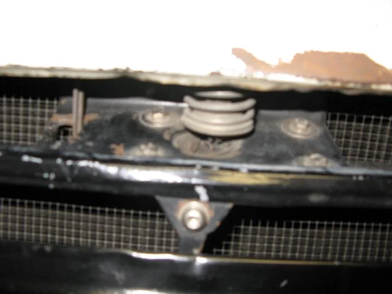

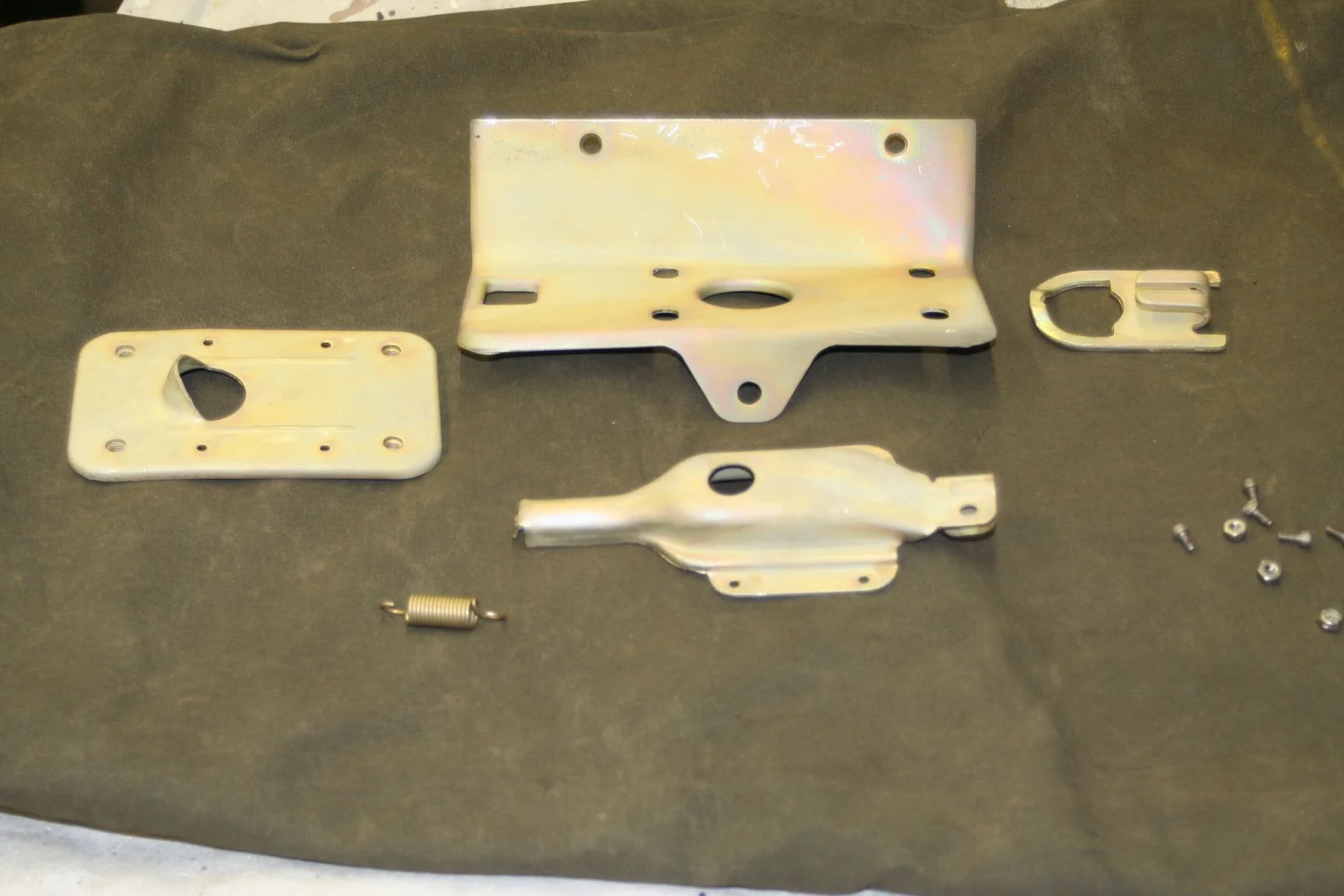

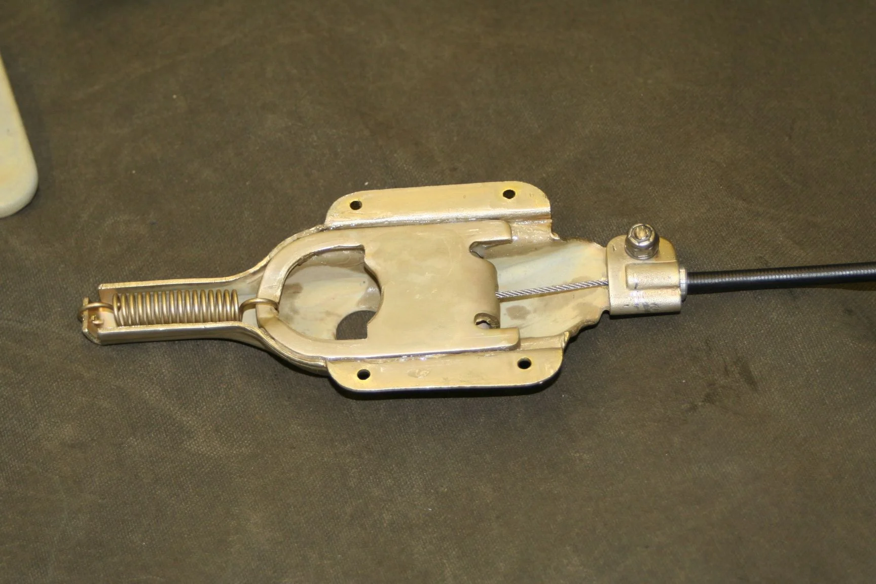

The hood latch is right up there with the black magic of the tailgate. I would suggest taking the latch apart and cleaning every part or at the least cleaning it of all the old grease and grime without disassembly. Here's a couple pictures of it apart and what it should look like together.
In order to get it totally apart you need to drill out some rivets and use small screws to reassemble, so you might not what to go that route. It does work smooth when you have all the grit out of it. Follow the above instructions on adjustment and you should have a functioning latch
