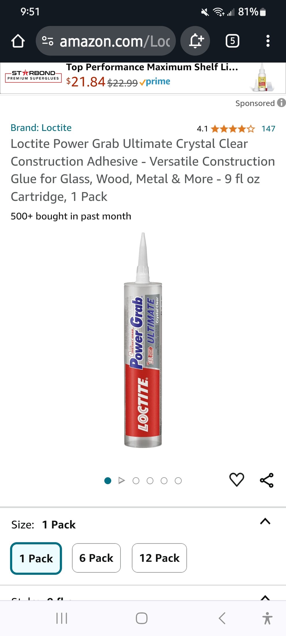

I deal with more than my own Land Cruiser 80 series and I thought it was the, rubber stoppers, and after looking at several other ones I went and replaced them on mine and a customer's and it's 💯 the separation of the skeleton and skin , I'd never use spray foam it's going to push bumps in your hood, and look bad I bought some 3M specific Automotive 2 part adhesive. When I replaced rubber bumpers I noticed nothing and was dissatisfied and knew it's the broken factory adhesive and the only way is clean it up by first using a solven and 3M scotch Brite, I'm going the route of using a multi tool and folding on both sides of blade and get ready for the proper way I'd probably clean with power purple and then the final cleaning with Wax and grease remover and then us the adhesive and weights to secure it evenly I would avoid the spray foam it's crap . Good luck with your own testing I'm going with quality products 👌

While I agree with what you’re saying.
I don’t think the power grab is the proper adhesive.
Also a bit hesitant on the PowerGrab.
There's two part polyurethane seam sealer glues made for structurally bonding metal panels in auto body manufacturing and repair 3m, Sika, Wurth, SEM
I'd also be really wary of using a toothbrush (aka, oscilating multitool) between ribs and hood skin.
I think it would be easy to do damage, to much friction, or too much force you could damage the paint on the top skin or put dents in it.
