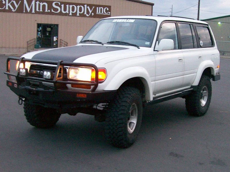

Decided to paint the hood blackout on my 80. I had done it with my last 80 and really liked the look and actual functionality of the paint. Here's kinda the lowdown on how we did it.
I had some leftover paint from last time, so here's what it is.

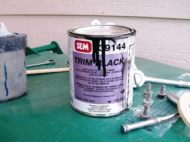

We used SEM 39144 Trim Black paint, which is basically the paint used for your trim :D
My bodyshop friend did all the work. I basically sanded and picked things up :lol:

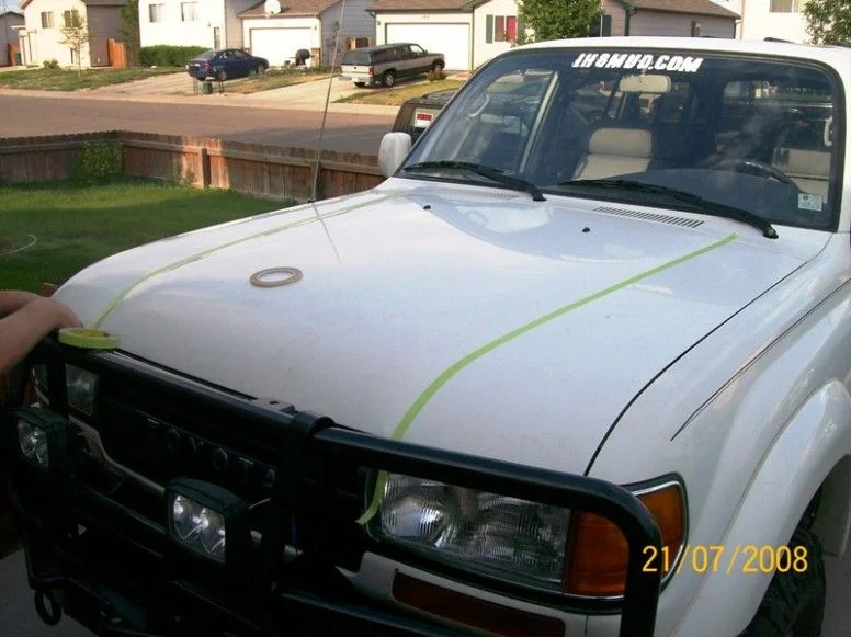

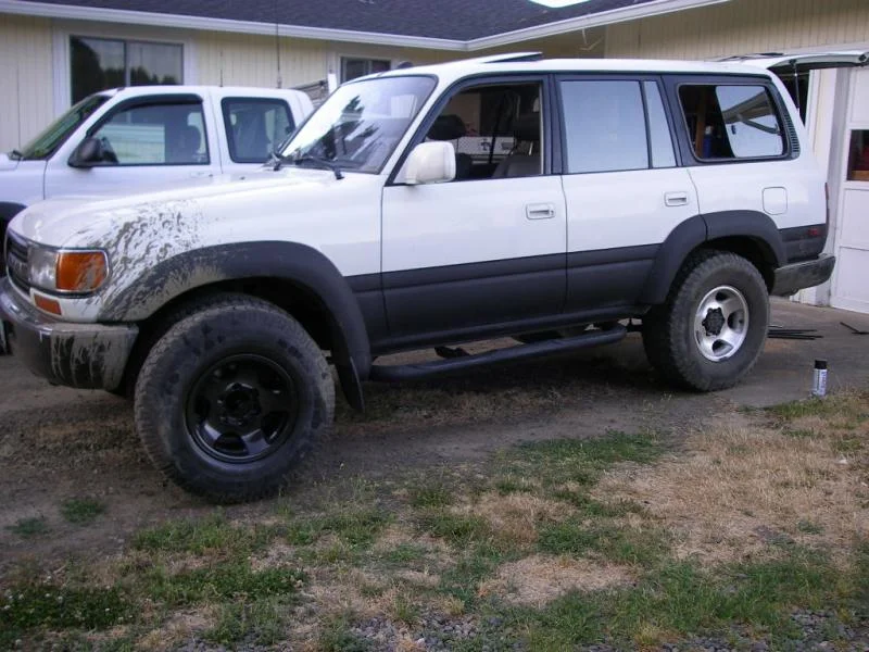

Started out by taping the lines on the hood on the vehicle, eying them to get the best look. Once we got the look, we took the hood off. Two bolts per side on the hood for the bracket, and then 1 on the hood strut. Make sure take washer fluid hose off before you take the hood off :D
Pic 1: Paint Can
Pic 2: taping lines

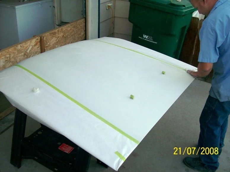

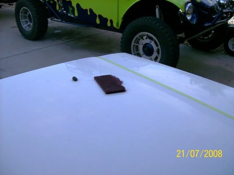

Pic 3: 3M sanding pad
After you wax on/wax off your arm gets tired. Go grab your youngest child as she's unaware thats its work and she'll enjoy sanding for you :D Be leery of state/local child labor laws when performing this step. :D
After you've sanded a little bit, blow it off and then clean with a rag and light laquer thinner.

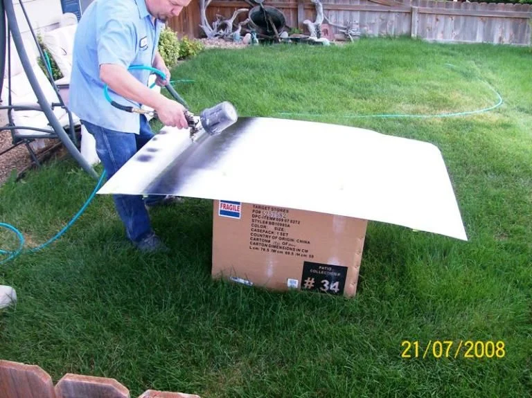

Then tape/paper the rest of the hood so it's ready for paint.
Start painting :D I couldn't tell you the mix he used, but he used a spray gun and some reducer, and then a some point during the 3 coats he used he switched it up a little bit.

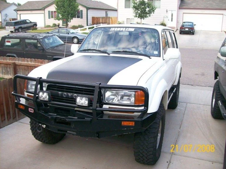

After painting 3 coats, you are ready to go. Being 90ish degrees out, the paint dries quickly. Start to finish time was 1 hour 20 minutes, and that was taking pics, 3 coats of paint and running to the shop to get something.

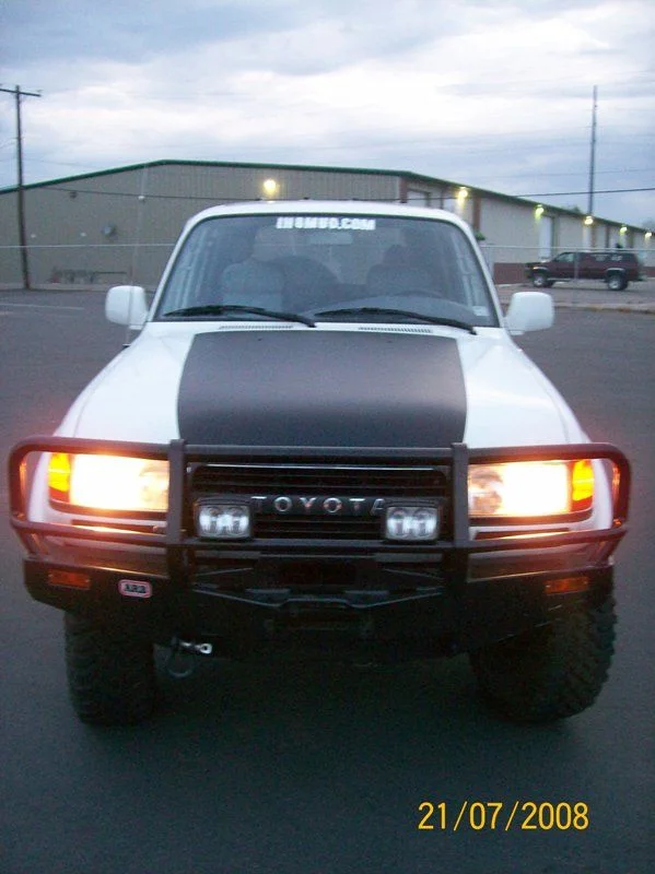

here's the final product.
And of course a poser pic.

I don't get it, why do that if you don't have lights on the roof? Just 'cause?
It REALLY helps with sun glare.
I've got a white whale as well.. my paint must not be as glossy as yours was, 'cause I never noticed a problem w/ glare.
It REALLY helps with sun glare. My hood was really shiny and anytime the sun was bright it would reflect pretty bad off the hood. This helps cut that down.

Got a white one too, I had actually been to a vehicle wrap shop to get a quote on doing this in matte black vinyl. The said about 150 to do it, and it is removable. Seriously considering that route.
A few more poser shots :D
The paint was really cheap...I'm thinking$30.00 for the quart. My friend had all the others, so I've done 2 hoods and still have paint left for probably another hood.
