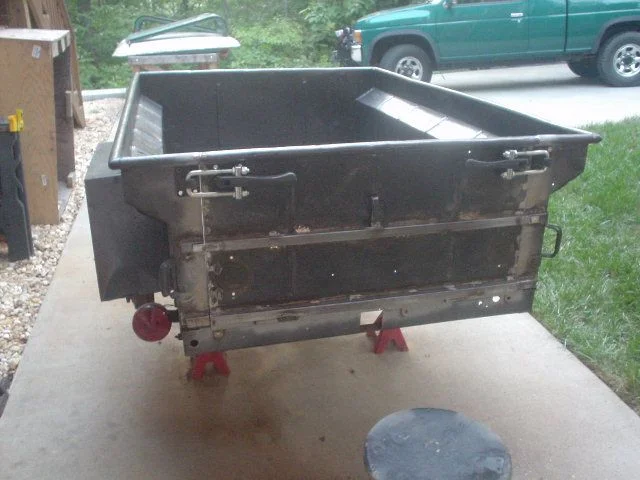

I am planning on cutting in a tailgate this fall and I am researching the different methods people have used cutting their tailgates and keeping them closed. Can you post up some pics of the the different ways you have accomplished this and the latches and hinges you have used.
Here's some pics of the hinge , latch and the finished tailgate

Nice, where did you get the latches? They look like OEM Toyota.
Thanks.
My son works as a Toyota tech and ordered them for me. The only ones still available are the passenger side. I took one and modified for the drivers side. The piece that they hook to I fabed myself.

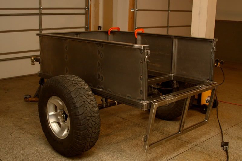

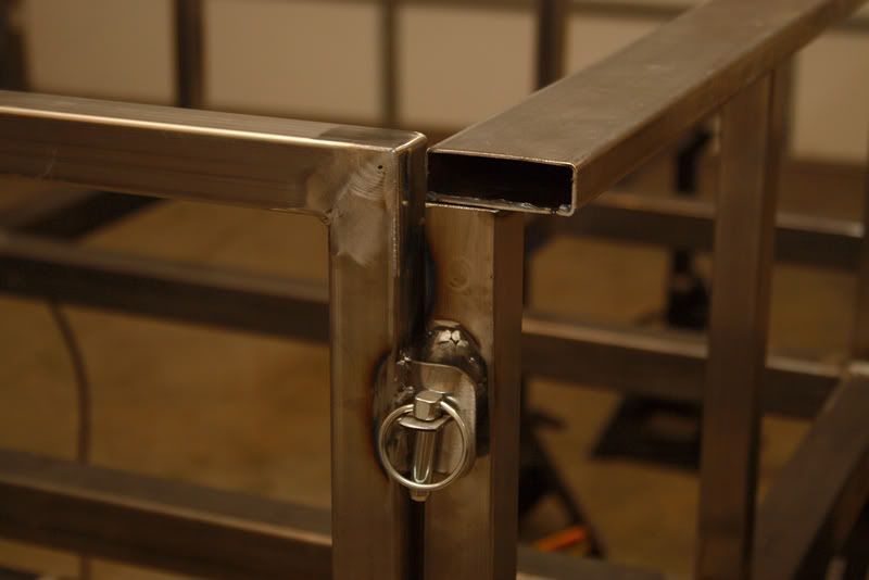

I just posted these in my build thread....so I feel like an attention whore:o
Old style windshield latches that I had. Adjustable and they pull the sides toward the tailgate. And they were "free"....kinda. Well I had them on hand.
