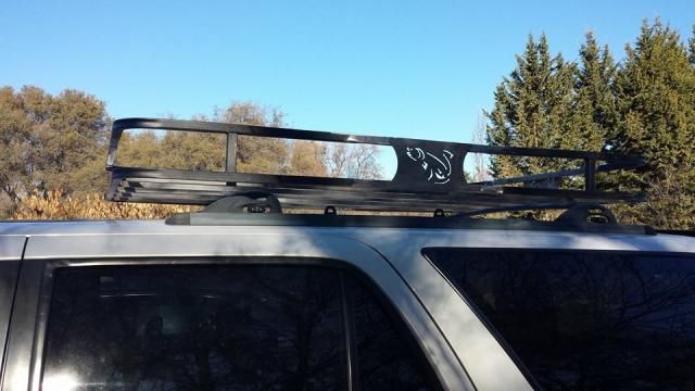

Got it mostly finished and gave it to him yesterday. I'm pretty happy with how it came out. There are a few minor things I need to fix before paint, but it came out cool. Got to build some mounts this weekend now that I have access to the 4runner. It was hard enough to sneak measurements on it without him knowing, let alone take apart the ski racks to build mounts.
Made him a hitch cover to match it too. :)

great job, where'd you source your bends?
I like the fishy gussets.

Can you post a close up of the trout cutout? Looks really good.
I don't have a bender or even know anyone who does... so I cut up a hitch mounted cargo rack for the corners. I have another one I plan to do the same to for my cruiser.
That's what I thought, did you see mine from a few years back or did you have the same epiphany at Harbor Freight? I actually owned a bender at the time but they wanted too much $ for the square dies that would only be used for one project.

No, I didn't see your's. I just had bought one of the cargo racks from HF to use on my roll bar and started looking at it thinking... that would make a nice looking roof rack too. So I bought two more for the cruiser and for my parent's 4runner. I figured I wasn't the only one who had ever thought that though.
I just finished up the mounts for it a few minutes ago and am going to over there after I eat something and get it all mounted up and painted. :)
Here is the fishy...
The mounts are perfect. They came out great.
The height is right where I wanted it.
Going to cut down the bolts, I just didn't want leave too little. It got to dark tonight to get it welded onto the mounts, but I am happy they all lined up right and worked well. Exactly what I wanted. :)
