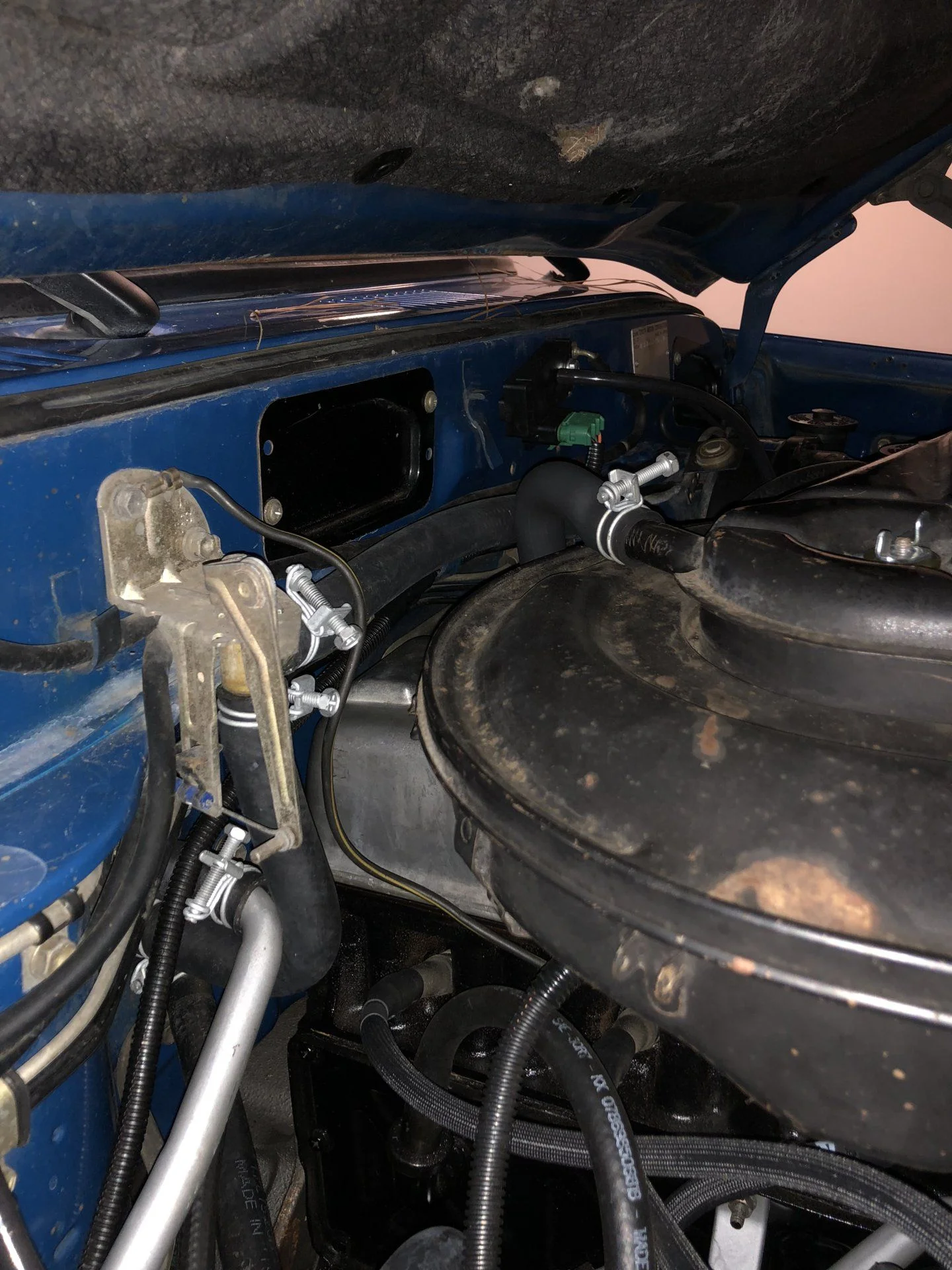

See I was thinking that you may be able to do something like @maxbob002 did and use the Mr. Gasket spaces to run factory cleaner on a 60. I haven't looked at the diameter yet though. He setup looks super clean in person.
I used the Mr. Gasket air filter adapter set 6411G with an additional 2" spacer. Had to sand down the lip but it fits the TBI and 2F breather well. Are the carb sizes the same between generations of F motors?
...Are the carb sizes the same between generations of F motors?
I believe there are at least two different sizes between the F & 2F.
Can you post an installed pic?
I used the Mr. Gasket air filter adapter set 6411G with an additional 2" spacer. Had to sand down the lip but it fits the TBI and 2F breather well. Are the carb sizes the same between generations of F motors?View attachment 1769198

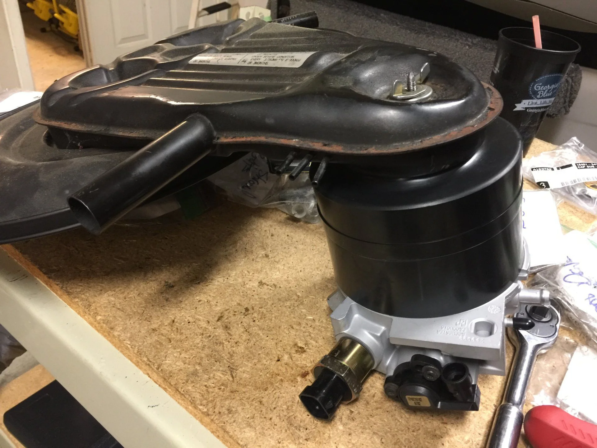

@FJ60Cam @maxbob002 setup is clean in person installed. I am guessing that setup he used would work to adapt the Sniper setup as well to an fj60 factory cleaner because it is a 5 1/8", but if it is offset that would throw a kink in the plan. However we are going to find out. I've order all components needed on order and the Sniper is in route and will be here Tuesday! Then it will be time to mock it all up and see.

It looks like it would shift toward the firewall an inch or so. Maybe just extend the air cleaner brackets?
