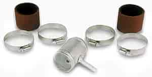

Also if you do not want to modify the tank, you can T into the filler neck.

I really like the idea someone else posted of the additional connection on the fuel filler hose. That should work too.

I actually have not installed it. I bought a new tank but there is no return line and was looking to see what was available. Saw the filler neck return but wonder if a line could be soldered in and direct the gas down to the tank.
