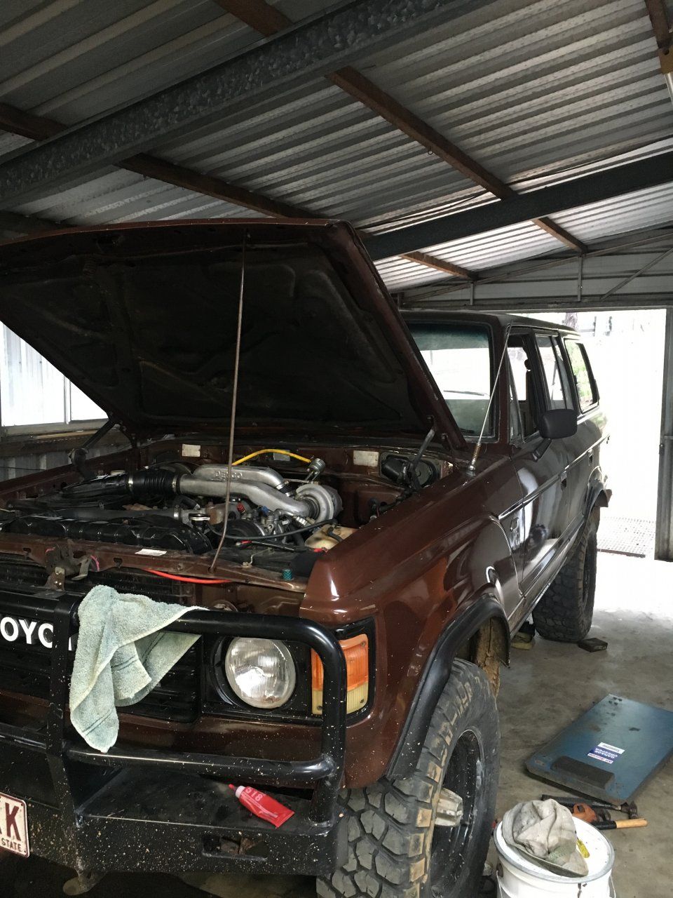

Hi I recently bought a 1982 hj60 fitted with 2H diesel with deco turbo kit. It had the 4 speed gearbox fitted until I took it for a drive and realized that it needs a 5 speed desperately for highway driving.
I bought what seems to be a h55f 5speed out of another hj60
Everything has gone in fairly easy except after the gearbox is all bolted up to the engine it insnt sitting straight in between the chassis rails
The crossmember doesn't line up with the mounting holes on the bottom of the gearbox and the gear stick isn't centered
Do I need another crossmember made up or is there one from another model that I can put in ?
Cheers

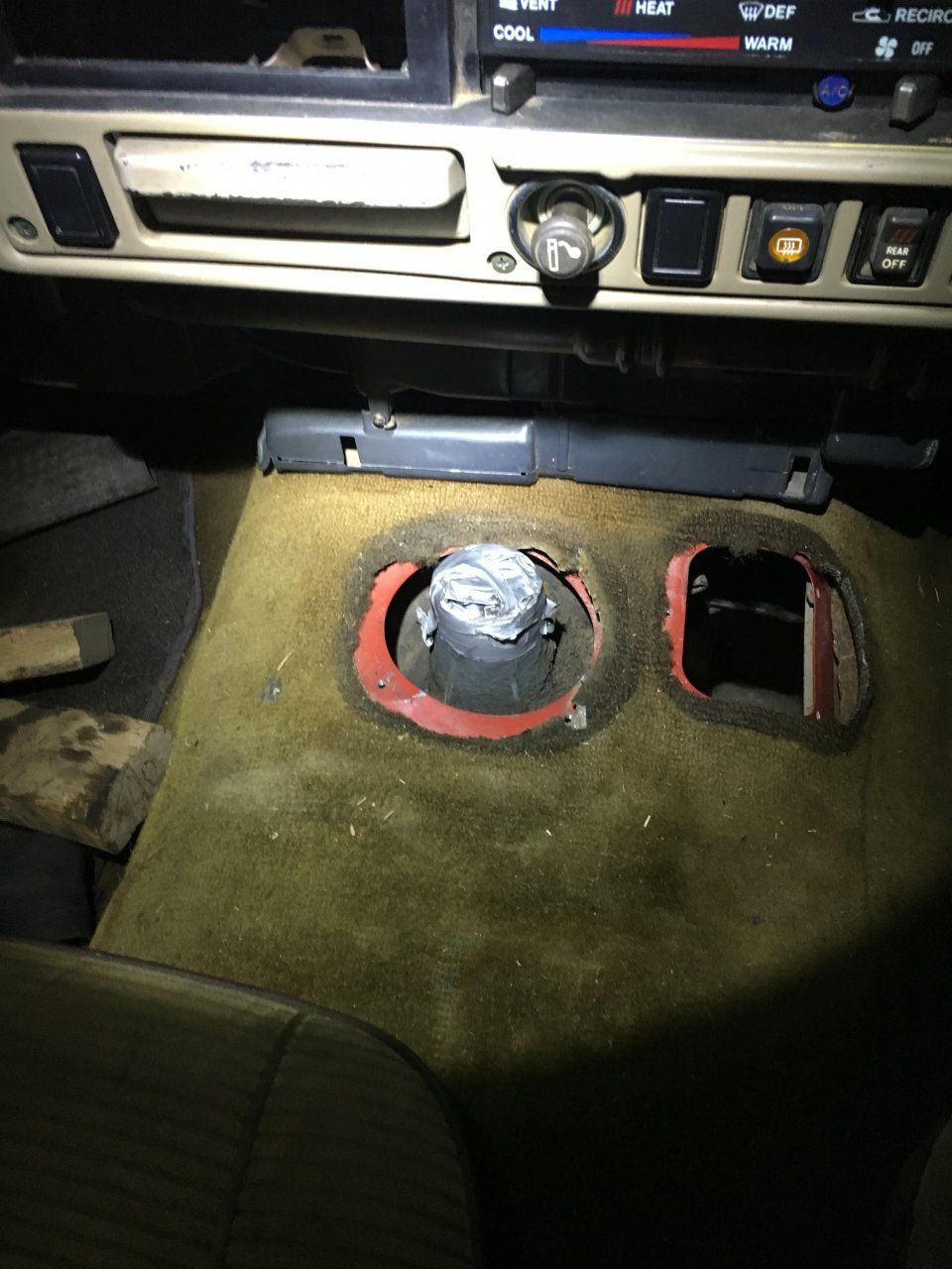

Yeah I tried that it still doesn't line up and the gear stick is right on the edge of the hole in the trans tunnel
This is a pic of it bolted in and it can't be pushed over to the left anymore than that

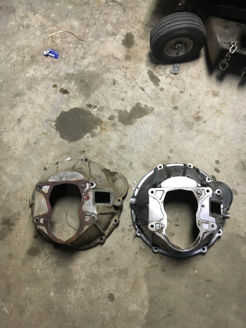

The post 1985 bell housing turns the transmission/transfer 7 degrees or so. The 1987 bell housing I used in my swap (picture) was stamped 3f if you have the two side by side its clear that the mating surface on the trans side is turned. Im guessing the bell housing u have in now is 1986 or later. Hopefully your other one is still on hand.

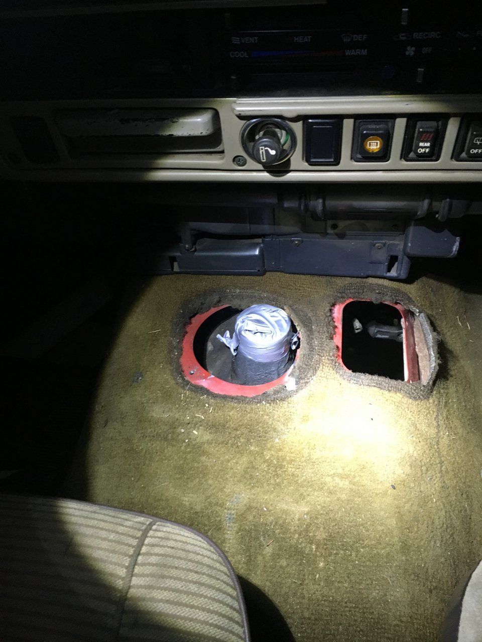

Pulled the gearbox back out and swapped the bellhousings over and it all lines up perfect gearbox is straight and centered
