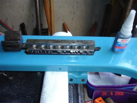

Interesting that your holes for the pins on your "Toyota landcruiser" badges appear too large.
But that isn't a problem if you do what I did. - I just used glue to hold them and used the pins (the ones that hadn't already broken off that is) to hold the emblem in the right position.

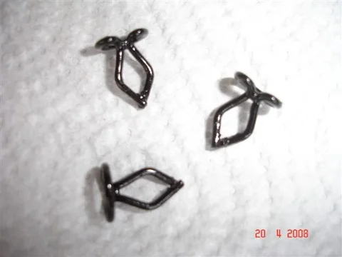

Also - Are those clips that hold those little bits of weatherstrip stainless? (If so, where did you get them from?) I had to paint my steel ones with POR15:
Tom,
those clips I put on the aprons are oem and cad-plated.
As for the emblem, your solution for fitting the ones with the smaller pins to the hole is a good one.
I figure toyota made the pins bigger as the early ones (1980) were more fragile. They usually don't add beefiness to a part unless absolutely necessary. I thought about gluing mine on for a while as well, and chose another route.
I will try to sell the ones I have (anyone with a 1980 out there looking for emblems?), and have ordered the correct ones from the local Toyota dealer. SOR was cheaper, but then add in the s&h and it's the same or more money. The price out of Japan was higher than my local dealer. About $50/ea.
