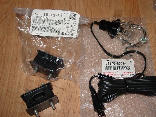

A very juicy package arrived today, and if any of you are as excited by shiny OEM bling as I am, you're going to quite possibly enjoy the following sets of pics.

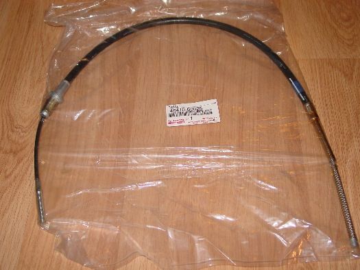

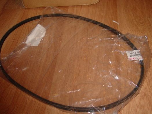

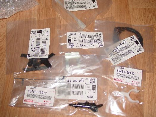

Here we have the goody box, and the a/c-specific fan belt, and the somewhat lucky find of a parking brake cable for LHD HJ47

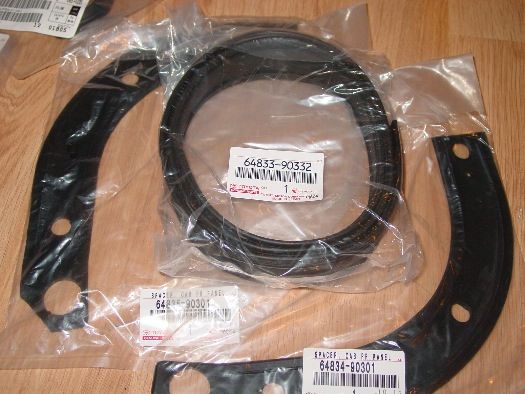

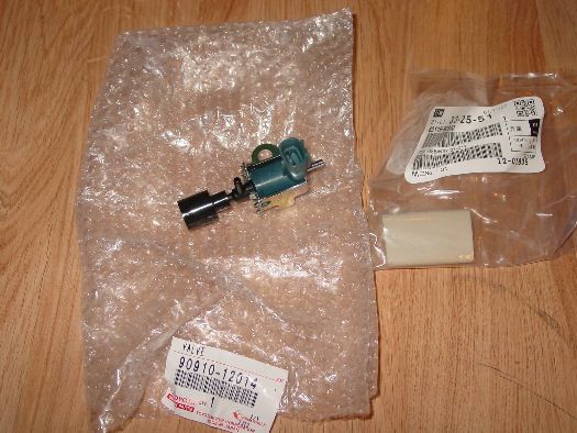

Last two - the special vsv for controlling the intake butterfly, the 'cushion for the roof panel...

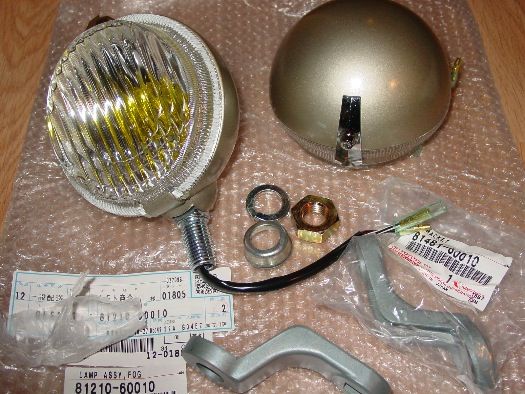

... plus the fog lamps and 'holy grail' lamp mounting brackets. :bounce: :bounce2:

First, I couldn't resist seeing how the fog lamps would fit up, given the winch parked in place. I put the brackets facing back, and mounted them in place (with 7/16" bumper bolts) using the more forward of the two rear holes in the bumper gusset. The bracket nicely covers over the mounting bolt in the rear hole, and there's plenty of clearance on the right side where the winch operating lever swngs back and forth.
I'm really happy I bought the factory fog lamps - they are well made of quality materials (since they're from Japan, not China), they look great, and they fit in seamlessly. Worth every yen.

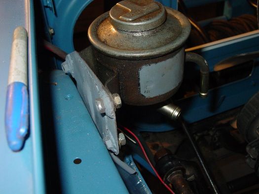

Here's a couple of pics of the p/s reservoir, showing the location I chose to mount it as well as the bracket I have made for it. I can't remember what Toyota I found the reservoir in. The bracket is nearly complete - it needs and additional support on the upper side to stiffen it up.

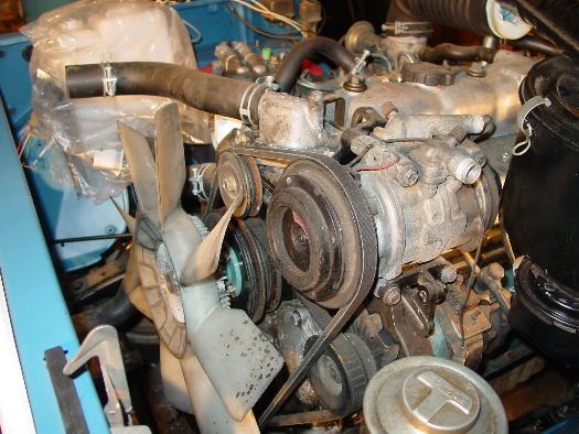

The third pic shows the the engine in place, and the new fan belt in place. It was a bit of a guess as to which Denso belt might work, as the a/c compressor and mounting bracket is out of an '88 HJ61, but this one turned out to be the right length.

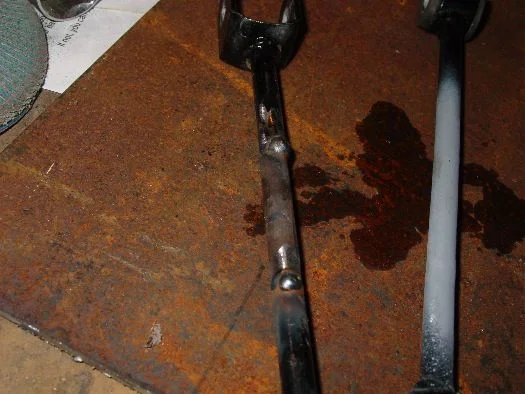

A few more shots of the engine sitting in place. I hope I don't have to pull it out again. In the second pic you can see how long the pto shifter rod is, coming out of a truck with an automatic transmission - I need to chop 90% of the rod away to shorten it to the correct size, something I plan to do tomorrow.
