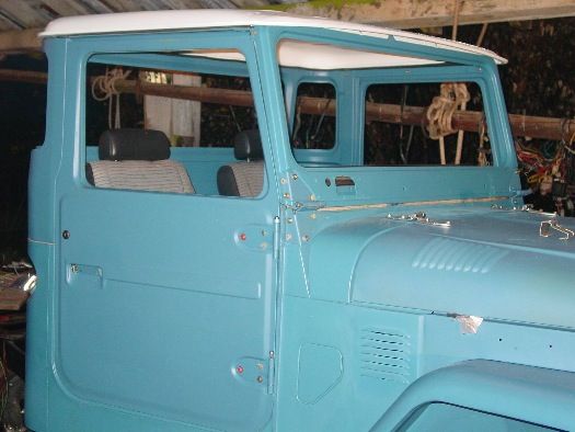

The painter Mark wanted me to put all the panels back together with the cab before making decisions on using the plastic filler. I am finding I really like the matt finish of the primer, and in fact am leaning strongly to using a matte blue finish paint, along with matte white for the roof and bezel. It would hide a lot of imperfections, and for a working truck what do I need glossy paint, which I'd be worried about scratching, for? Low maintenance, no worry, less fussy body work - - it's adding up for me. I think I will definitely be going with a darker blue than the primer.

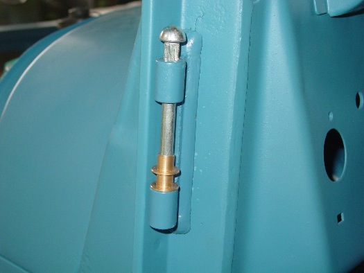

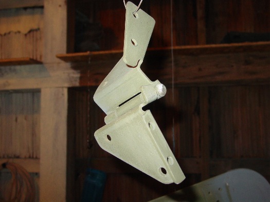

Yes, I know the brass hinge pieces are not stacked correctly, but my mild o.c.d. has to stop somewhere.

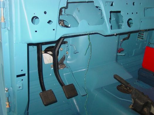

It's nice to get the pedal bucket and pedals back together.
The parking brake is also in place for the first time, recently, by some sort of miracle, to my surprise I located a LHD HJ47 parking brake cable in Japan, along with a host of other OEM goodies which will be on their way to me soon.

I'd go with glossy paint just because it's "smoother" and won't hold onto the dirt as much as a flat finish will. It's just easier to clean, is all.

it's not flat, it's matte. According to the painter, there will be no issue with increased tendency to pick up dirt in such a finish, and no difference to a glossy piant in ease of care. Frankly, that's the issue in a nutshell - I'm not wanting to fuss and care over the paint. I expect it will get scratched and dusty and I doubt I will spend oodles of time cleaning and waxing the truck. Not one of my habits or inclinations at present, nor has it ever been. I can see the need to pressure wash it frequently, but in that case my concern is more about what counts - the chassis and undercarriage. The sheet metal is like make-up. While I want it to look presentable, the real bones of the Landcruiser, and the source of its virtue, lay for me in the frame, axles, suspension, motor, etc, and not in the thin veneer of metal draped loosely on top. For that, the paint quality I'm most concerned about is toughness, not shine.
And hey, it looks like I'm keeping good company in the style department too, as the new $1.4 million Lamborghini Reventon has a flat metallic paint job. If matte is good enough for Lambo will be good enough for me, though they can keep the metallic (maybe...hmm, now I'm thinking about a matte blue metallic...)

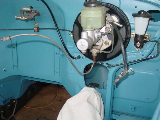

For some reason lost to me the 80 series brake m/c has this additional outlet line, only about 14" long, on the rear brake end of the cylinder. The junctions that it originates from is three-way. I imagine if I remove the 3-way union altogether, and get rid of the short pipe everything will be fine - with a proportioning valve built into the system that is. Run the line directly? I'm not sure though, and I'm curious to know what the short pipe is supposed to connect to - - anybody with an 80 series out there who can tell me?
[EDIT] I realized that the extra pipe was connecting to a component in the ABS system, which needless to say I don't have. So, pulled off the pipe and mounting bracket altgether.
I'm waiting on the painter for lots of parts, both large and small, but mostly small. I'm nervous to see what the fit of the doors will be like. The cab/apron/fender connection, while not perfect, is pretty good, and goes together easily. There are issues with the two center bolt holes on the upper cab section, which don't quite line-up properly.

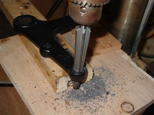

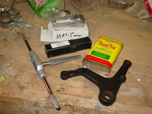

I've made contact with a 4x4 shop in Brazil so things are moving in a positive direction. I decided to put my new tapered reamer (1/10 or 1.2"/12") to use on the center arm. This makes room for the 4x4Labs relay rod with fj80 TRE (same size as 60 series).
At first I planned to use the tap handle, but I found the results poor, so I tried the reamer in the drill press, which gave perfect results. You have to be careful to judge the depth on this and not overcut it.
