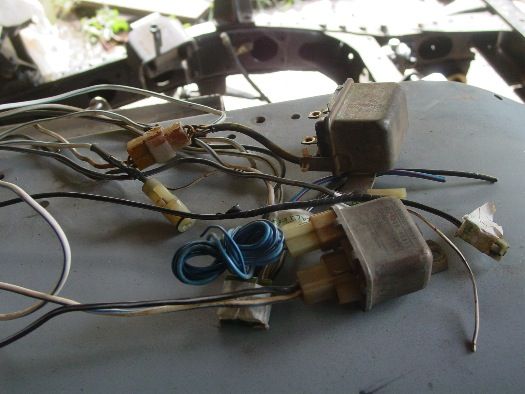

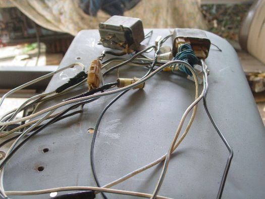

With the wiring harness, is that bits of the original and bits from a 60?
I ask because mine is really, really cut up and a mess--so I'm still debating what to do about it. Please take many pictures. :)
Dan
That picture is the 'guts' (the main leads to the main relays) of the original (?) 47 harness, including the glow and starter relays that mount inside the passenger apron, with one wire end fitting changed to a 60 series type end. I'm planning to use as many of the 60 style o-ringed round terminals, in preference to the the non o-ringed 40 series square/rectangular types. I've pulled 5 harnesses apart to one degree or another, so I will try and solve the wiring with the best parts possible. So far, that means a 60 series fuse panel in preference to the 47 one, and a 60 series relay and control module panel where before there was only a separate bulb check relay on the 47's system.
And I will take lots of wiring photos as well.
I've already drawn up a detailed wiring diagram but won't post it up quite yet. I want to make sure it works first, and I need to figure out the wiring details for the VSV on the engine. I understand how it works, and believe that I have to put it into the main 15a. 'engine' fuse line of wiring and relate it to the alternator circuit.

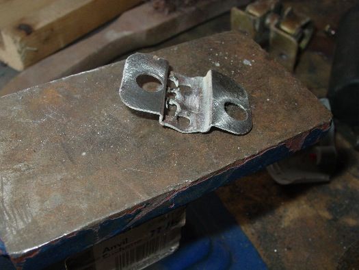

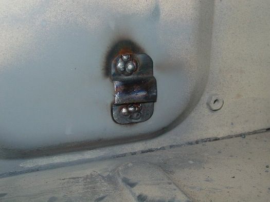

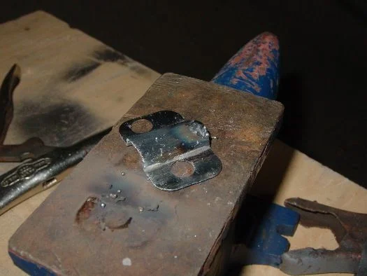

then I dealt with this little clip on the inside of the cab at the back. It would have looked bad to leave it with all the holes. I have no idea, by the way, what this clip is for, though I imagine some sort of strap going through it.
Of course, it was good to discover and eliminate the small amount of rust lurking under that clip

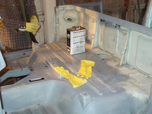

next set. I cleaned the lower interior seam of the windshield frame and sloshed some rust-killing/converting chemical along it. The windshield and bib are both de-greased-sanded-de-greased now, and ready for epoxy primer - as is the cab, finally!

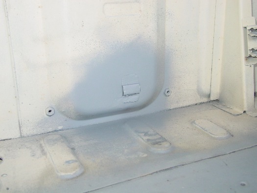

The funny thing about a coat of primer is that it helps show up all the sheet metal imperfections in a hurry. I should have used more powerful lighting around the cab in the welding room to get a better handle on surfaces.
That said, I still don't have enough precision in my control of the weld zone and the surrounding metal to be able to get the sheet metal joints to come out perfectly flat. I know it's possible, but I don't have the knowledge yet.
The top of the cowl looks the worst, and will require the most fairing with synthetic filler - more than the 1/16" max. for which I was hoping. I can take solace in the fact that the rust has been chopped out and there is solid metal welded in.
The guy doing the painting, Mark, left the paint open overnight to let it thicken up a bit, and after that he still felt that the AWL Grip paint had more solids than the PPG product I picked. The AWL grip does not come in blue however, only battleship gray, and it might be less expensive. 3 liters of material went on the cab today, so it looks like another gallon of primer will be required.
