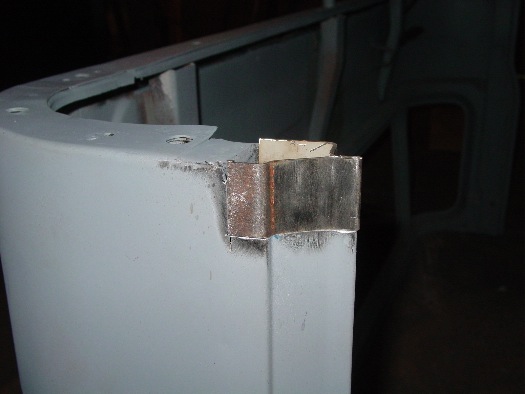

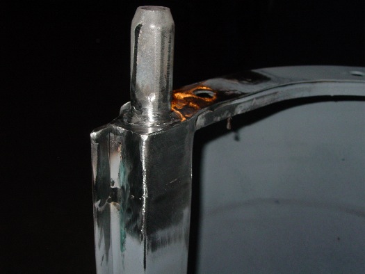

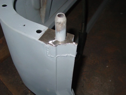

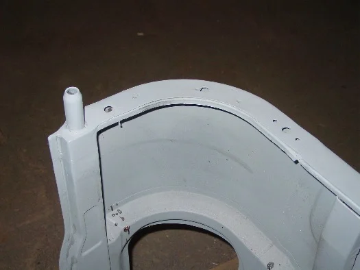

working on the driver's side corner, which was trickier because the mounting pin was no longer attached. I decided to use the hole in the little piece of baffle inside the box-section as a locating point for a locating-pin...
another set of three; in the third picture I am drilling the holes for mounting one of the rubber corner strips that fit between the upper cab and the main cab section. They clip into place on the lower edge of the upper cab. I picked up a few metric drill bits today so as to be sure that i got the hole size right - which turns out to be 5.5mm.
The upper cab section is now fitting just fine, and is 99.9% completed, as far as rust repairs are concerned. I've decide to take the plunge and buy a new set of OEM rubber strips, though they are a bit spendy.
I drilled and re-tapped a broken bolt in a hole that I discovered on the top edge of the upper cab.

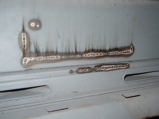

A minor grinding session is all that remains (need a couple of fresh flap wheels) to tidy the weld-repair areas up a little more.

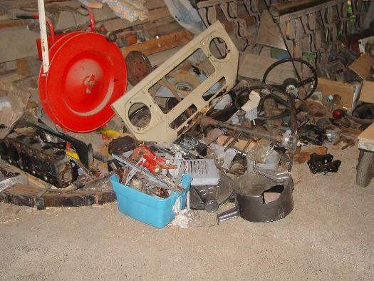

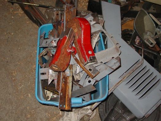

hmmmm....you going to chuck that rusty square bezel bib???:grinpimp:
Oh yeah - come and get anything you like out of the discard pile.
I have 3 other bibs as well, another late '79~'84 (in better condition), an earlier one, and the really early one with the marker lights. Might be time soon to throw a few items up for sale.
cool, well I want to come check this thing out in person for sure ( and measure the rear window glass while I'm at it if I can....)
, I'm just thinking about putting a square bezel bib on my 45, as it's mostly bj42 anyways...
I have this week off, so I'll give you a shout

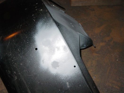

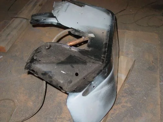

-got more involved that anticipated, and spent four hours, concentrating on the passenger side fender. I welded up a couple of minor metal tears, cut out the sheet metal to clear the steering box (on a RHD application), and welded into the same place a new double-bent panel to make the fender look more like a stock LHD one. Then I welded up the hole that the stock wiring takes as it heads out from the engine bay to the fender-mounted turn signal. With the 70 signals, I no longer require those holes. I'll do the same to the driver's side fender tomorrow.

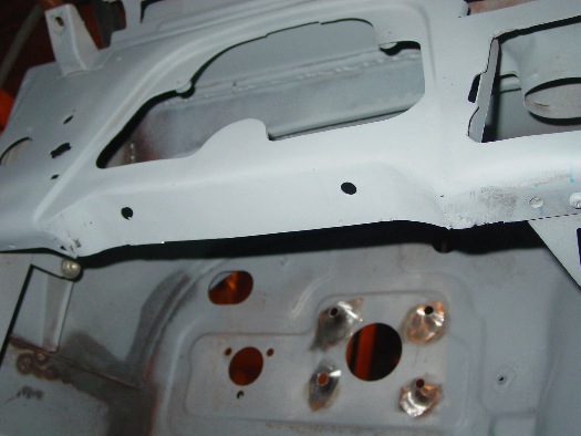

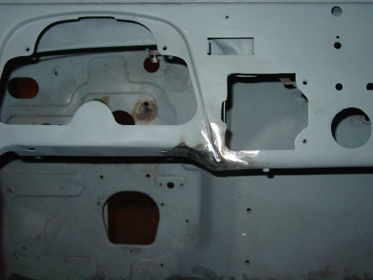

I also took care of the welding-on of the a/c switch plate, along with the mounting tabs for the relay cluster panel. It was satisfying to take care of the inside of the dash, in the spots where the previous valance patches did not have full weld penetration, or I had been unable to fully complete the welds from the outside
I'm thinking of putting another 2" hole in the dash, next to the hours meter to fit a pyrometer...

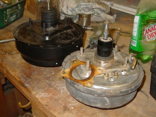

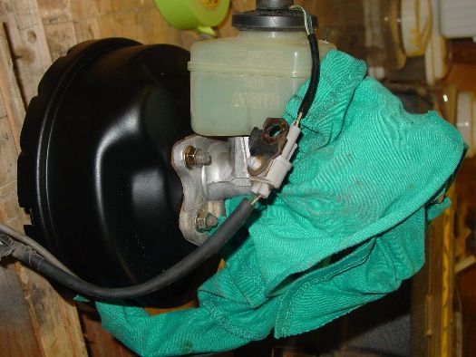

Finally, I fitted the brake booster and m/c to the firewall, and while it did fit okay and clear the clutch m/c, the rod connecting to the brake pedal was over an inch too long. So, I'm going to undo a little of my previous work and refit the original booster with the 80 series master cylinder attached. This means re-welding the mounting holes and drilling the old ones back into existence, about 20 minutes work. I wish I could have the 80 series' shiny black booster, but I didn't want to get into cutting the rod and trying to cut new threads with a die, or taking the booster apart (how? - I don't have the SST for that job) and seeing if the earlier rod would fit in the later booster (unlikely). A further option would be to locate, or have machined, a 9/16" thick spacer to move the booster away from the firewall, but this has drawbacks as well.
Also, following a conversation this afternoon with John at E4 Auto, I'm thinking that the larger 80 series booster, coming off a vehicle that weighs at least 1000 lbs. more than my rig, might provide a bit too much power boost for my needs. That's already a small concern with the 4Runner calipers I put on the rear, though I'm confident that a proportioning valve should take care of that. We'll see when we get there at least.

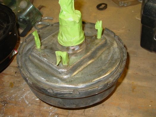

Wrestling with the center-arm rebuild took 2 hours yesterday, while the cleaning and painting of the brake booster was more straightforward. I used driveline bolts to secure the center arm pivot in place.

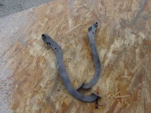

I media blasted the new brake and clutch pedals along with the gas pedal. In the third pic you can see how the gas pedals from RHL/LHD cars are not quite the same.
In the primered RHD one, the main pivot is below the bend in the arm, whereas in the LHD component, the pivot post is located above the bend in the arm.
