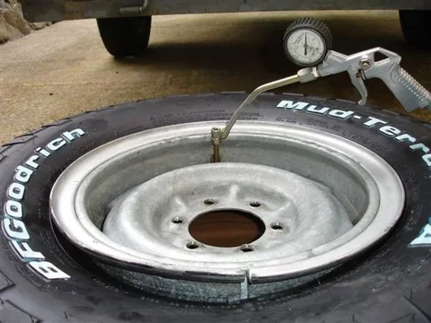

hook one end
stand on that end and use your heel to work the ring out and down.
once the last bit snaps then add air slowly.
make sure you keep an eye on the ring as the tire inflates
(i have never had an issue but just to be cautious)
then once you have the proper amount of air in take one more look see at the gap.
i usually use a rubber mallet and hit the ring as the air is going in to make sure the ring seats properly but i am not sure if this is good practice or not.

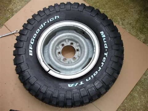

To get the lock ring back in place, just start one end of it, get a few inches in and then step on the rest of it with you in some sturdy boots. Keep one foot on the already started section and use your other foot to advance the portion of the ring in the rim. Thats what I did and it worked well, the bead set right up very quickly, literally 20 seconds to put the ring back in.

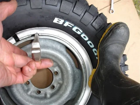

I use a tyre-lever as well as the heals of my boots:

Wearing a good pair of boots, just stand on the tire while you put the ring on so the lip of the tire is out of way! Use your other foot to work the ring down onto the ring. Simple stuff really.

I have never used anything other than the heal of my boot
