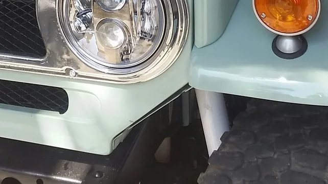

I've finally got back into the shed to do some more work on the '45. I have finished adding fresh metal to the rusty guard but it has been so bent in the past and straightened again that I'm having trouble getting the flat bits flat. This worried me about cutting them up more and adding a strip to widen them si I had another go at getting the fibreglass guards to fit.
After some time and many new holes the drivers one does fit nicely enough for me. Now I have to consider flares again, or narrower tyres, or carry on with the steel guards....
I've got the front end fitted up now apart from the bonnet wich still hasn't been painted. The front markers need connectors fitting as I need three way ones instead of two as I have modified them as indicators and marker lights.
The passenger door is built up and fitted apart from trim and the drivers is waiting for its new weatherstrip.
I glued the strips on with contact adhesive that I thinned down with acetone so I could brush it on cleanly but it was still a difficult task to keep the seal pressed right into the corner of the door frame. I'm getting another pair of hands tomorrow so hopefully it will go on easier :) I hope the seals settle in, the passenger side is really hard to close now even with the catch plate as far out as it will go!
To get the panel fit right with the fibreglass front guards I have ended up with a gap between the front of the old inner guards and the radiator panel. I think I will make up some 12mm spacer blocks to keep the panels parallel and fit some led strip light to the front of it to use as day running lights. I'm in two minds about the LEDs I'm not sure if it will look too odd or not.
I have decided to not fit the 33 12.5 15 tyres on the alloy rims and get some 235 85 16 AT's on silver steel rims instead.

Looking real nice there ....:clap:
Those early-style blinkers look great on your 76 and I think it's a good idea to use them as marker-lights as well. (When you indicate at night, will that marker turn off and start blinking as an indicator instead? The LED markers on quite a few of our Wellington buses do that.)
I'm guessing you used Rare Spares for your weatherstripping. If so, years on (after I used it), my doors still require a good solid push to close and my adjustment is still "out to the max". But having said that, I still prefer it to OEM (which is too soft and flimsy for my liking and much more prone to deterioration and to allowing door-squeaks while driving on rough roads).
Did you use F2 contact adhesive? That's what I used and I have the feeling that a more specialist product (such as the "IC-2000 20-45 second rubber-toughened glue with Insta-set accelerator" sold by Cruiser Corps) would have been more reliable and easier to use (although it is an eye irritant and probably more "nasty").
I'm not sure about LED strip lighting either..
235/85 R16 are the same tyres I run but I prefer MT rather than AT. BFG-brand MTs are still quiet on sealed roads but they give better grip for most off-road driving. And the ATs wear out far too slowly for my liking because the last set I had were suffering sidewall-perishing while they were only half worn (so I sold them off because sidewall perishing is no good for airing-down).

I'm guessing those guards (fenders for the other side of the world) you got were from 4wd fibreglass in Hamilton, they are good for what they are but sometimes their parts fit well and sometimes they don't I think it depends on the individual batchs they make how good they come out, I've got fibreglass guards on my FJ40 and they are a really nice finish and fit, the fibreglass bonnet (hood also for the other side of the world) doesn't sit square or line up properly like the steel bonnet did and it was cut too short, the roof and windscreen frame on my FJ75 are also a really poor fit but I had little other choice in replica parts when I put that truck back together. I've had a couple of other FJ40s/Fj45s I've put fibreglass windscreen frames and front bibs onto and they have fitted well, I've also got a set of fibreglass half doors I'm about to fit to my fj40 so I guess I'll soon see how well they fit. Nice work on your fj45 mate its come up really well in a short period of time :)
