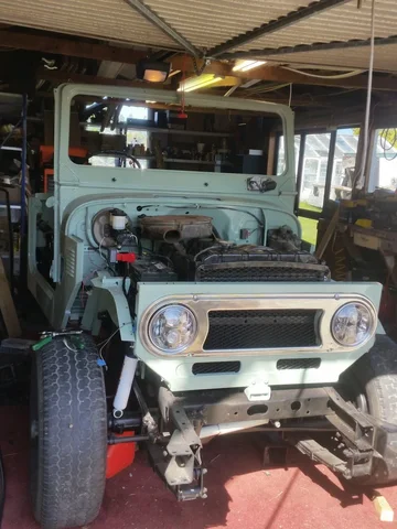

I have fitted the front inner guards but I can't finalise the fitment till the outer guards (they are fibreglass) and rocker panels are done so I did a bit of polishing and fitted my LED headlights. I am unsure whether to stick with the chrome bezel or fit a painted one.

Looking sweet the old girl,leave the chrome bling on her, and there looks to be plenty of head room only 100mm more and she has a roof on.

Where did you get the headlights from? Will they pass WOF inspection here?
They came from mudstuck but they don't have any more in stock. they do have "e" marking and the pattern is good and they were half the price of trucklites :)
Do they have an arrow pointed to the left in the glass to show they're designed for our roads where we drive on the left?

They are e marked and the dip pattern is correct but the don't have an arrow. View attachment 1156356 View attachment 1156357

I've been wondering for some time whether there were road-legal LED headlights out there for driving on the left and it looks like you've got some..
It would be good to hear back on what you think of their performance when you get back on the road..
