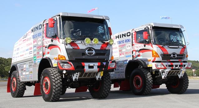

Their Dakar trucks are running 8.8 6cyl at 650 ps@2200rpm, way too big for a landcruiser but cool anyway.
Look for the Dakar tab at the top of their home page for detailed info
