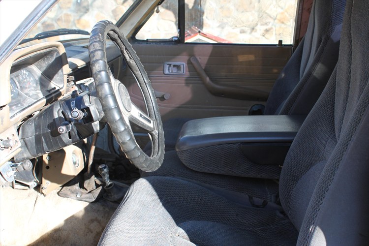

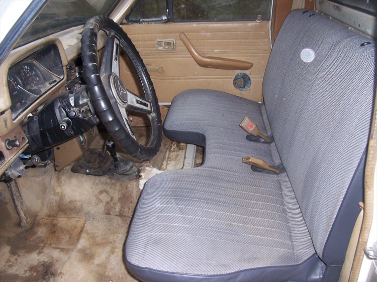

hi guys, i just traded for a 1981 hilux 4x4 and ive got some little things that i want to get straightened out, first it has the shifter slop (found the fix for this), the dash is kind of busted up, and the column is in TERRIBLE SHAPE! the question is... do any other vehicles columns swap? im guessing i might have some trouble finding a good one. any suggestions?

Pretty sure an FJ60 column is very similar to the late first-gen column.
The biggest probem is that there are I think 3 generations of column for the early RN trucks.
I say just run it as-is, clean up the switches as needed, and then just go with the scabbed column.
Your passengers will think you're a reaver.
How about a column from a Gen2 pickup or Gen1 4Runner. Might be close.
