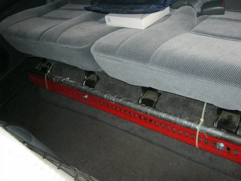

IMG_1014.webp IMG_1016.webp I like carrying the Hi- Lift inside and disassembled since it only takes minutes to reassemble. Found a good place to store my 48" bar in my 80 series. Bolt it to the front bolts on the middle seats. Tried the outside bolts first, but fits better as shown in pic. Just find some longer bolts. 1.5" - 2" works fine. I have an extension tube tie-wrapped to it to help with leverage on the handle if needed.
