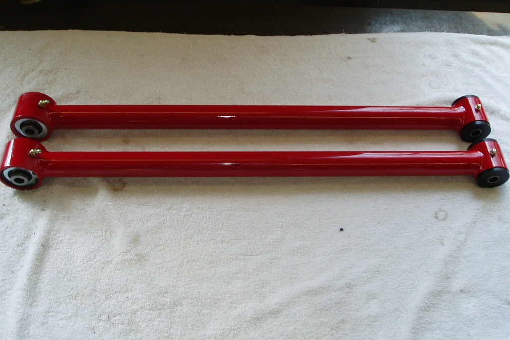

Sent out a set in Red on Monday, they were at Raushe Creek this weekend.
Yours are in the next batch Jon. :)

Recived the links the other day and mounted yesterday :wrench:
Links looks good, now i just need to go wheeling :steer:
