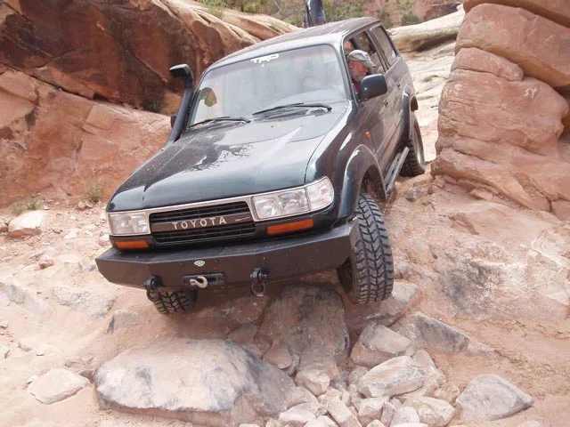

It takes a pretty big panbrake to bend 3/16 and quarter inch plate. A commercial shop would have that, a home shop guy would be welding I imagine.
That is correct. I couldn't find a local shop that was both willing and capable. The shop in question is Alabama. That is why I wanted to do a full-scale mockup to ensure that everything fit as I had imagined.
Ary
sleeoffroad said:
The side plates are part of the recover hooks and are 3/8". The wings are grade 80 3/16".
Opps, sorry... :doh: Come to think of it they do look thicker than 1/4.
I should have realized that as I bruised myself lifting the SOB........ :doh:
An interesting footnote to the Slee is the winchmout is off-set slightly to the right to clear the Warn 12K. Even with the RH off-set the low profile 8k Warn, which has the motor on the RH side, still fits nicely.
Just talked to the shop and he quoted me $200 to cut and bend up the 3 main pieces for me. This was in line with what I was thinking/hoping for, so the bumper is a go at this point. I need to discuss some further details with him, but hopefully I'll be sending him my design towards the end of this week.

Looks good. I have been mulling over roughly the same. Bending was approx $200 in NC as well. If would specify for the bend on top to be just shy of 90 degrees. That will allow for water to run off rather than sit there and lead to rust. Look forward to see it.

FZJ80kidpen, I would have the bumper bent to exactly the shape you want. How often do you park on a perfectly level surface? Also, as soon as you start moving the air flow will blow it dry. :)
