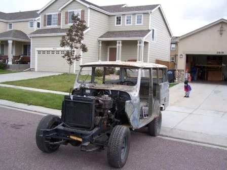

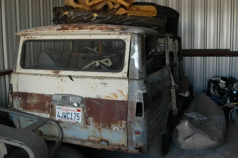

is that a 45 back part of the cab in the last pic?
Yeah....that last pic is the rear end of my 45LV. Thats the way it sat when I purchased it, with all the stuff inside and out! :) I had to turn the LV around in the street this week. WHAT A CHORE! My wife, Sophie drove the Tacoma, and pushed the LV right back up the driveway. It was quite cool how it worked out!

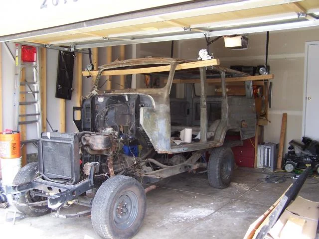

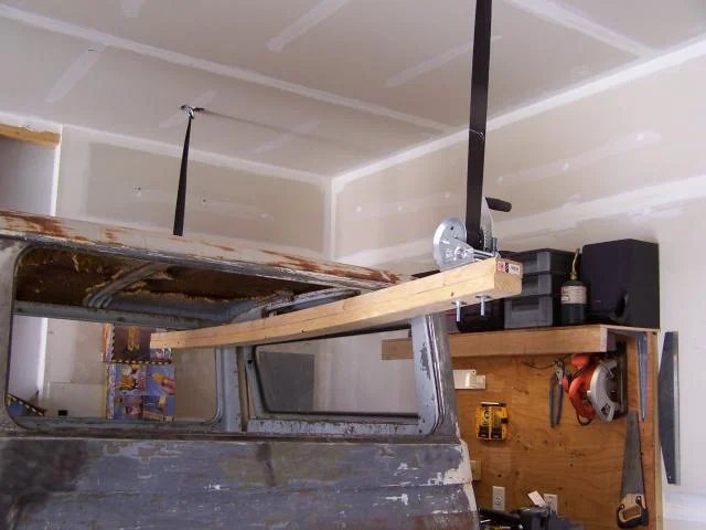

I made some real good progress this past week!! My Dad and a friend of mine helped to get the body off of the frame. Without a 'true' garage w/ a hoist...I made a poor-man's lift by using 4 -2x4x8' and 4 boat trailer winches. I routed the 2" winch straps up and over my garage roof's truss'. It worked out pretty well. Here's some pics of earlier this week's success.

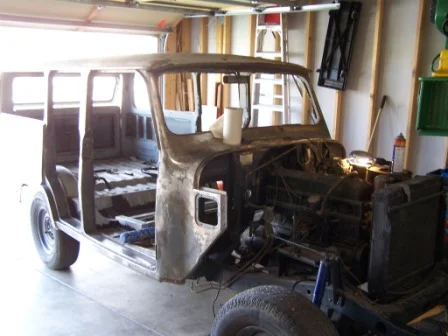

Still last Saturday...Now that we have the body off of the chassis, I was able to run to the E.R for some stiches :) Cut my finger really well in the morning, my wife (Registered Nurse) said I should go get it sutured up. Heck, I can't stop progress for some stupid stitches!!! Don't think I'll post pics of the wounded finger, but you can imagine it, I'm sure. Well, I'm all sewn up, ( 3 stitches) and worked on the truck, anyways :)
Monday, My wife operated the engine hoist, and I helped her take the running gear out of the frame. That was much easier with two people, and my wife was an awesome help! My Dad and I removed the axles off of the frame on Tuesday evening. I got the frame and axles cleaned up, and off to the sand blaster Wednesday, so hopefully they'll be done by mid-next week.

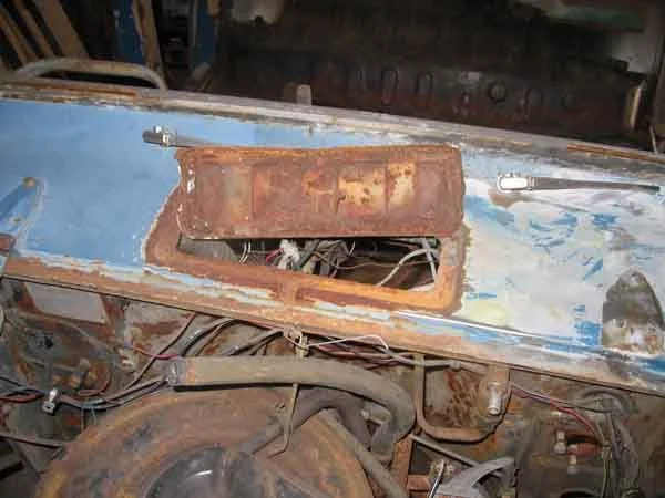

this is great another lv build up. in your spare parts do you have and extra air vent? I just need the door itself as seen below
thanks jason
