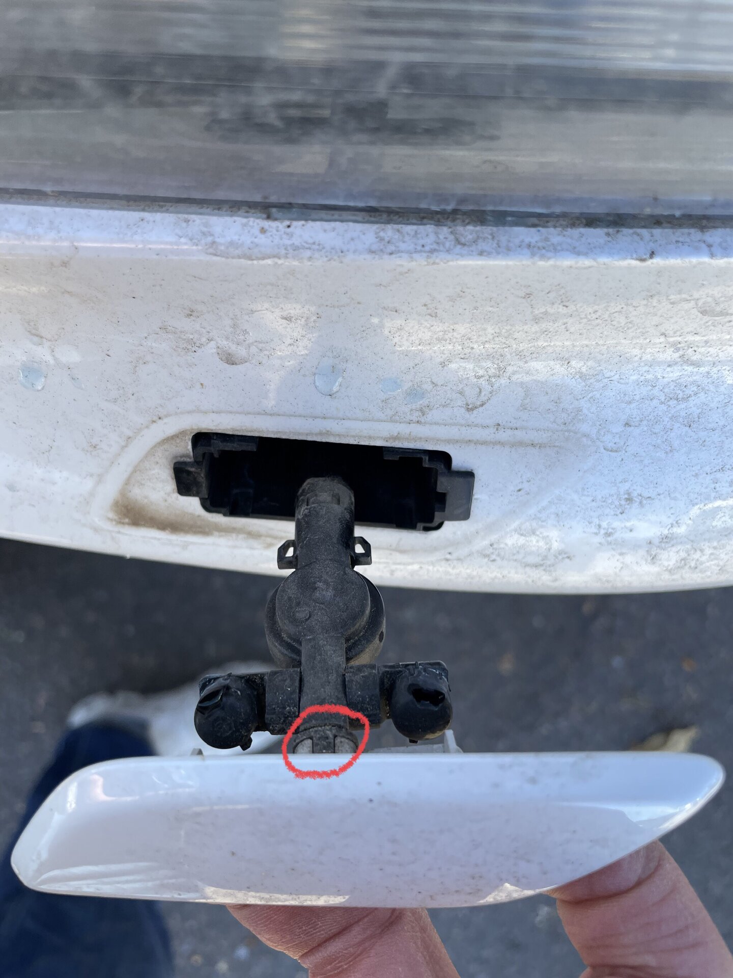

Can someone please help with a part # or a correct parts diagram. I’m looking for the part that is circled in the first photo. It attaches the cover to the washer assembly on a 2014 LX.

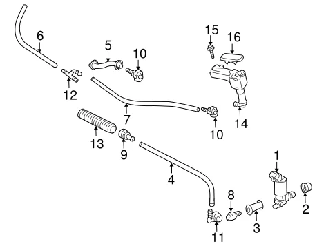

The parts diagram that I found online for the LX is not accurate. Part #16 in the diagram is the cover
You’d have to replace the entire telescoping assembly to get what is in the circle.
