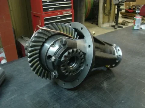

Got back to the build today. Here is the high pinion diff with Yukon 5.29s and ARB waiting its' turn.

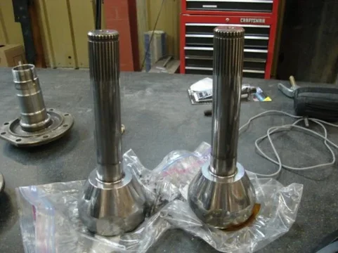

The new Longfields.

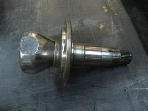

Here's the new Longfield next to the outer cv shaft on the IFS I'm running now. Yes it's broken...

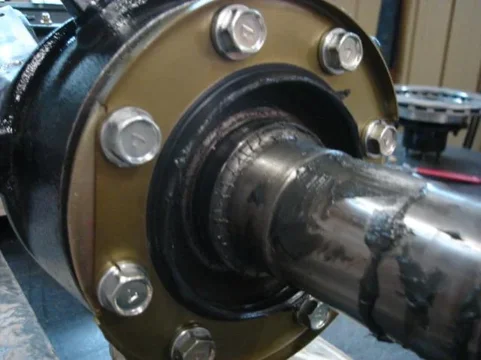

After the 3rd was in I drove the axles in with a deadblow. It helps to turn the drive flange on the diff back and forth to line up the splines.

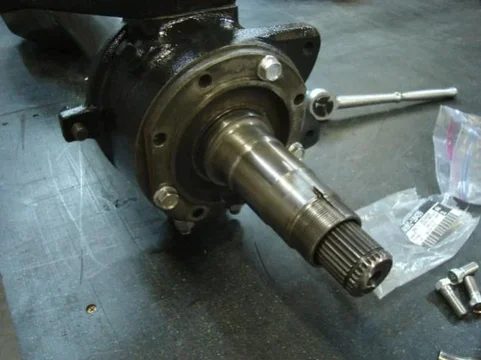

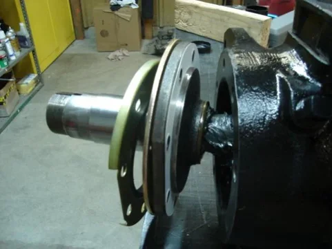

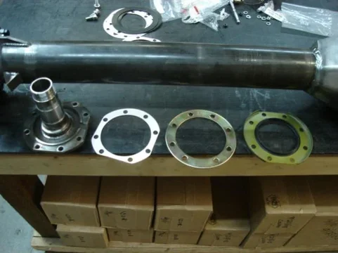

The spindles can be installed next. First the gasket, then spindle, dust shield or eliminator (pictured) and seal.
Here they are going on.

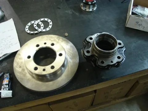

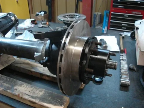

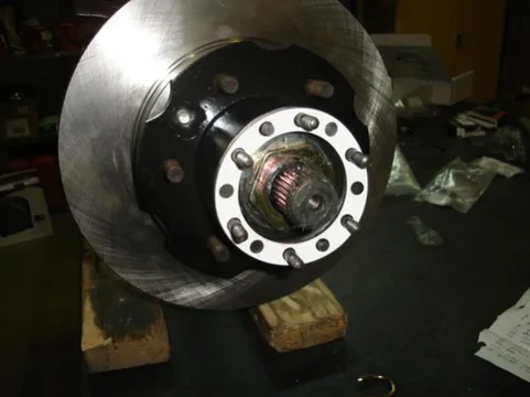

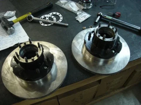

First step is to bolt the rotors to the hubs.
Next up, drive the wheel studs in. I used the brass drift and a bfh. You can also pull the studs in with the lug nuts and a spacer.
The hubs and rotors, ready to go.

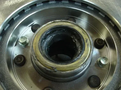

Pack the inner wheel bearings with grease.
Insert them into the back of the wheel hub. I had already changed the races, sorry no pics.

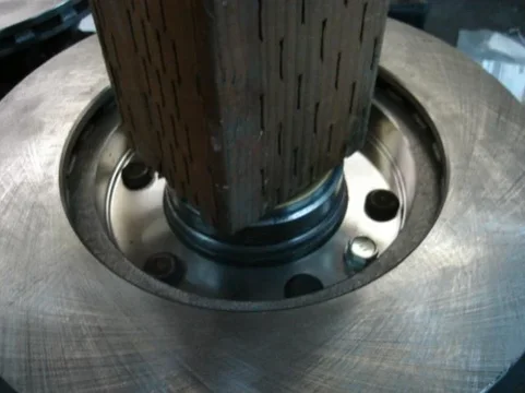

After the bearing is in the race, drive in a new hub seal. A 4x4 block of wood worked well for me.

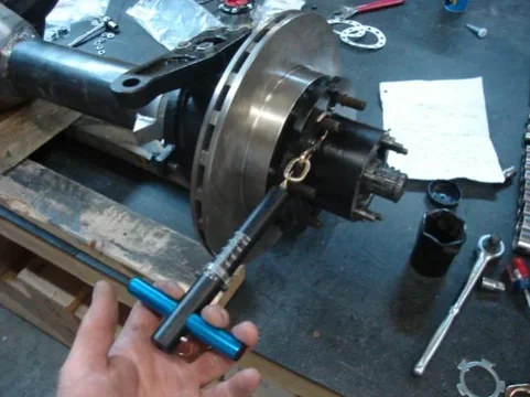

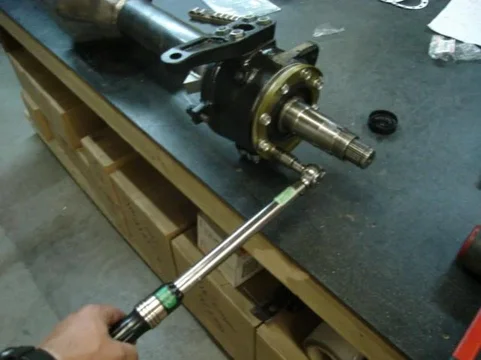

I used a method I read about online. I torqued the spindle nut to 43 ft/lbs and then spun the hub forward and backward about five times each. After every set of spins I would re-torque the spindle nut. Afer about three cycles, I loosened the spindle nut and re-torqued again, this time to 23 ft/lbs. This should give you a preload between 3 and 8 lbs.
I measured the preload from a wheel stud. Again using the pull scale I got a preload pull of just over 8lbs. I called it good as I want to be on the higher end of tolerance for large tires.

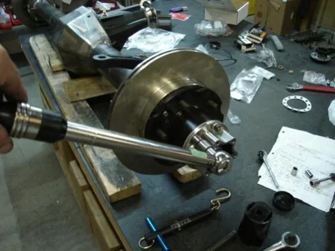

After the preload was set I installed the star washer and another spindle nut. I torqued this nut to 23 ft/lbs as well and then folded the star washer tabs either way to lock the two nuts together.

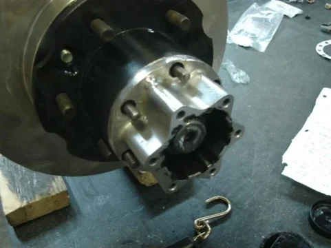

It's time for the aisin hubs. First up the gasket.
Followed by the hub body.
