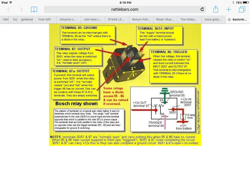

This is the best relay wiring diagram/instructions I've found... Very intuitive... Completely self-explanatory.
Be sure to:
  • use the small BY to trigger (86) the relay.
  • Tape off the large BY... My '78 has the large pink Yazaki resistor, spliced into the large BY... Not needed for DUI, because your DUI requires the full battery voltage.
  • Use a sufficiently sized wire for the relay output (87)... I used 10ga.
  • Use a sufficiently sized wire for the battery input (30/51) and FUSE IT.
  • Properly ground (85) the relay.
  • 87a is NOT used... Not all relays have 87a anyway.
  • Done.

Thanks! I spent all afternoon fixing things up with the relay and wiring.
I used the large BY wire because I don't have the resistor, but I wouldn't think it matters whether you use the primary or bypass wire to trigger the relay, even if it's resisted. Would it?
I might do a writeup for other noobs interested in this mod, with easy to follow instructions and pictures all compiled in one thread.
The large BY and the small BY are tied together, so electrically they are identical. You can use the small BY to trigger the relay with no issues.

I see Mark responded... yes, either BY can be used to trigger the relay.
