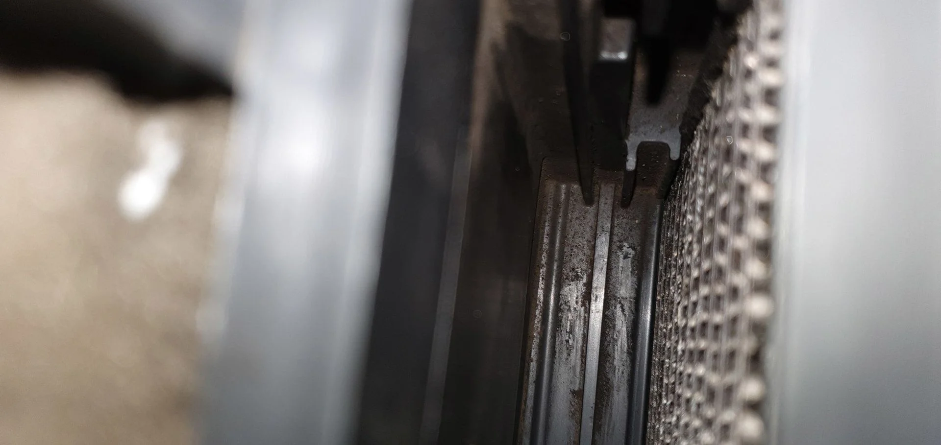

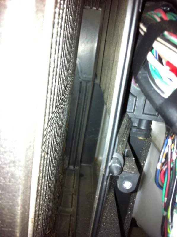

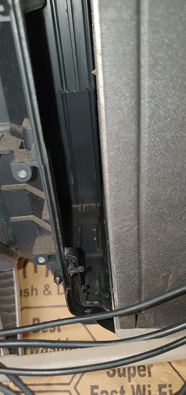

Buck, i already did, my first tought was, something is blocking, but after i checked inside, nothing blocked the way.
its look like the filter reach the end of the housing.
i attach some pictures of it.

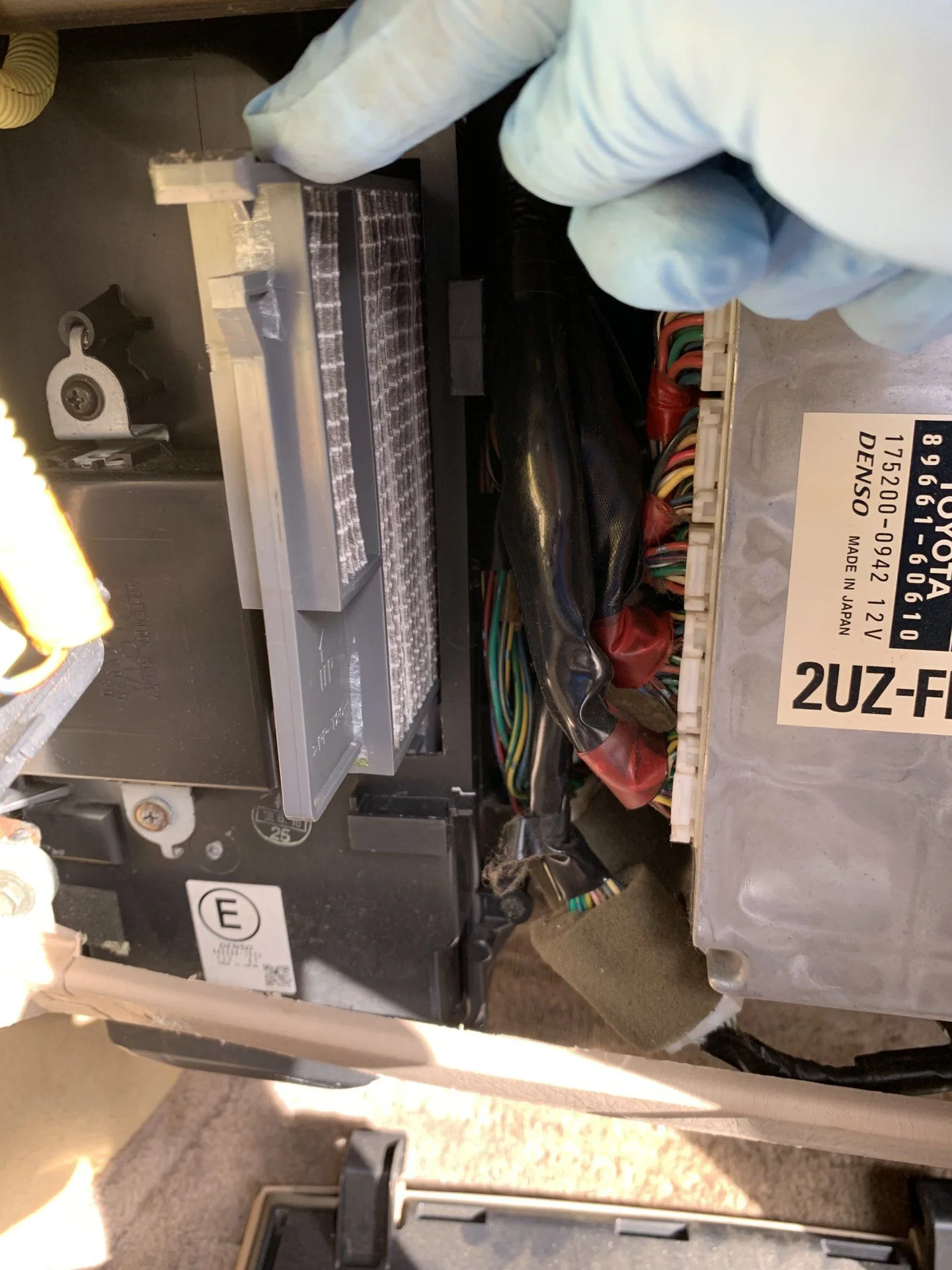

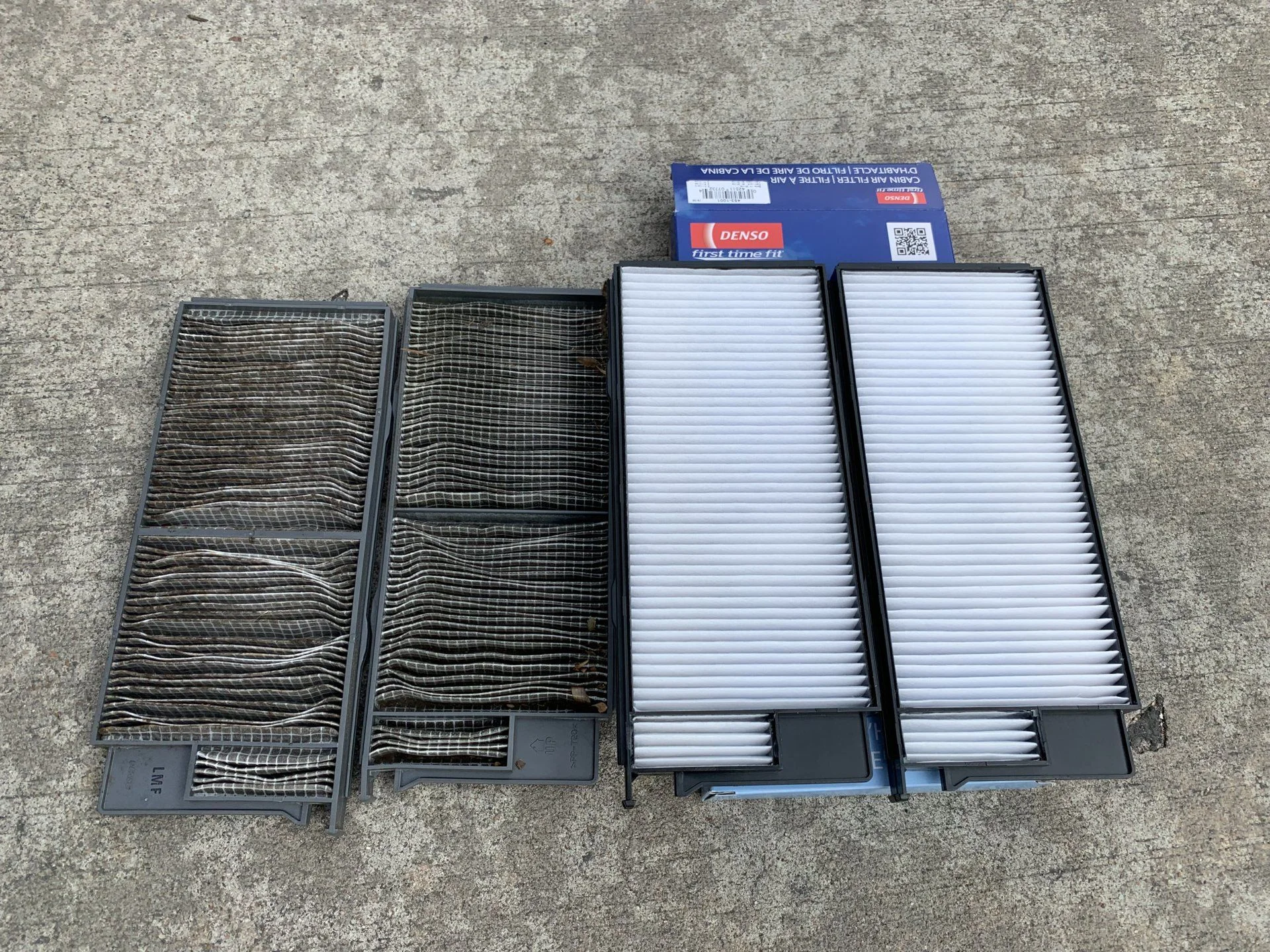

I changed mine last month with Denso units. I don’t think the filter was ever changed.

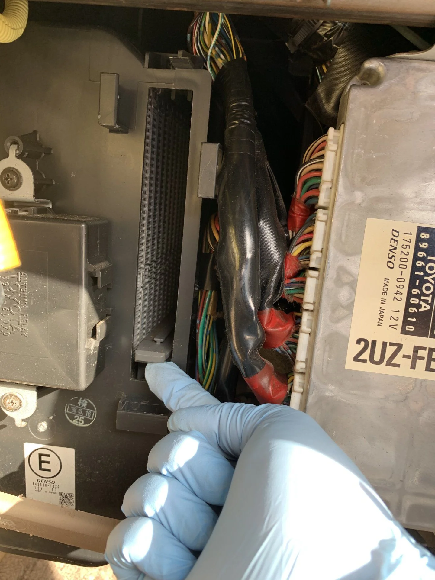

Took a few pics maybe that will help.
1970512
1970513
1970514
1970515

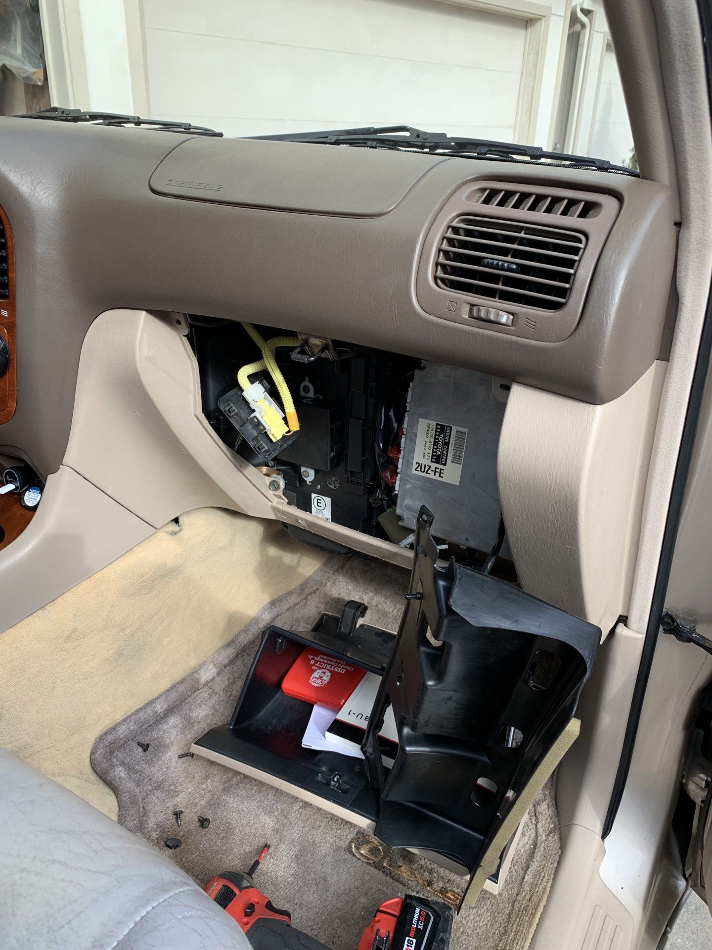

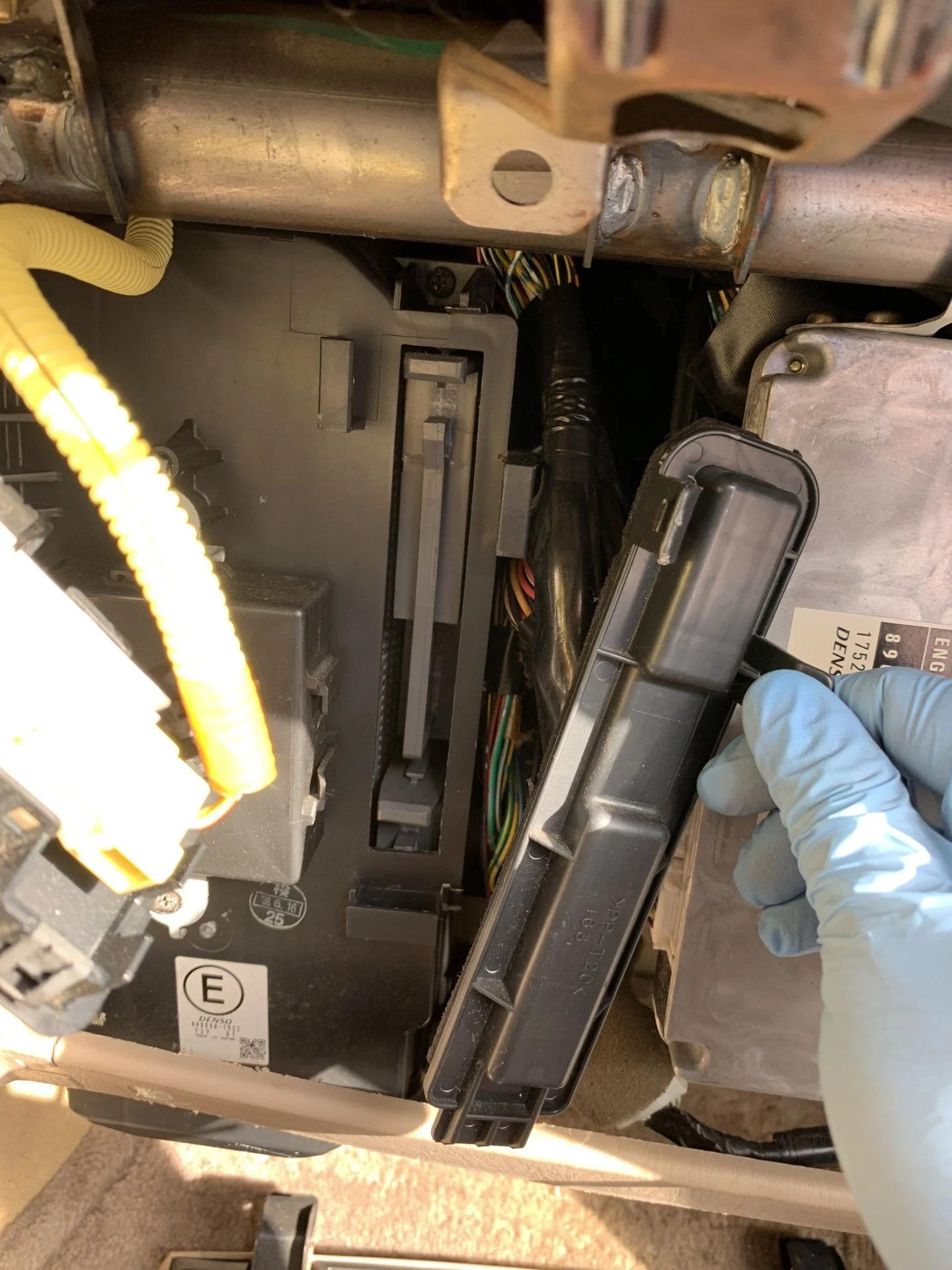

Op, your layout doesn't seem to match the layout seen in mudbutt's pictures. Mind posting a picture with a wider view of the glovebox area?

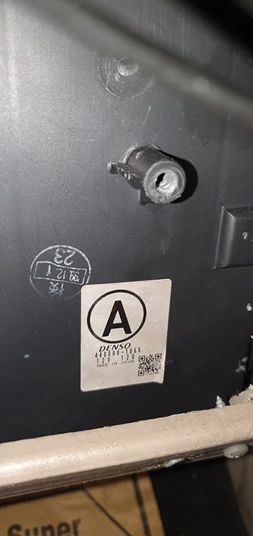

mine is RHD Lc.
but i notice, the marking on the cover is different, mine is "A", while on mudbutt's picture is an "E"
does it make any difference?

OP, can you back up the camera and take some photos of the complete area under your glovebox?

already bought this filter (88568-60010) and try to fit in, but it only goes Half way.
View attachment 1970457View attachment 1970458View attachment 1970459
i don't think the paper filter is the original filter.
200 cabin filter is bigger than the paper filter above.

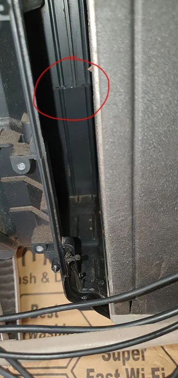

Strange. Your slot looks like there's something blocking it halfway. See pic, the circled area does not look very factory to me. Could it be somebody jammed something in there and then put in those paper filters that you took out?
This is what it should look like:

Just for reference, here’s a pic of the area
i will post the pictures soon.
i did push and pull the end of it, as i'm curios wether it is stuck or something, but its look like they made like that.
i'm curios is that label "E" and "A" make the difference?
